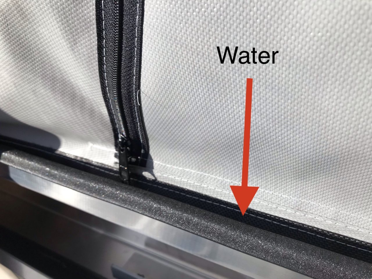

    Condensation
    Yes, we did get more condensation when using the Mr Buddy. But, it was manageable. This is partly because of the brilliant tent design that keeps water that drops off the tent in a drain at the edge of the frame. It keeps water from dropping on you in the morning. I certainly plan to install a Propex in the next year. (Phil told us they are looking into figuring out an install location in the rear passenger bed side near the inverter cubby and tailgate.) But until then, the setup works quite well below freezing.

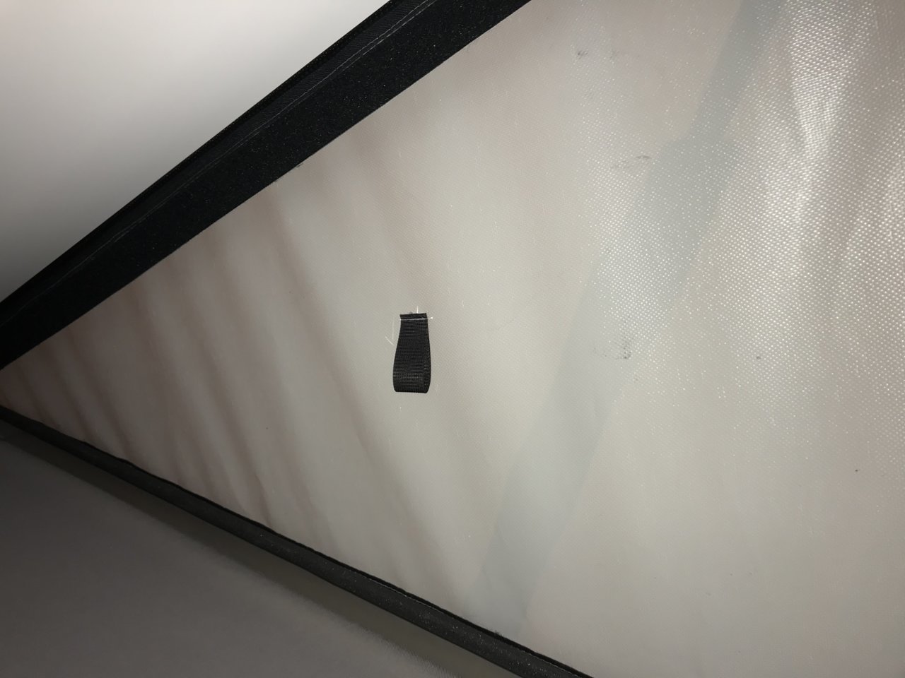

    Can anyone help figure out what this is? Do you attach a bungee to pull the tent in? Does anyone use it?

    If I recall correctly, Jay had mentioned that yes, you could use those to attach a bungee to for easier folding, as well as one in the window area (on the hook loop). I had something very similar in my FWC and used them. However, I've found it easier with the Drifter to simply manually push the sides in, the way Jay likely showed you during install.

    Yup, what he said :thumbsup:

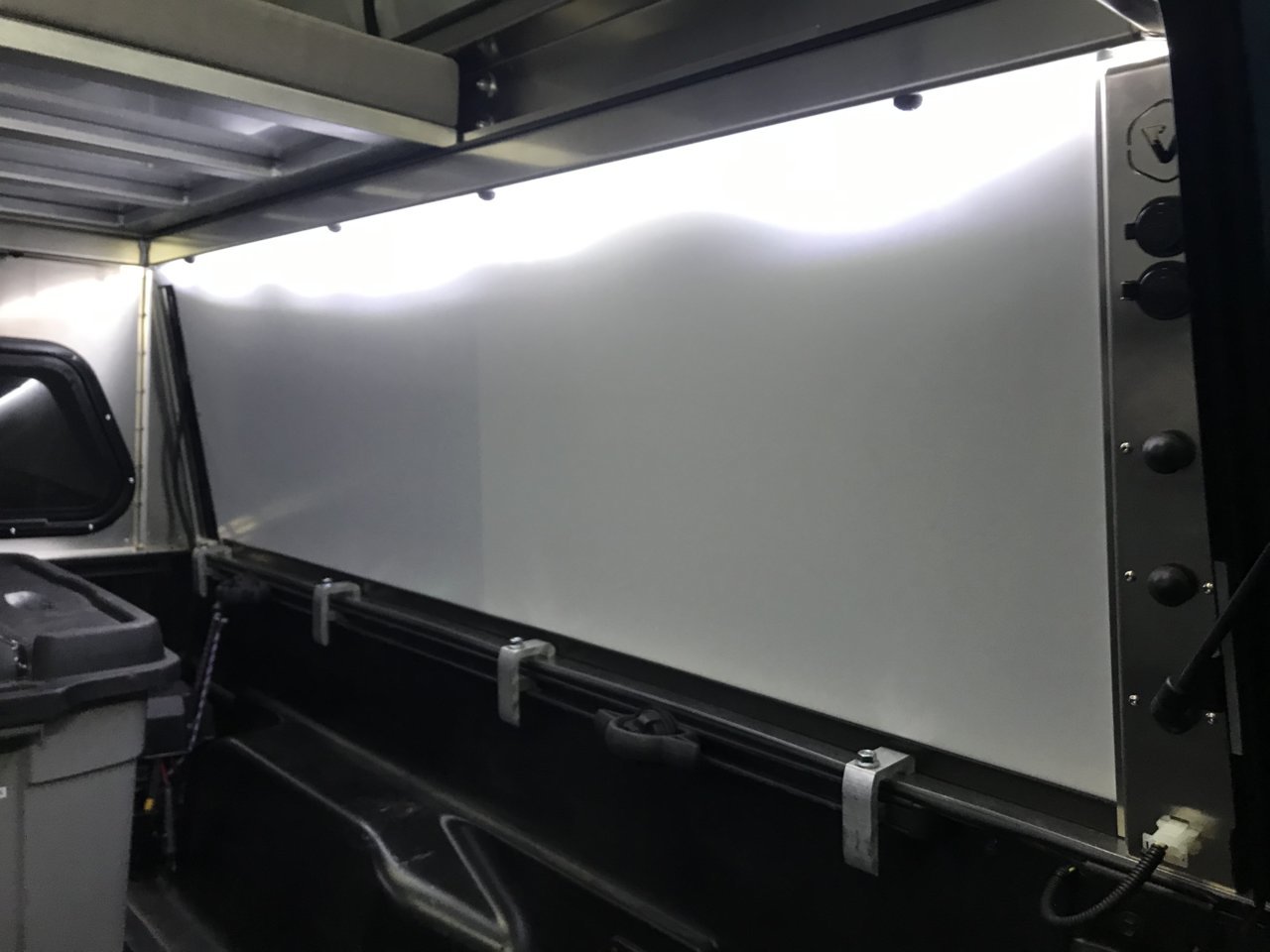

    Drifter Lights V2 Review
    I wanted to post some thoughts on the new Drifter lighting package that came standard with my January install.
    First, the dials are conveniently located at the rear of the Drifter. My only complaint about the dials is that they don’t have a “click” when they are off. I have accidentally left a light on low during the day because I didn’t realized I had not turned the dial far enough. Pushing the dial switches the light between white and orange. Power usage is the same in either mode. A dual USB as well as a 12v outlet are also included in the power panel.
    Here is what the orange lighting looks like.
    I found the light to be appropriate for each situation. The side light is diffuse because it is reflected off the side of the Drifter. This mode uses the most power (see table below), which was a surprise to me. It uses almost 3x the power of the two other combined. Who knew.
    The top light provides adequate light for the bed area.
    The rear light is the ideal light to illuminate the bed when grabbing an item. This is the smallest of the lights and unsurprisingly, uses the least power. It allows visibility to the front window.

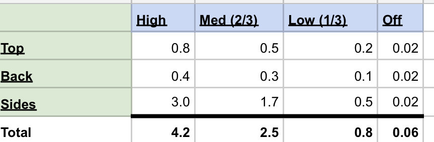

    How much power do they use? I found that they consume just over 4A when all turned on. What is a bit annoying is the even completely turned off, the lighting package (and perhaps the fan) consume .05A. With a 50Ah battery, this means it will run for 1000 hours or about 40 days before completely draining my battery. Ok, I should be using and charging the battery at least once a month, but maintaining my LiFePO4 at 50% will require weekly attention. I want to maximize battery lifespan and it will be difficult to do with the stock Drifter electrical accessories. I recommend a master power off switch to keep this from happening. I have this planned, but wanted to use the system before installing my final electrical setup.
