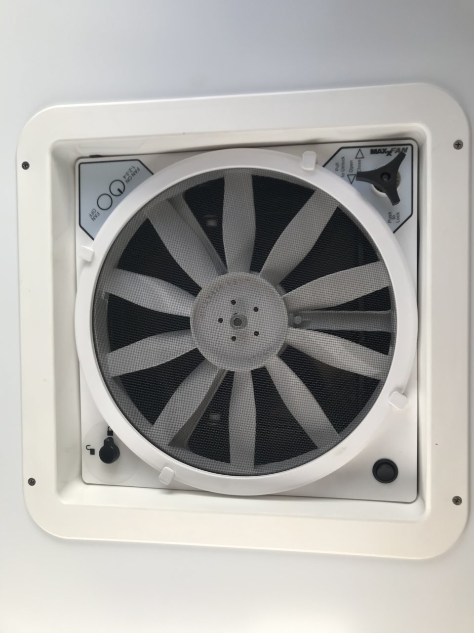

    MaxxFan Mini-Review
    We had an opportunity to use the v2 fan this weekend, and I thought I would post some thoughts. I can’t really compare the MaxxFan to the Fantastic fan because I have only seen the Fantastic fan on other units. My initial thoughts were that the MaxxFan looks to be great on features but a little less finished.

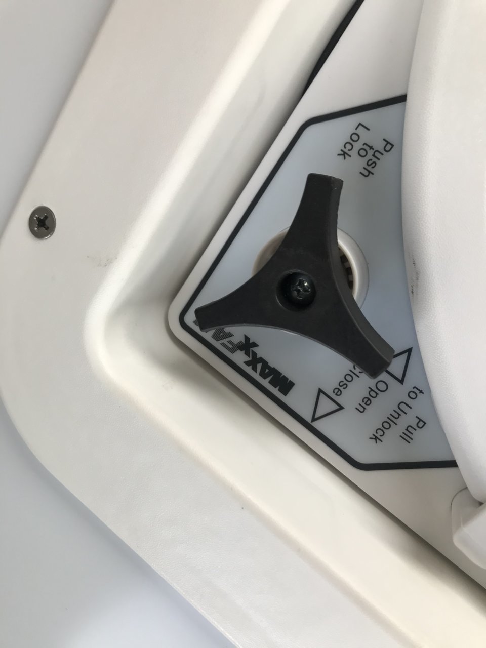

    The biggest thing I like about the MaxxFan is that it locks in place for transit. After cranking down the vent, you can turn the dial and lock the vent down. I understand from Phil that this feature is available because this fan is use on the A-Liner campers that have the fan in the backwards orientation to airflow when driving.
    The vent knob.

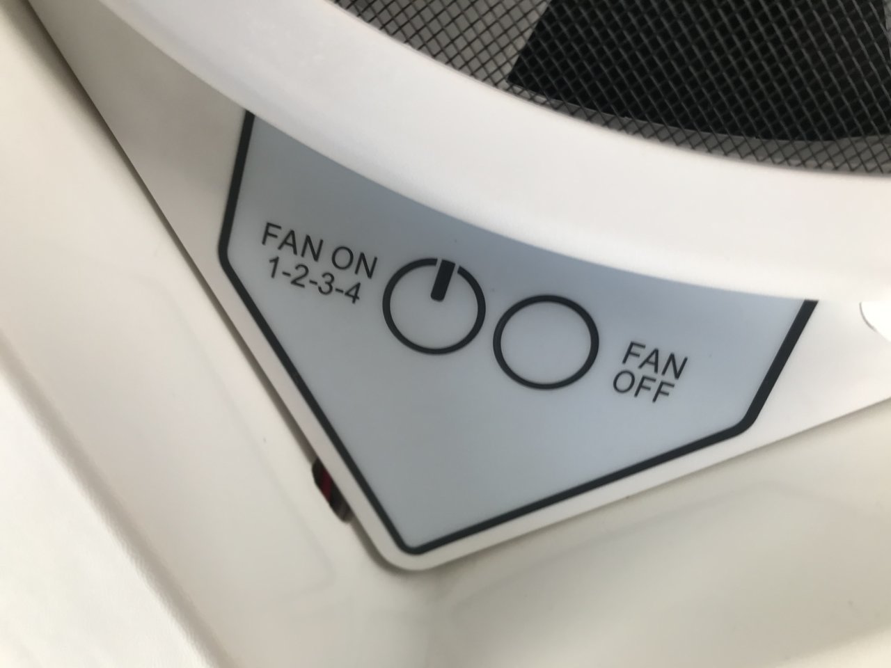

    Another feature I like is the ability to adjust the speed of the fan separately from on/off. Some fans require you to cycle through all the speeds in order to turn the unit off. One issue I have had is that the fan stops on level 1. This is a major disappointment because level 1 is also the quietist setting. I have pulled the screen away from the fan and still have the issue. Has anyone else run into this issue?

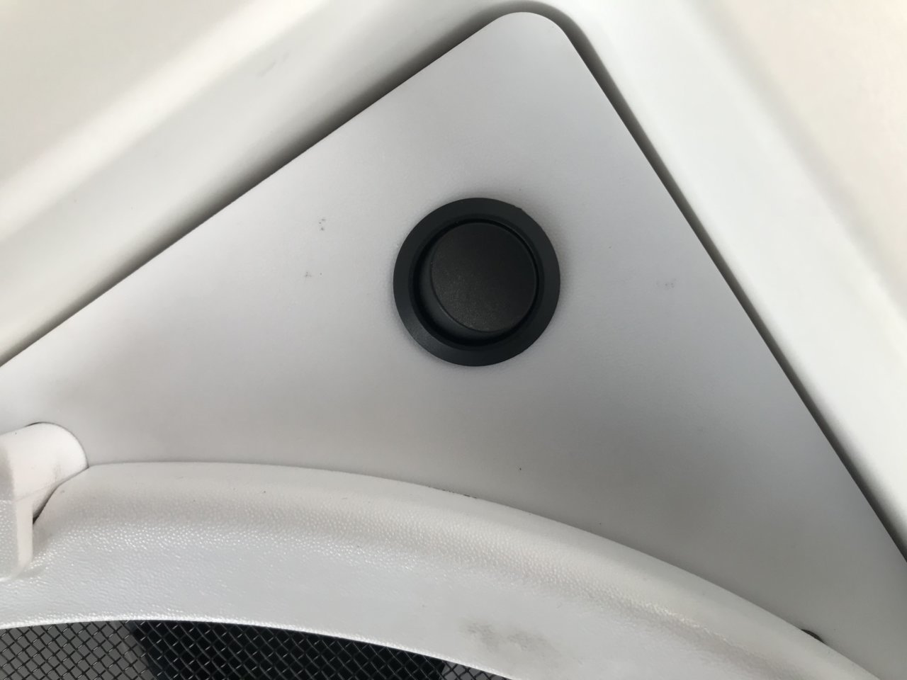

    The final feature I like about the fan is that it has a reverse switch. This rocker allows you to have inflow, off, outflow. I understand VO hand wires this switch to get the multi-directional fan. Kudos!

    I wanted to post a quick update on the fan. I followed Chris’s recommendation from VO and removed the fan using a small Allen wrench. I then reseated the fan, but allowed another 16th” of clearance between the fan and the motor. I ran the fan for a couple of hours last night and it never shut down. I think this might have resolved the issue. The fan still wobbles as it spins, but perhaps this is part of the design.

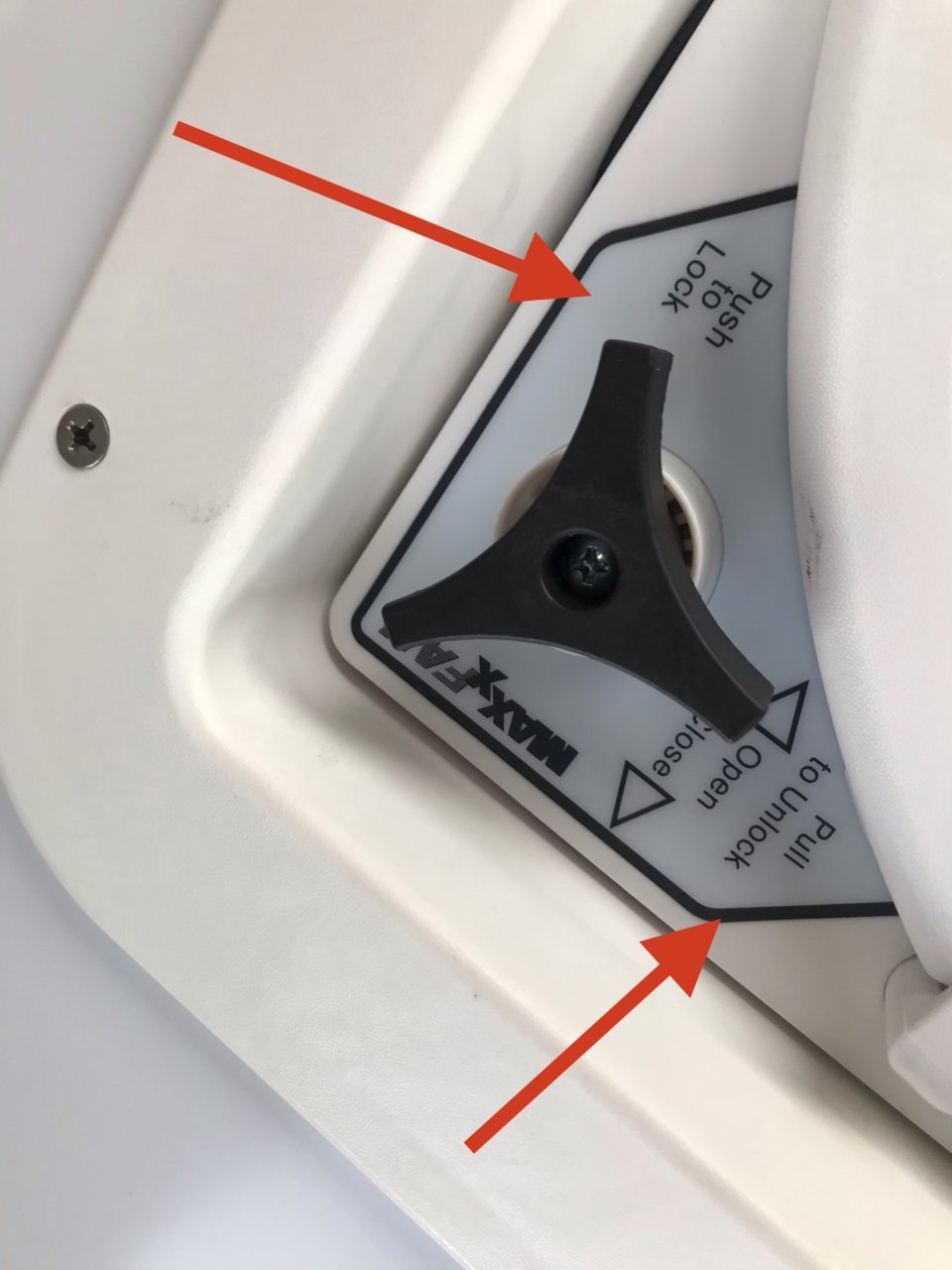

    I will also mention that one of the knobs on the fan appears to be mislabeled from MaxxFan. It references pulling the knob to unlock the vent and pushing it to lock the vent. A separate knob is now used for locking the vent, so this text is now inaccurate.
    An additional note is that I have measured the power consumption that the fan takes. These readings are listed below by fan setting:
    Level 4 - 3.0 Ah
    Level 3 - 1.5 Ah
    Level 2 - .65 Ah
    Level 1 - .23 Ah
