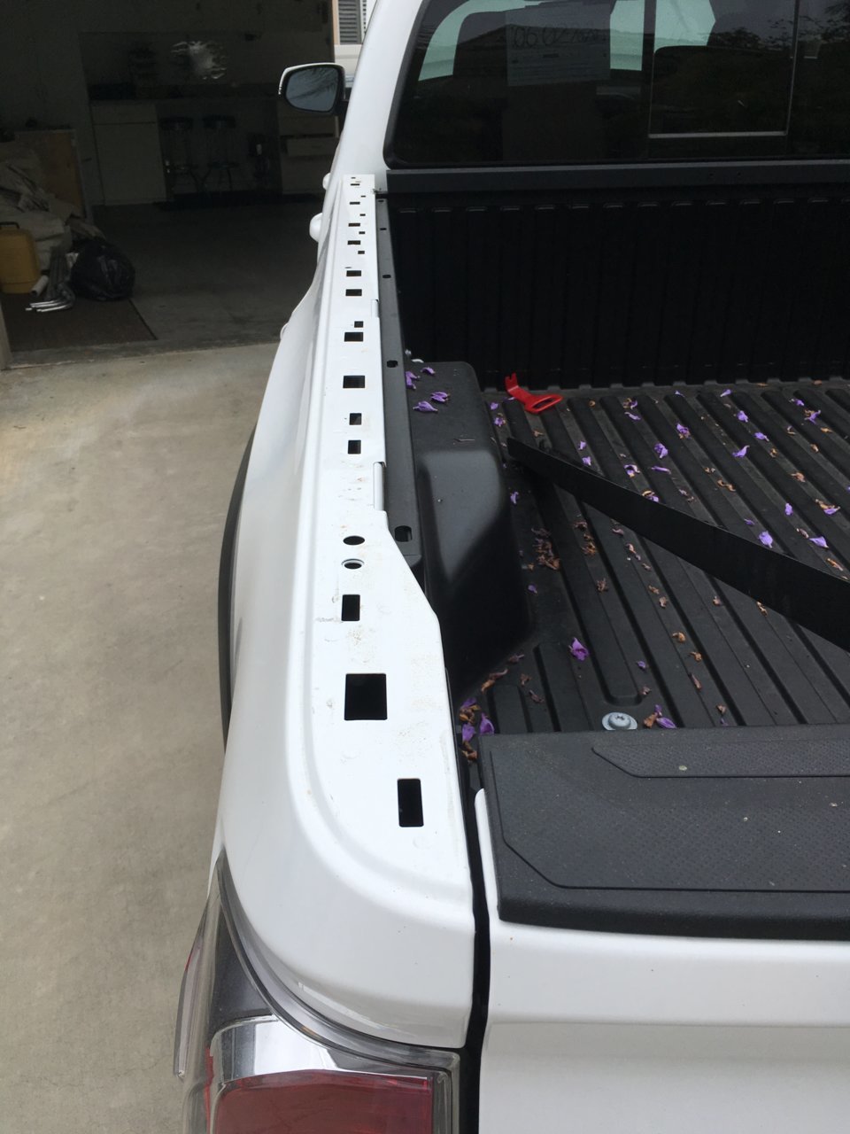

    Has anyone bolted the camper straight to the bed?

    If you saw what was under the factory bed rails you would understand why no one has done this yet. Even with the metal bed rail caps, I wouldnt suggest this move.

    I removed mine and sealed them in prep for the drifter and it looks like it could be done by inserting revnuts and caping the top with metal bed caps.

    Maybe if you had backing plates. I wouldn’t trust the entire weight of the camper shell to a few rivnuts. Imagine side loading your camper shell around a corner or an off camber position with a sudden lurch. Those rails are far to flimsy for anything but something light weight. The camper shell clamps attach to the bed rail system and a very secure. So secure, they kept a camper shell on a 3rd gen after it rolled.

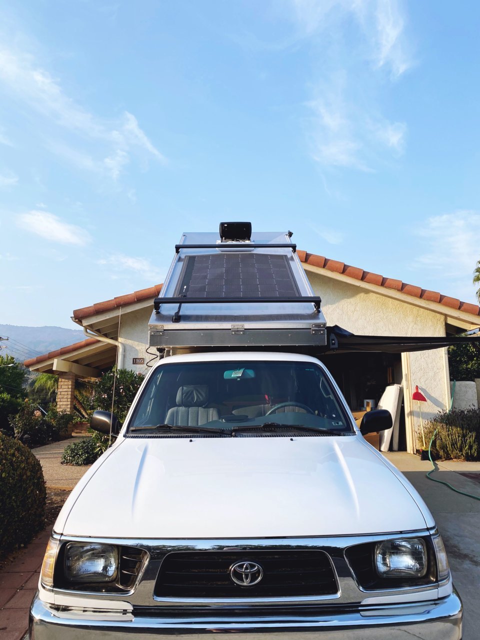

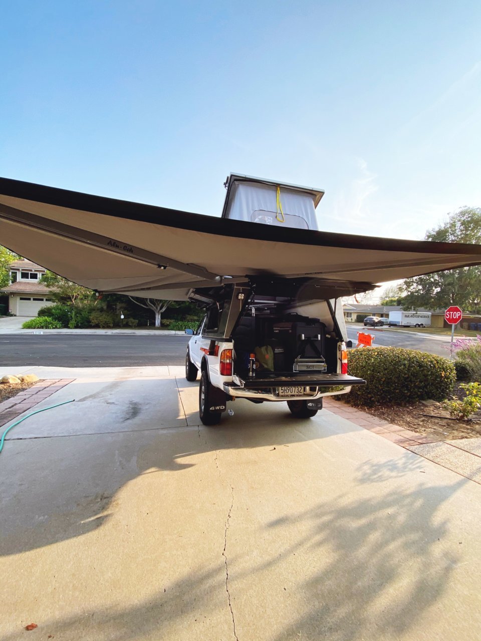

    Hi everyone- Order #129 here. I picked up my Drifter last Monday! We were excited, to say the least. Phil and Chris were great and installed my Goose Gear baseplate and Rago bed stiffeners (I had discussed this with them ahead of time). The Drifter turned out exactly as we had hoped. One of the downsides of the wait was that we kept adding on additional items to our order so by the end of it, I think we had every option except the powder coating. We had designed the internal buildout so we when got the Drifter home, it was mostly plug and play. Let me know if you have any questions, but I thought everyone would appreciate seeing some progress.

    Beautiful!! What pump is that you are using?

    Thanks! The water setup is a 16-gallon tank that I got from Amazon, connected to a Shurflo (12V 3.0gpm) pump that is then connected to the Guzzleh20 Stealth water filtration system.

    Beautiful, what solar setup did you go with? Size looks like a perfect fit.
