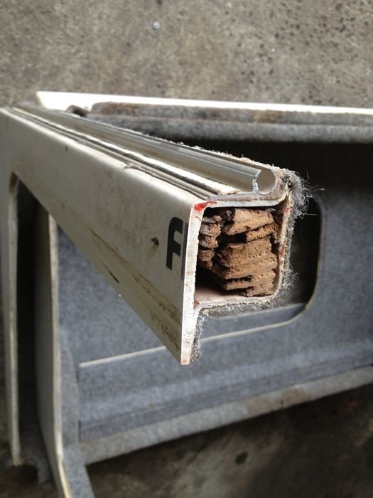

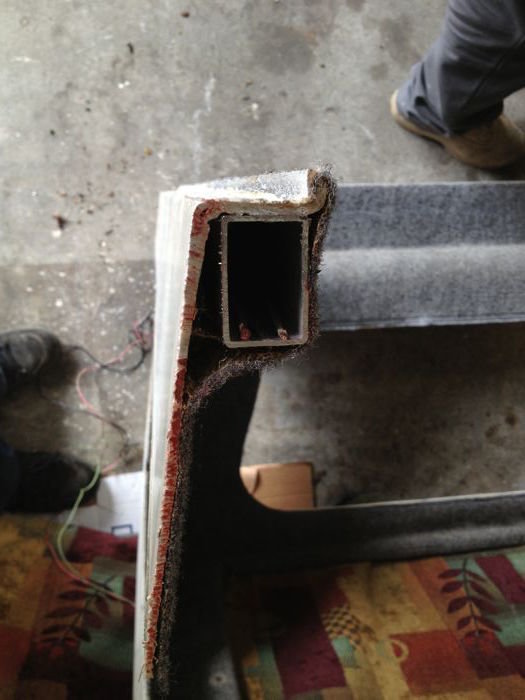

    As to hanging it from the ceiling, I had a Flippac that had been hung from the ceiling by a previous owner, and it had spread apart from its own weight. Not sure this would happen with the Drifter, but also not sure why it wouldn't. As I see it the sides are firmly clamped to the truck bed when in use, so the clamped bed is helping to prevent it from spreading. If the sides weren't fixed to anything and were suspended on hooks or straps for any length of time, I'd think the weight would spread the sides. Anybody have any thoughts on this?

    You can't compare the boat construction of the Flippac to bent and welded 1/8" aluminum sheets.
    The Flippac uses untreated wood, corrugated cardboard, mild steel that rusts… and so on wrapped in Fiberglass.

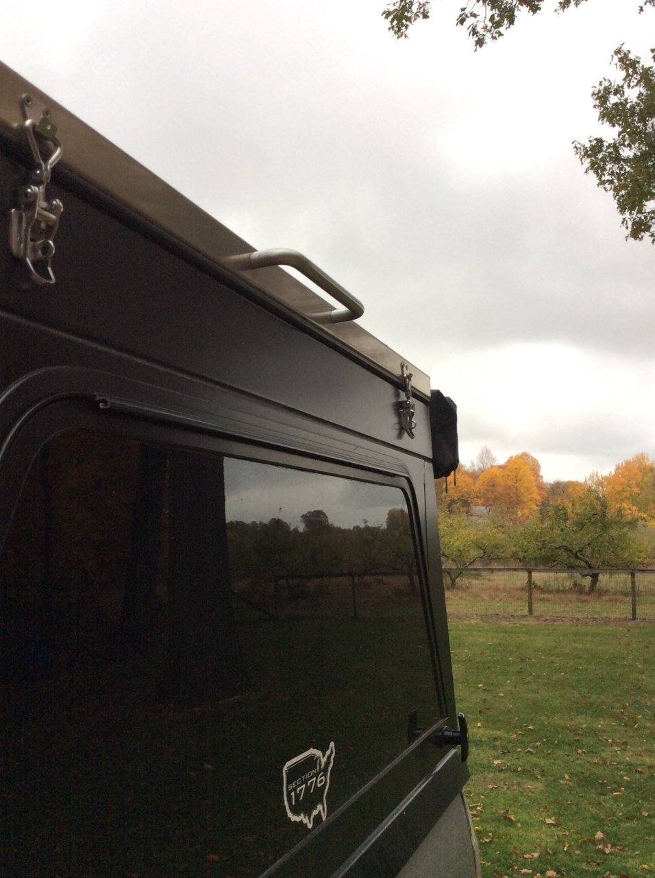

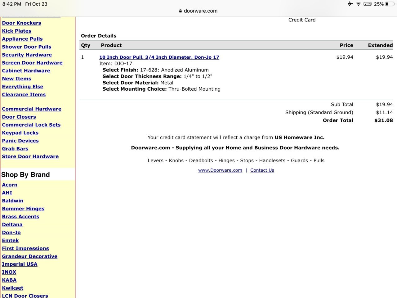

    I bought the cheap plastic one, but did not even attempt to install it. I then found this one for 6x (with shipping) the price. However, I am that much more pleased with it.
    If I recall, they have colors...but my memory is waning.
    Its quite robust and looks like it was made for it.
