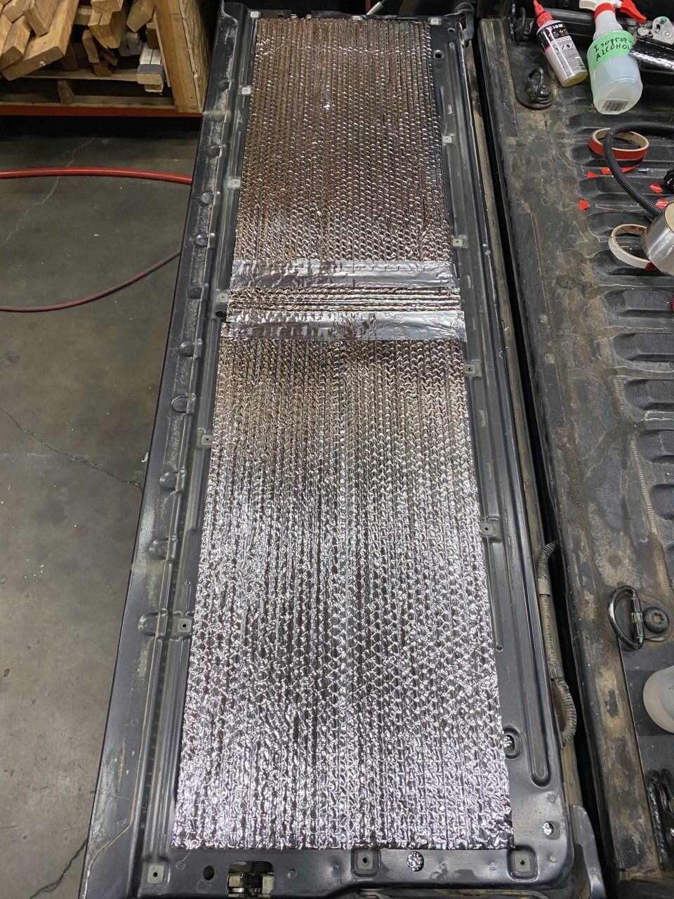

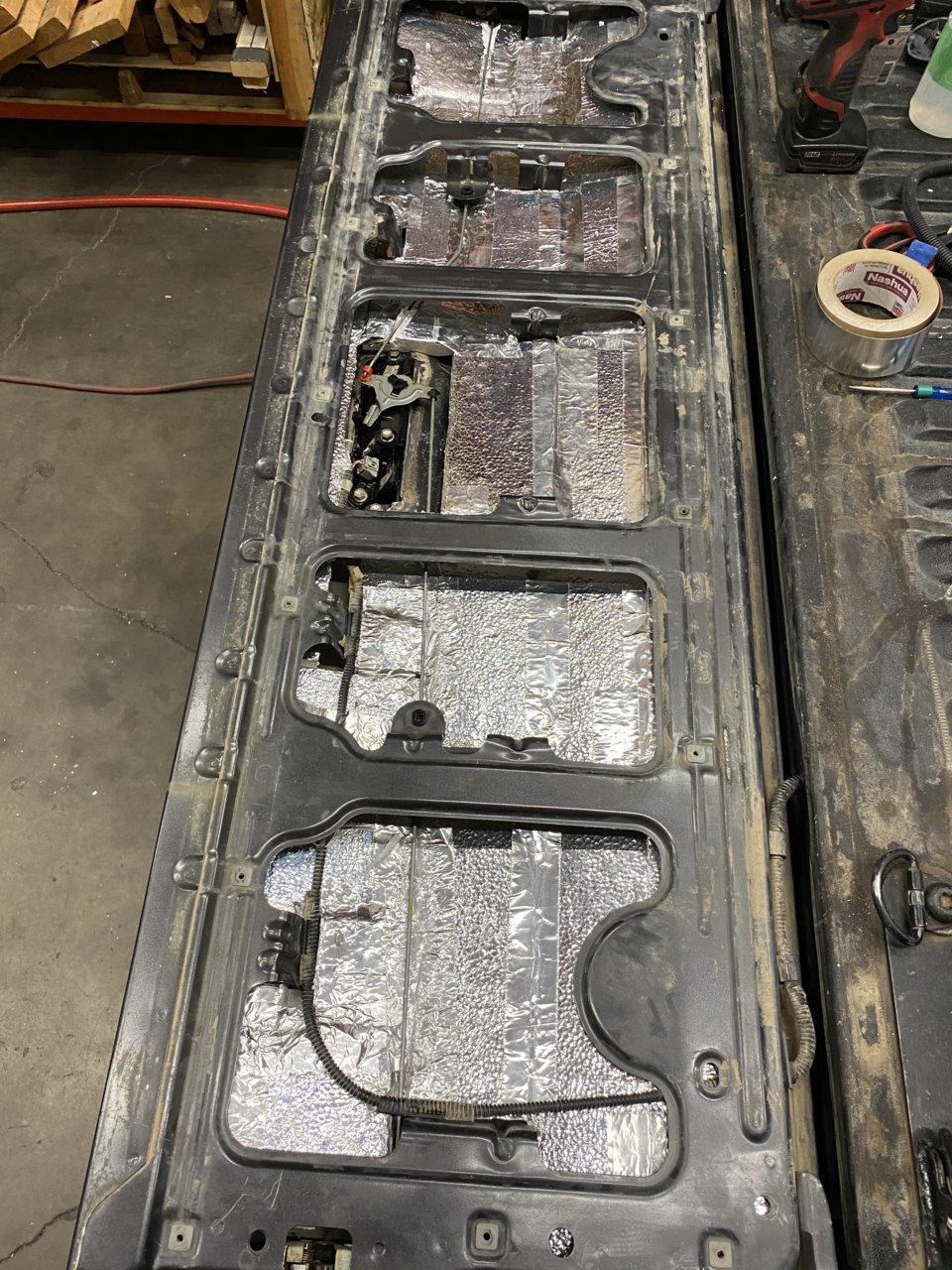

    I mounted a 10 lb propane tank on my Tundra tailgate. I didn't like the way it flexed with the tank so I used two cans of the minimally expanding foam insulation inside the tailgate. I left one of the weep holes open in the center and only went a little higher than the cross-brace so as not to interfere with the linkage and camera wiring. It barely added any weight and now my tailgate sheet metal doesn't flex. If you are looking to add insulation to your tailgate that doesn't take up space, I would highly recommend this but you have to be EXTREMELY CAREFUL or you will wind up with a mess. You need to do it in phases so it doesn't bow your tailgate and you should know it cures over the coarse of several hours and insulation will "grow" out of any holes. So you need to protect any surfaces around the holes. I recommend just taking the tailgate off to do it.

    cool idea! i went the lazy route and stuffed as much 1" foam insulation into mine and a layer of Reflectix lol. makes quite a difference thermally but wont help with flex the way your idea does.
