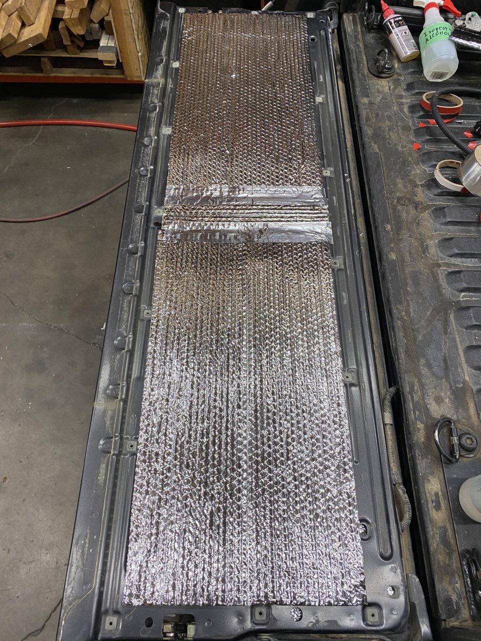

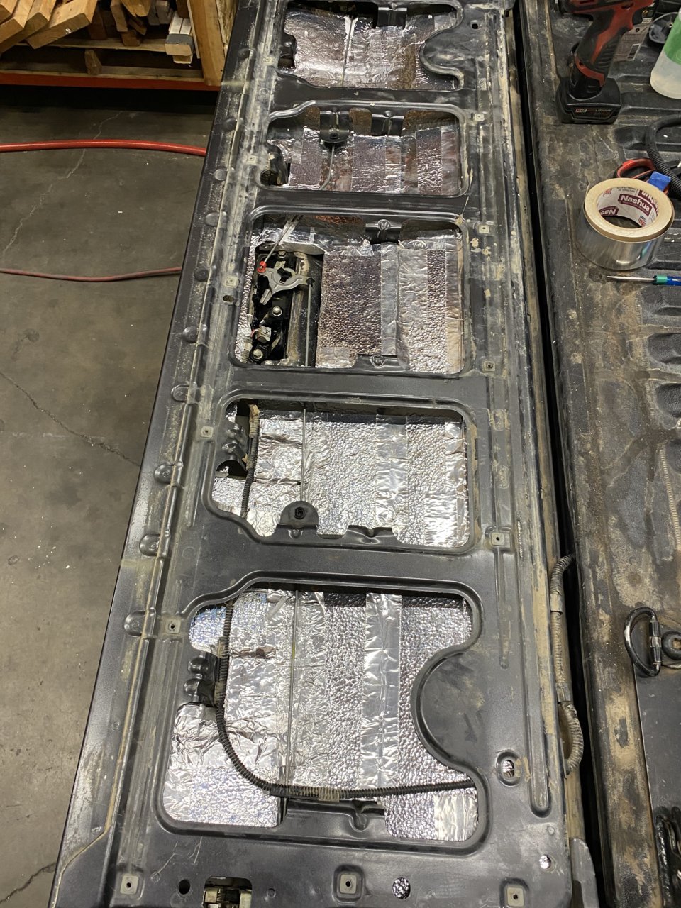

    I insulated mine because my fridge is up against the tailgate and on summer desert trips with the sun beating on the back of the truck my fridge was struggling to keep up with the heat radiating off the tailgate. I used a combination of 1" foam insulation and Reflectix and it makes a massive difference under those conditions. Not sure how much difference it will make in the cold but it's a cheap, easy and worthwhile mod in my opinion

    This is the post that made me think of it so thank you for sharing this. Yea seems really easy and if I'm insulating everywhere else then figure this is a quick fix.
