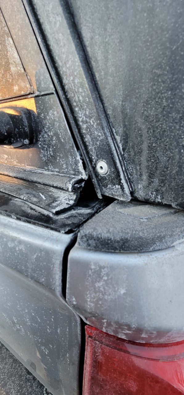

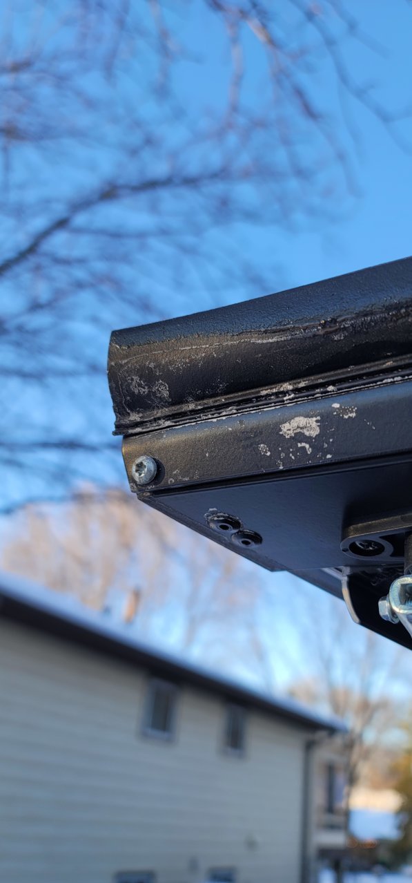

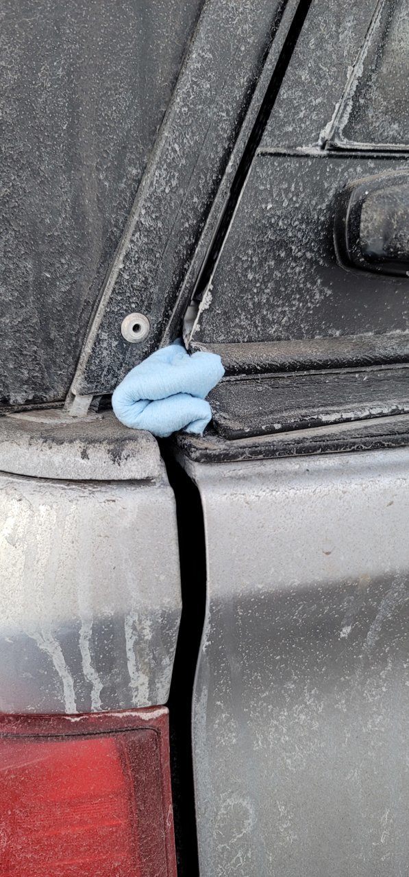

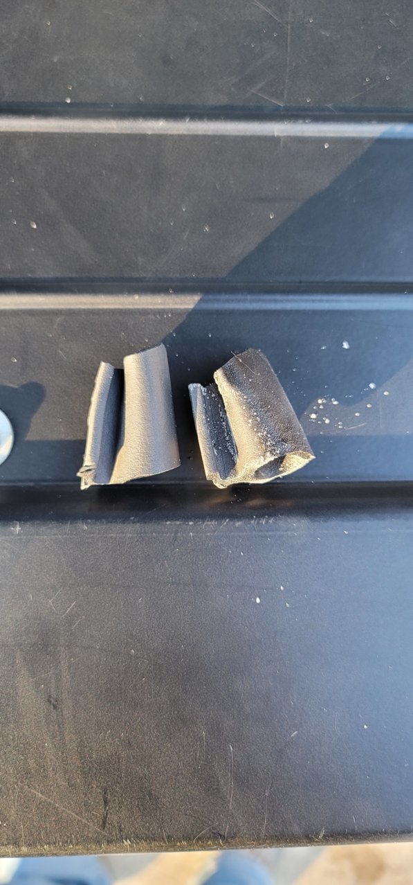

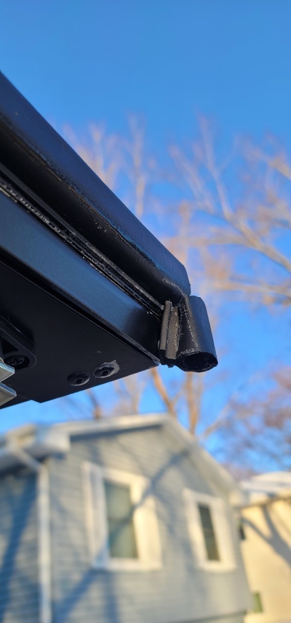

    So the end seals on the hatch lasted one month in the Minnesota weather and fell off. There was a hole on each end to begin with now its even bigger. I tacked the rubber back on so you can see where it goes.
    I plugged the holes with shop towels so that salt and water doesnt get in there for now.
    I think I can replace the long rear seal and cut it such that it extends all the way out on each end. Does anyone have a part number for the seal that VO uses? (The truck was washed on Friday)

    I took these off permanently because I wasn’t sure they did anything.

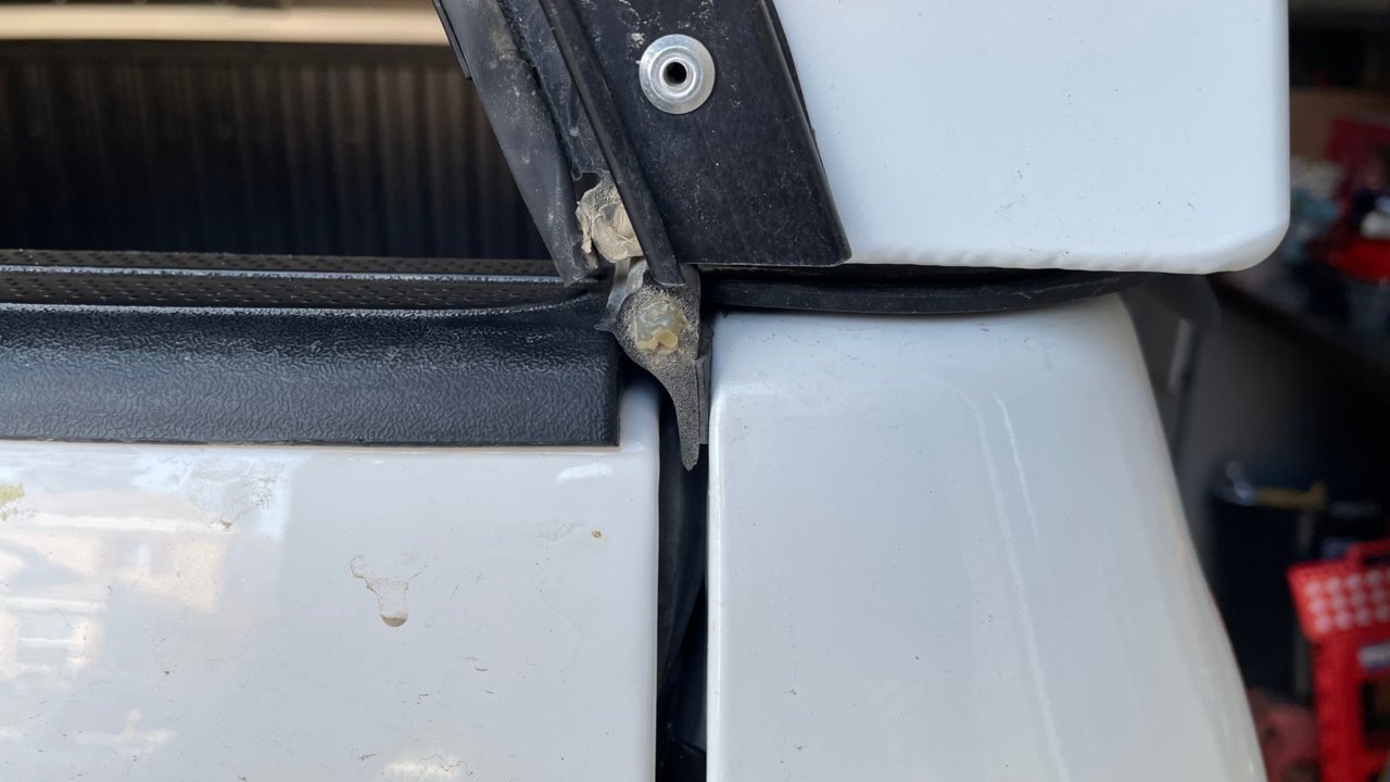

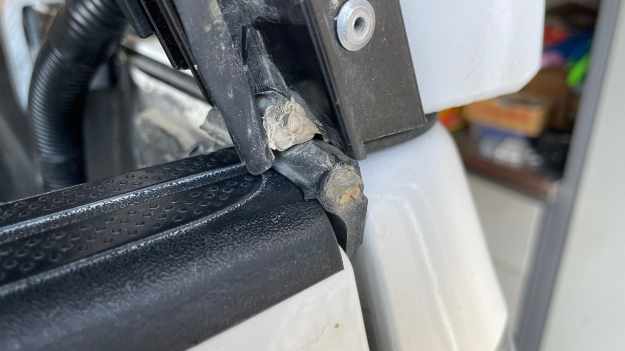

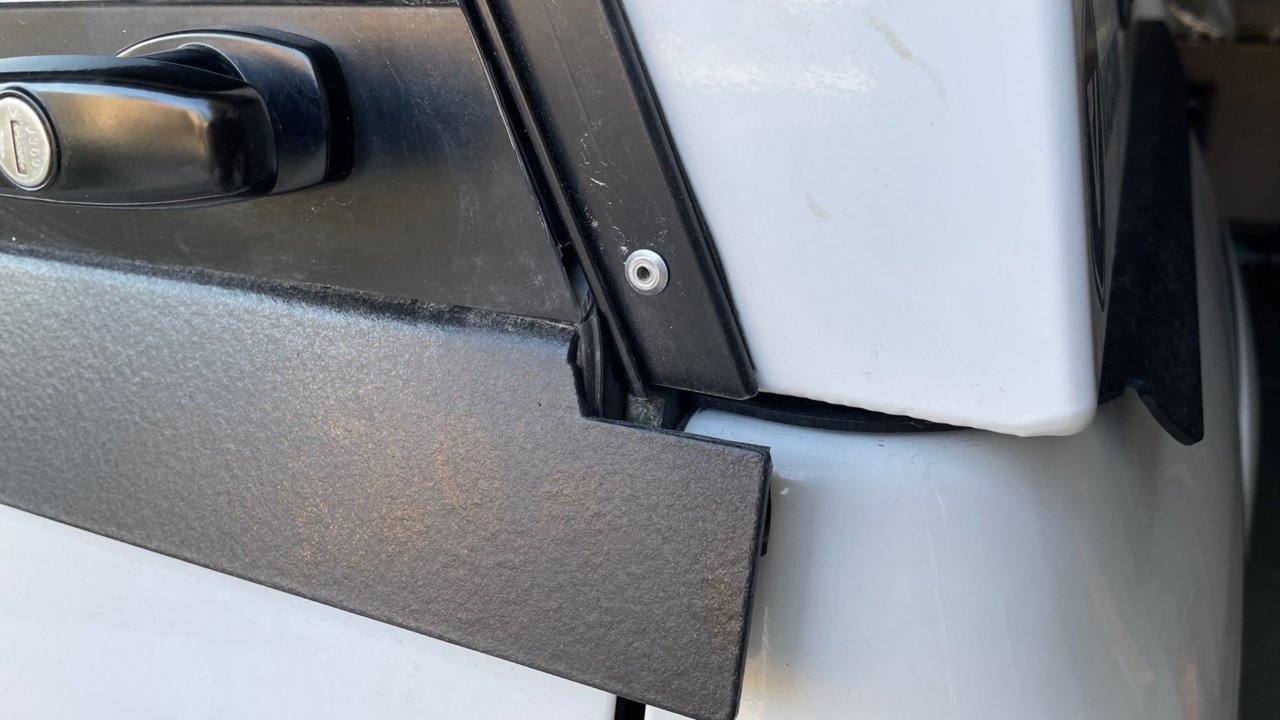

    Mine has held up fine. I think I want that rubber piece so small critters do not enter the cab. I even took some rubber seals I used to seal up the tailgate and suck them into various areas around the edge. I put silicone caulking inside for good measure.
    Doing all this and of course more. I do not get much dust instrusion.
