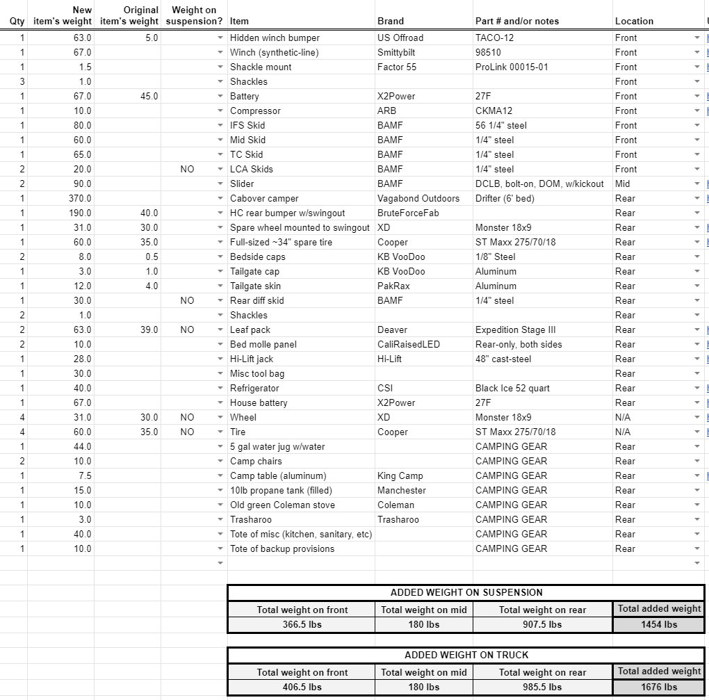

    In dealing with suspension changes, I recently created a little spreadsheet that deals with weight. It's far from 100% accurate, as some of the weights were estimated, and most others are from shipping weights from online retailers or possibly the manufacturer, but it at least gave me an idea of what I'm working with. I'd assume that I'm probably somewhere in the middle as far as overall weight added, because there are many in here with full build-outs, heavier bumpers and/or gear, and etc...
    I'm obviously already over the payload you mentioned, but it doesn't bother me and I'll be adding even more weight soon.
    If anyone notices a weight that's off, let me know!
    Also, I know I'm not done with this list.

    It's a whole lot easier and more accurate to just go to a CAT scale...
    I luckily had the thought to also get weighed right before I put the Drifter on, and I've weighed it multiple times since, at different stages of build-out and daily config vs loaded for a trip, etc.
    HIGHLY recommend doing that to know what you need suspension-wise and whatever else.
