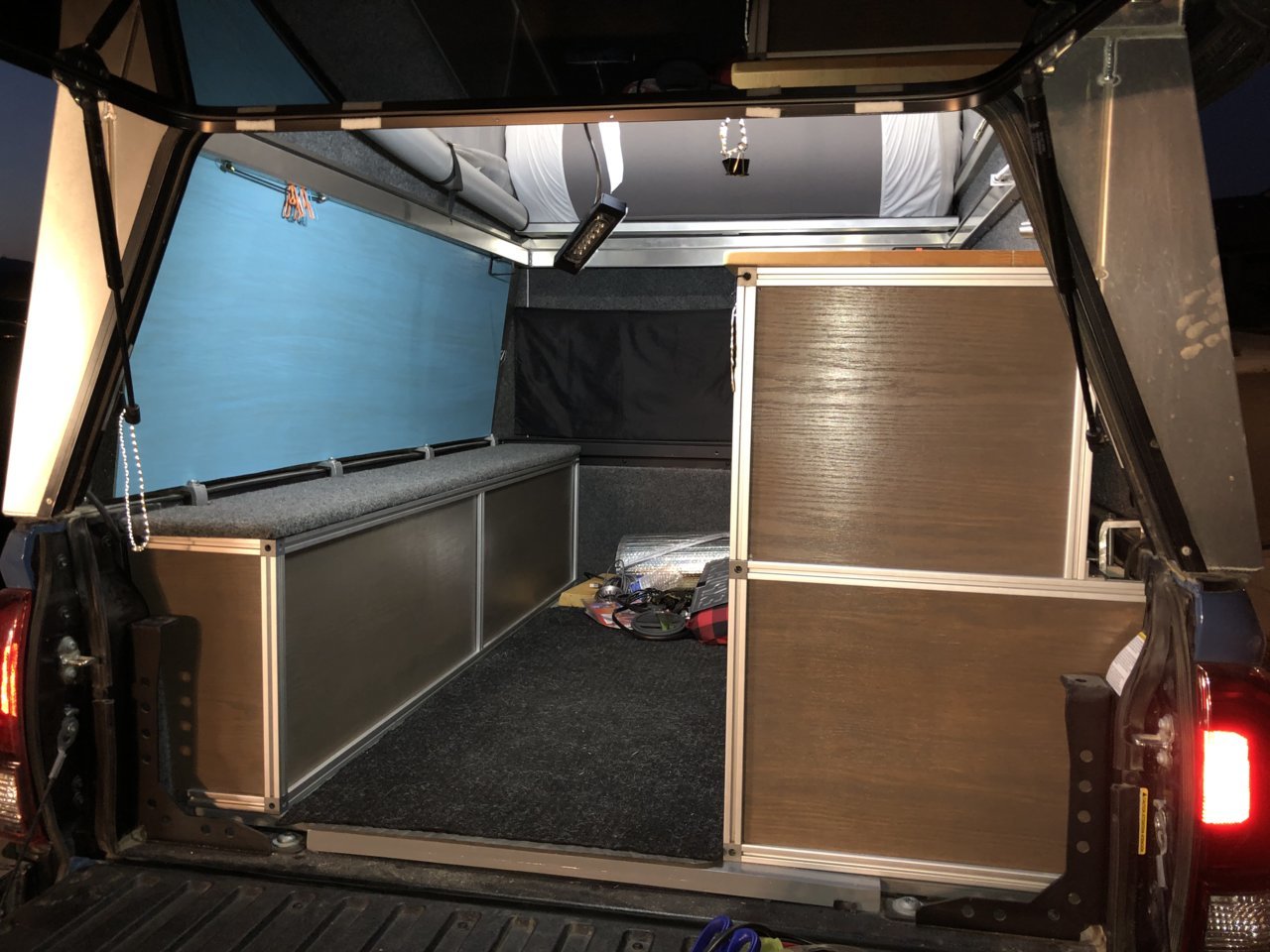

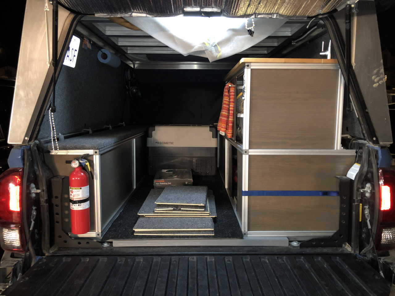

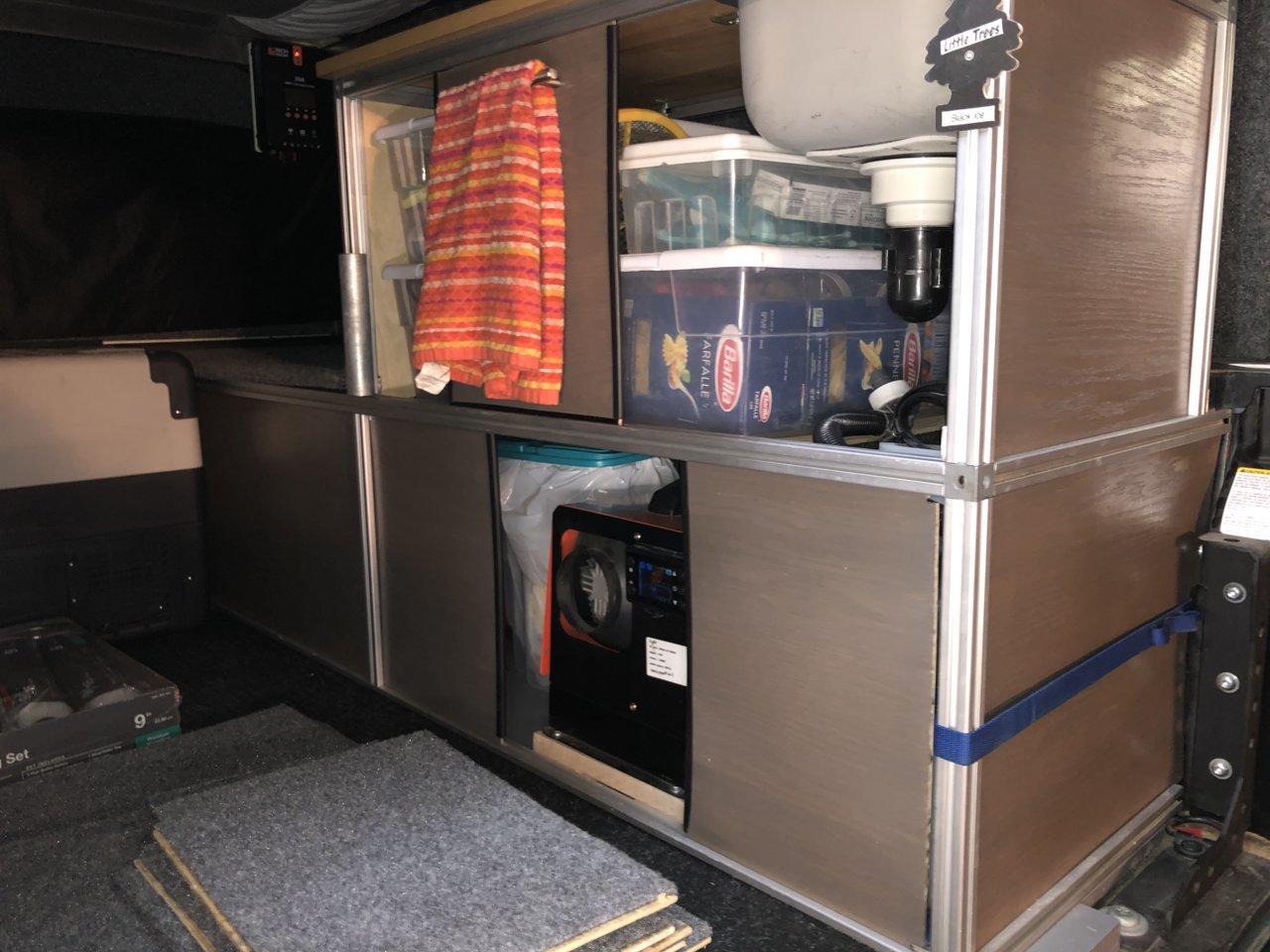

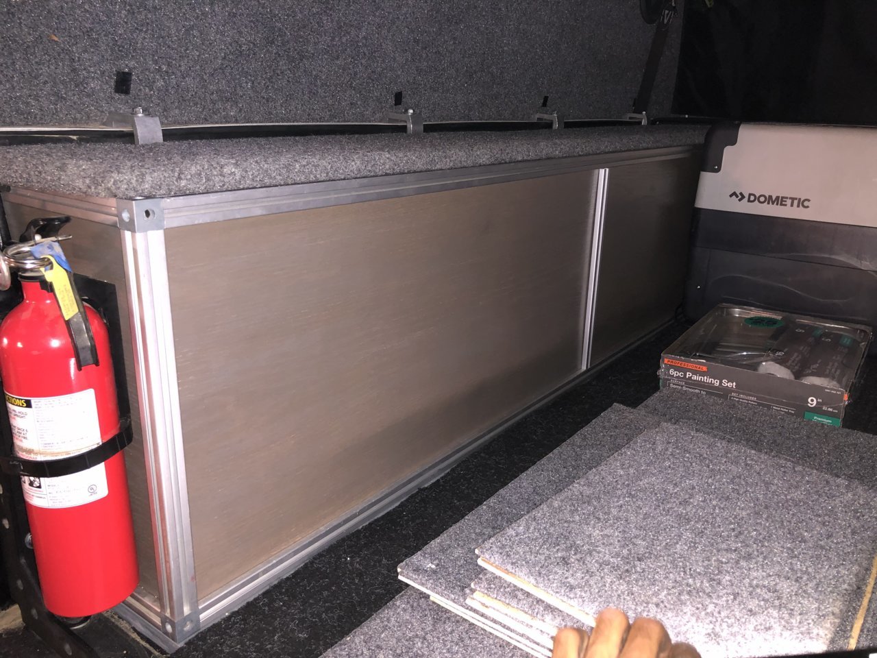

    Done with cabinets. I’ll redo the side panels, covers, counter, and more stuff later on...gives me something to look forward to!
    Oh and that blue...o_O Maybe solid a darker solid blue on ABS, but I’ll never do that again.
    Don’t mind the trim tape and on the cabinet doors. Temporary setup as I’m building something else to hide the boxes completely.
    The top picture is what it looks like - Took these at night

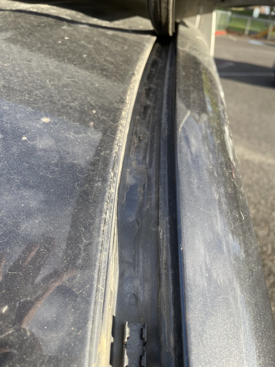

    What did your roof gutters look on the double cab when you removed the rubber strip? I am trying to figure out how to install a rack on my 2nd gen Access Cab. This is what I see when I remove the rubber strip. I don’t see any bosses to screw the rack into. Some say they don’t exist on the Access Cab 4C0702E4-70E5-4A35-A2FE-2E810167F1F0.jpg

    There is tape over the holes. Then the tape is painted over. I can see the first boss about 1/2" behind the plastic clip at the bottom of your photo. As for the rest on the access cab, I'm not sure.

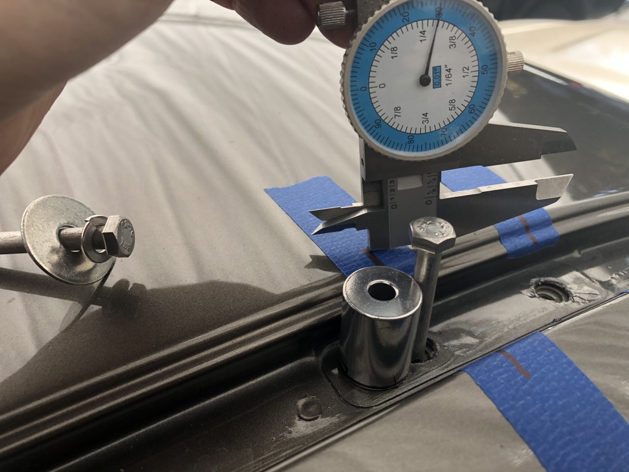

    Here is the only install pic. I chose to not remove all the tape. I think I just used an X-Acto blade to open the area where the bolt drop in. FYI I needed to get a shorter bolt for two of my mounting locations.

    They don't exist on the access cab since there's no factory option for a roof rack for the tacoma in this configuration. You have to drill and install your own nutserts.

    Not sure what rack you are trying to install but the Sherpa rack(Animas model) I installed only uses those front set of holes. I have a DCSB so the camper overhang is probably different but just some food for thought.
