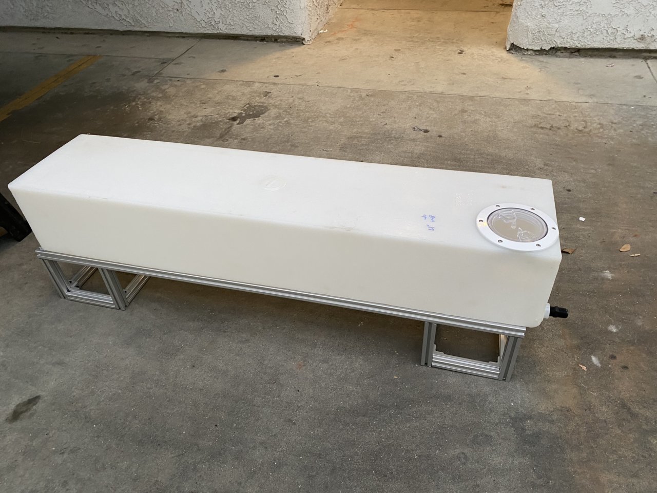

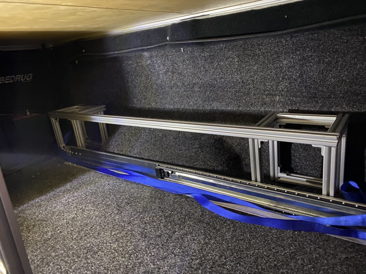

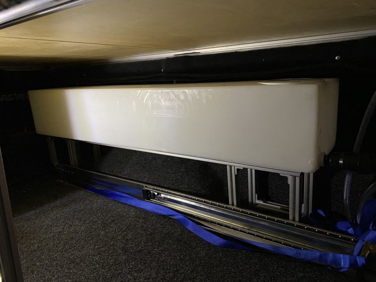

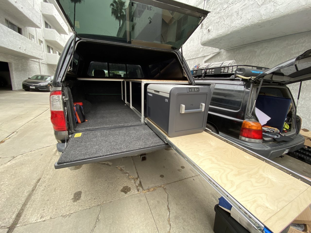

    I retro fitted a full bedrug from a 2nd gen tundra since the 1st gen bedrugs were discontinued.
    I also got the insulation package for the tent material as well as the lower insulation package.
    I do have a diesel heater but my main concern is keeping my 18 gallon water tank in my wheel well from freezing. I did a trip to Utah in the winter and my whole water supply froze and I couldn't use it.
    Was thinking of also just wrapping the water tank in reflectix so I dont have to take apart my whole retrofitted bedrug (took a lot of 3M adhesive and a long day of labor), what do you think of this solution?

    I used to hate that awkward space by the wheel well but its actually the perfect spot for a water tank
    I just used a ratcheting strap to the 2 bed tie downs to secure it against the sidewall of the bed.
    Do you think wrapping the water tank with reflectix would do anything in terms of keeping the water in the tank from freezing?

    You'd be better off wrapping it in armacell.
    I have a Propex heater and the return air will flow over my tank next to the wheel well to keep it warm.
    Depending on your battery setup and energy usage, you might consider one of these either inside or outside the truck bed...
    https://www.etrailer.com/RV-Fresh-Water/LaSalle-Bristol/277-000164.html

    Oh wow this is a gamechanger. thanks for this!
    Luckily my tank is next to my 2nd Aux battery. I'm running an Oddysey Group 31 AGM hooked onto solar. I'm only powering my dometic fridge for the most part.
    I wonder if its okay to attached this to a plastic tank, im only seeing it on metal exterior tanks

    Yeah, it'll be fine on a plastic tank. They're usually just designed to keep the temp above freezing and not too much more, and the water inside will keep the tank very close to its own temp.
    • Built-in thermostat automatically operates the heater pad
      • Turns on when the tank or step temperature reaches 45 degrees F
      • Turns off when the tank or step temperature reaches 67 degrees F
    Just make sure that there will be water on the inside of the tank where the heat pad contacts it. This is why the bottom of the tank is the preferred position for the heat pad.
