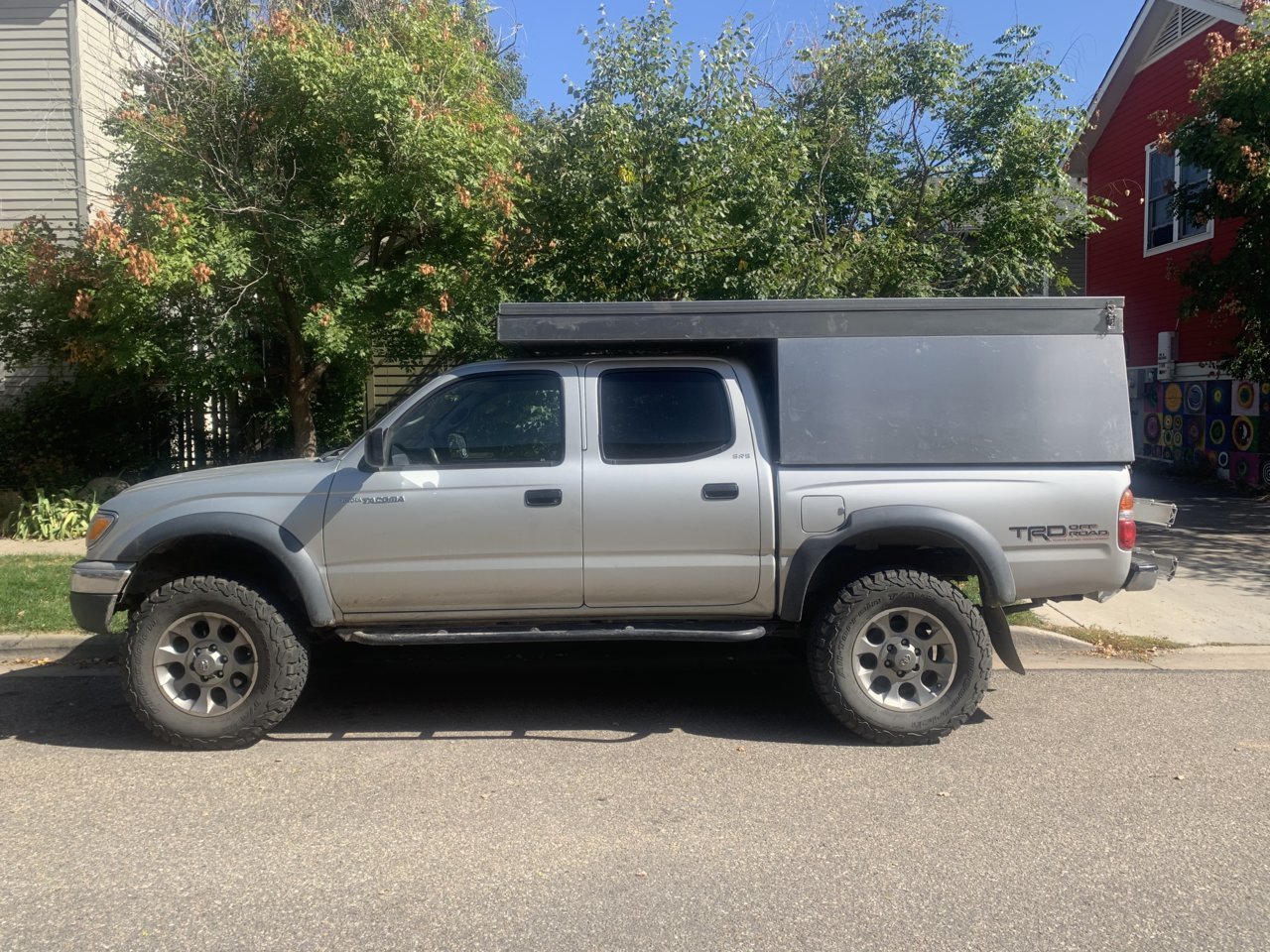

    Oh boy I'm going to be cutting it waaaaay close with the fan haha.
    I wish I knew how much my fiberglass shell weighed so I could do some experiments with the additional sag I'd get from the drifter(400lbs?) and buildout(50lbs baseplate, 50-75lbs 80/20 boxes, 65lbs fridge/slide). Makes me wonder if I should be doing an AAL or airbags with my dakar leaf pack.
    Any ideas?

    Don't worry; those Dakars will sag and you'll probably clear it!
    (according to the manufacturer, they 'W' by design :jerkoff:)
    :rofl:
    ...jokes aside, just add up your extra weight (like you did) and see what the total is before you go picking a new solution. I'm sure you could "google" the make/model of your glass cap, and find weight specs, and go from there!

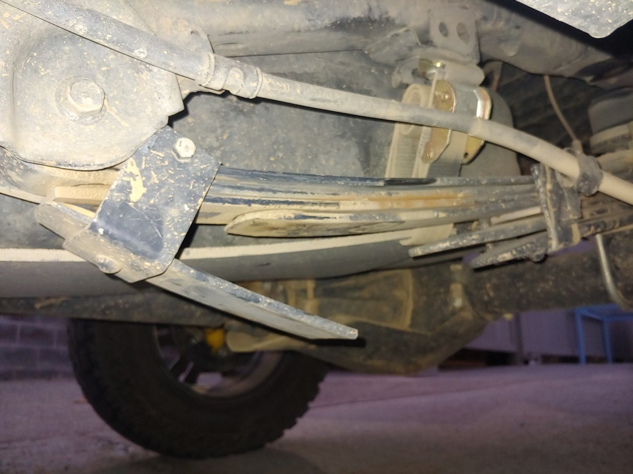

    I would definitely do at least an AAL if you have any of the Dakar leaf packs. I had HD Dakars and they went flat REAL quick! I have since gone with an Alcan leaf pack

    Haha nobody told me the Dakars were shit when I bought em! But yeah the AAL was the plan from the get go, now I'm all anxious about height though and need to decide if I need to ax the fan from my build. Aye aye aye. Guess I could get one size smaller tires worst case ontario...
    I tried finding my shell's info a while back only to discover its a defunct local company. I think I could safely guess around 150lbs for a simple 6' shell?

    Pack:
    • Dakar HD
    Added weight (at the time):
    • KB VooDoo modular bed rack (~50lbs)
    • RTT (~150 lbs)
    • HC rear bumper (~110 lbs (190lbs - 80lbs))
    • Rando gear ~150lbs
    After the first couple months, this pack flattened out, and eventually just became a W.
    The W of course is "by design" so there's no warranty for the sag.
    There is however a warranty for breaking and actual leaf - they did ship me out a new pack, but those went on the wife's Tacoma before we traded it in for her Tundra, and I went Deaver Stage 3. There are many that have issues with Dakars, and like mentioned above, I also wasn't warned about them before I bought them. Live and learn.
    See below...

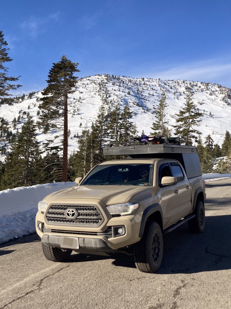

    I’m able to clear an 8ft garage with my skis attached on top of the drifter. I think I measured ~93” floor to top of the ski rack. Granted I am on stock size winter tires right now...I doubt I’ll fit when I put my 285s on for the summer.
    Setup: King 2.5ext front/rear with stage 2 deavers. No bed buildout or anything.
