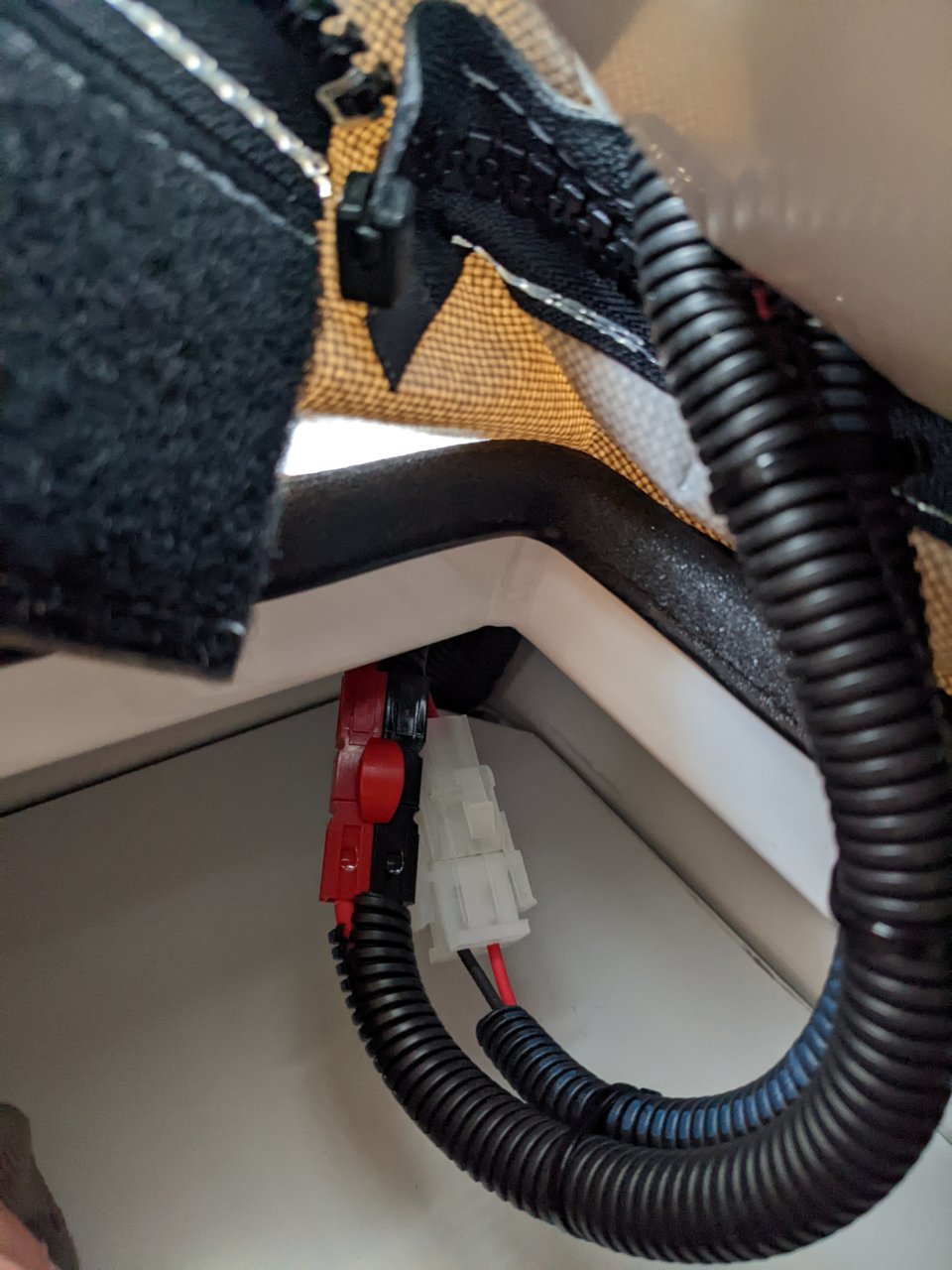

    So having some issue with power getting from my panel to my battery. Tested the panel today and I was reading 23 volts and 2.5 amps in the cloudy weather. However when I plug the panel in and measure at the Anderson input connector for my battery, I'm reading 0.
    I now want to test from the top down, and this seems like the first internal place to do so, but can't quite figure out how to disconnect what I assume is the solar on the left. Also any ideas what the wires and connector on the right is? Also any ideas on how to troubleshoot this as it's my first time doing anything like it.
    Thanks

    Drifter wedge camper, Dual battery, OBA, ARB locker, 4.56 gears
    My guess would be fan and/or light if you have either on your ceiling

    Oh true that's right, fan has been wired.

    If I understand your question correctly you are asking how to disconnect the Anderson plug on the left? Pull the retainer out from the middle and it will unplug.

    Ahh yeah. I couldn't tell if it was a lever or what, and have a propensity to break things trying to mess with them so figured I'd ask.
    Curious to see what the issue is here. The solar in is nice and isolated so I can't imagine it'll be hard to find

    Good luck with the search! I would have guessed a fuse or loose wire/connection being zero at the battery. Please share what you find.
