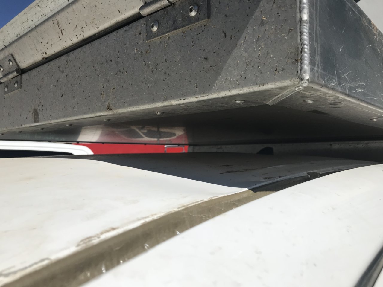

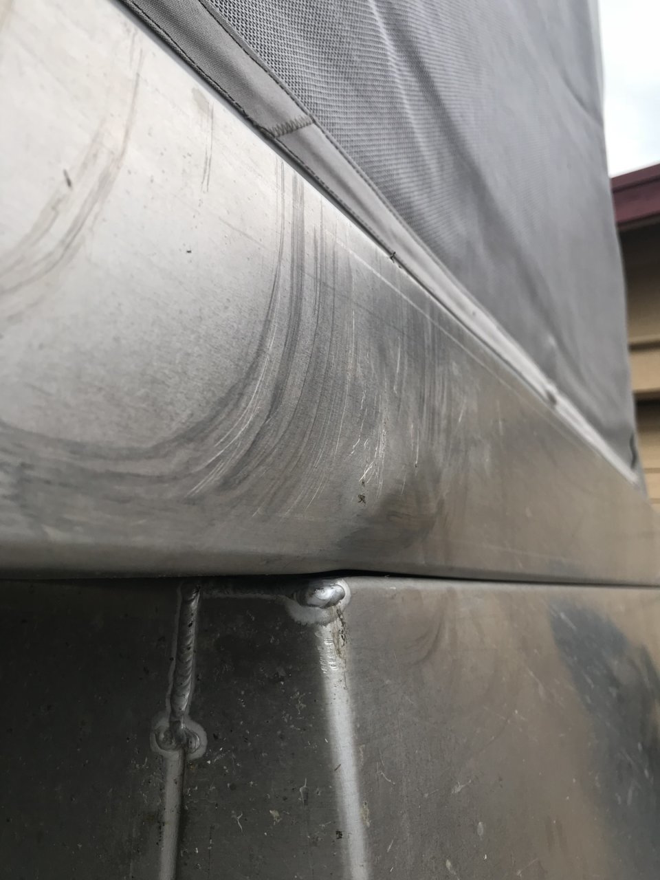

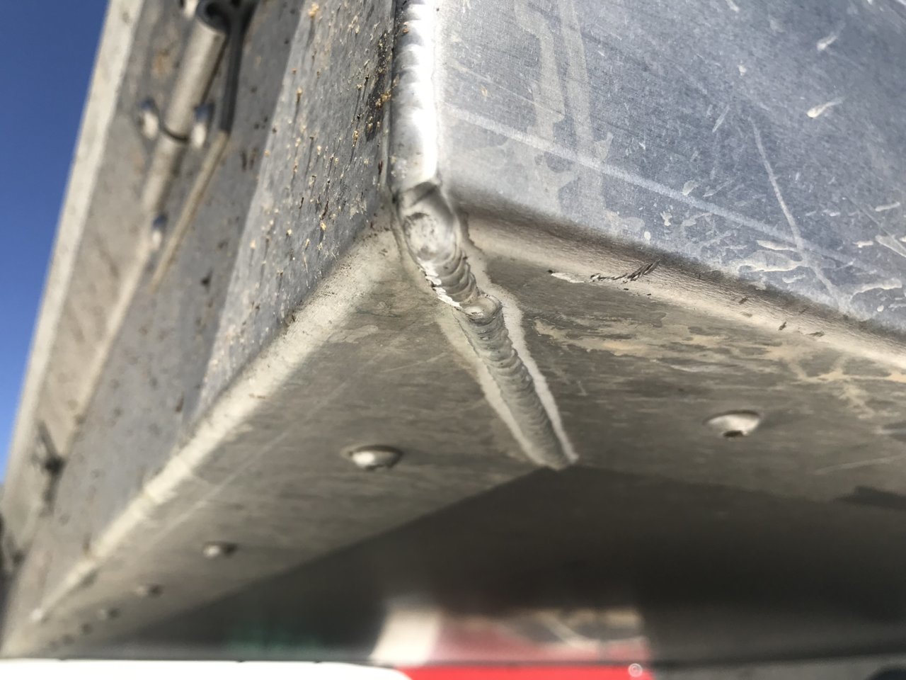

    Because of the way the campers are designed, each panel/ major component is a structural shape that has rigidity due to the strategic bend locations. The design also allows for the distribution of static and dynamic loads over a greater area. This reduces stress in the corners, which are obviously areas that can handle more compressive forces. So it’s really hard to point load the camper in most situations.
    It looks like the DS part of the cabover took the weight of the truck and the lower lid compressed into the front DS portion of the shell. And that section of the cabover took a direct hit to the ground. The damage is considerably minimal.
    All of the bends, rivets, and bolts can be easily observed from the interior. The welds can be inspected from the exterior. Unlike composite components that could have internal damage which can’t be visually inspected. This is the welded area that should really be inspected:
    Looks pretty damn good to me.
    One thing to note about Zero: Unlike the production models, there is no adhesive sealant between the shell and lower roof. Just the (24) 1/4-20 SS button head cap bolts and flanged lock nuts. We put closed cell foam tape in between there so we could remove the roof assembly later. You know- for science. Same with the lower cabover panel that has adhesive sealant on production models. Just foam tape there too.
    So Zero is actually less structurally sound than our production units because it has no adhesive.
    I’m not going to say we built the strongest camper, but it would obviously do better than our trucks in this situation.

    When insurance came by we noticed there was a dent in my roof, but we all agreed there was no way that was from the camper.
    Looked closer today and my cab and the Drifter cab over definitely made contact with each other during the roll. Pretty crazy that the Drifter cab over portion over extended and hit my roof (well, my roof hit it rather) - and then popped back out with no damage (to the Drifter).
