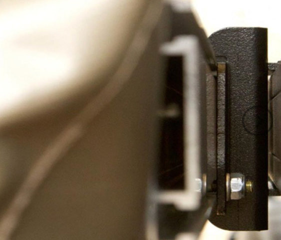

    You can definitely just through- bolt it. There is nice access on the interior. I used the hardware that came with the awning.

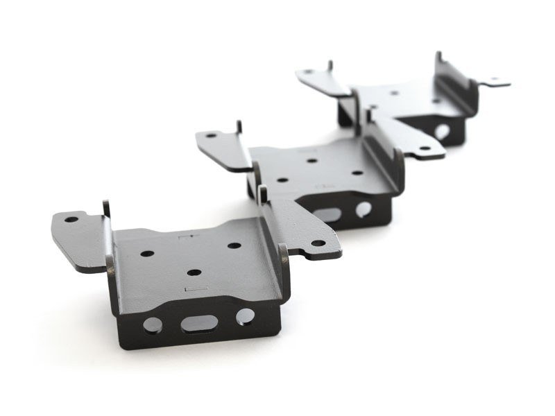

    For easier removal, this might work.
    Bolt these to the side or rear of the lower roof.
    The profile of the Frontrunner roof rack is 50mm, or 1.96”. These brackets fit over the edge of the rack and should fit over that 10-series T-slot extrusion.
    This hasn’t been proven- just something that will most likely work.
    Looks like some testing is on the horizon.

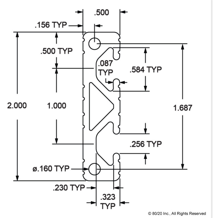

    So did you end up drilling 2-4 holes per side? my thought was to drill/counter sink and notch out the extrusion from inside the bag in 2 spots and either use carriage bolts or some flush allen heads rather than the smaller hardware that is supplied but idk yet. need to check it out more one I get it home.

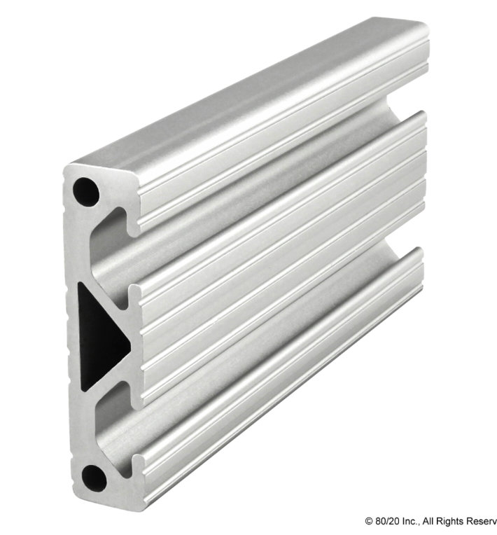

    The FR brackets definitely looks like a viable options! I wonder if there is a "male" end extrusion that would slide into the existing T slotted extrusion that comes on most awnings... Slide it into place and lock it. im going to have to dig into this more

    I drilled 4 holes for the rear awning. I believe @MJonaGS32 drilled 8 for the side awning. 6 would probably be adequate though.
    I don’t know of a male portion of track. Seems like it would bind up on an extrusion that long.
    I’ll try the other T-slot method and report back :thumbsup:

    I have a few ideas brewing for those front runner mounts... let me know what you come up with :cheers:

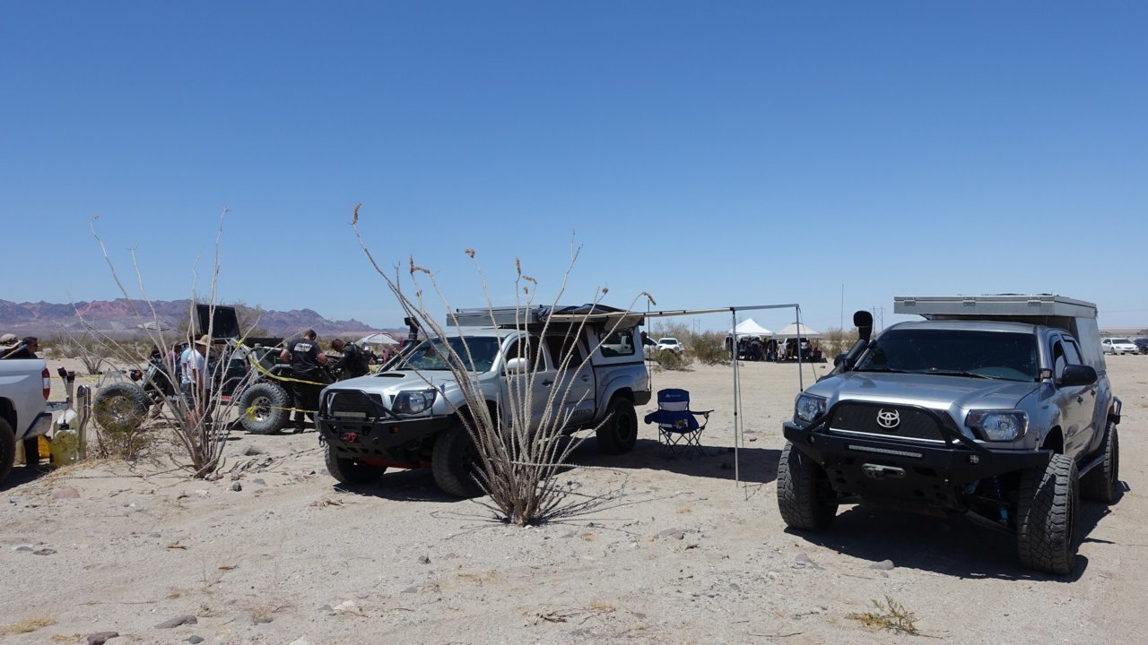

    My rear awning (Tepui 4’) has four bolts - 2 pairs
    My side awning (ARB 8’) has eight bolts - 4 pairs (PITA to install but wanted the overkill)
    The back side of the awnings (inside the camper) has 2” wide aluminum flat bar sandwiching the lower lid with nylock nuts. I also have closed cell foam on alum flat bar and again on the back side of the awning on the outside of the camper - also sandwiching the lower lid.
    Here is a kind of shitty pic of the side awning opened as @tacomgee and I were watching the Baja 500

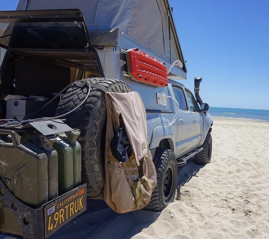

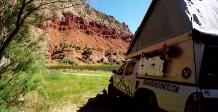

    Here's @tdubd 's setup. Sorry, low quality IG screenshot. Maybe Todd can post some better pics
    And @MJonaGS32 's

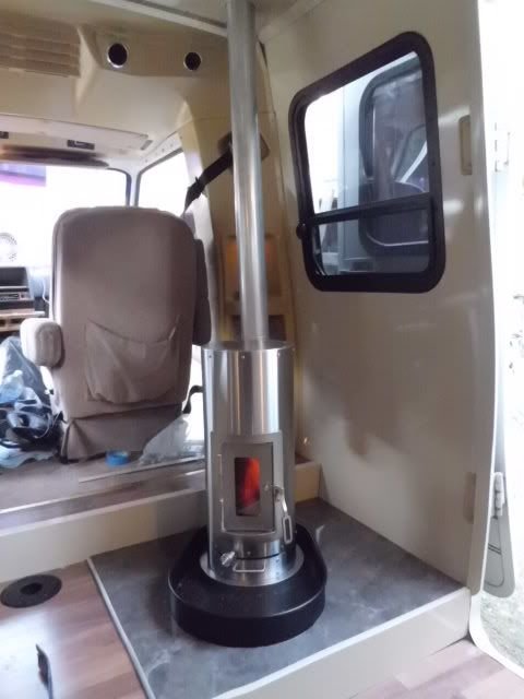

    A wood burning stove in a tacoma? Hmm, this could be the game changer the overloading crowd has been looking for hehe.
