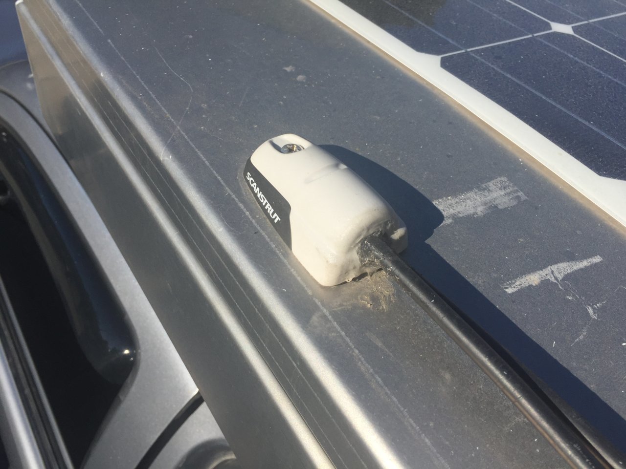

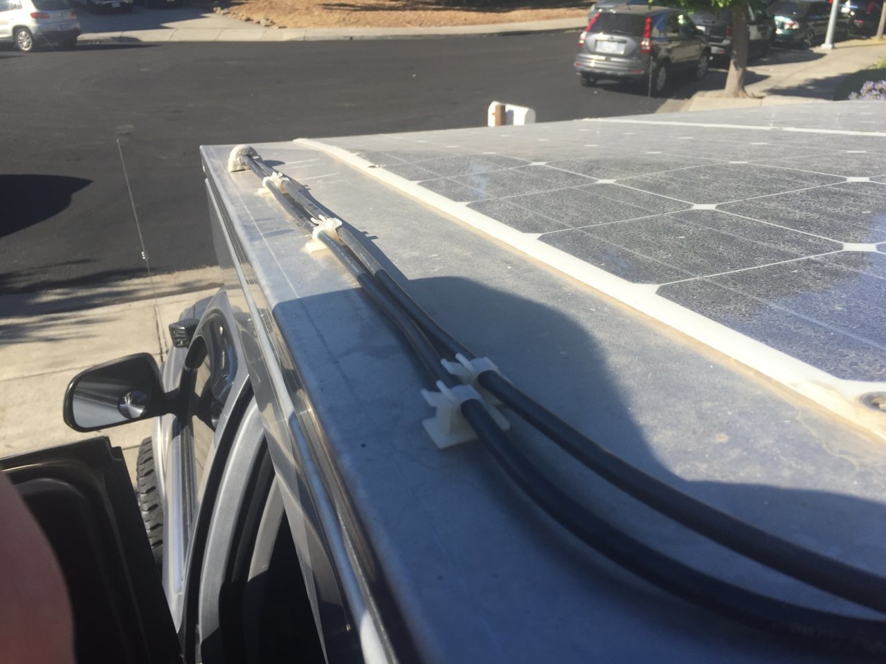

    I used a slightly different grommet but this gives you an idea.
    I drilled it out just a tiny bit so i could run both wires in one. Then filled it with sealant to make sure it doesn’t leak.
    So far no water after rains and multiple car washesF0AFE3B4-C453-48E3-AD81-26111AABDC9D.jpg0931C51B-5D27-4531-BADD-543F4970E61E.jpg

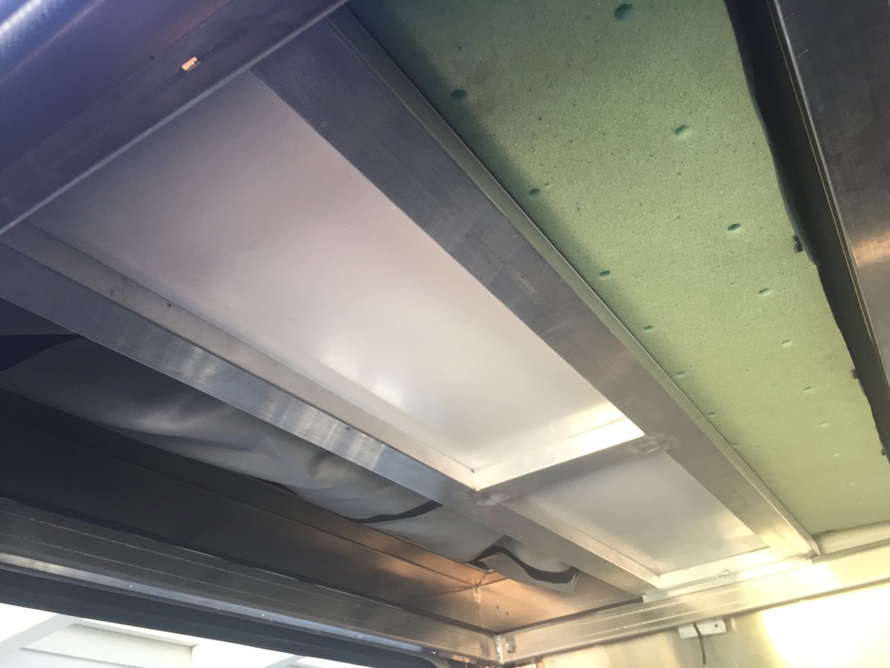

    Here’s what i have. I think they are doing something a little different now. This was the first version.
    I use the green memory foam piece as as a cushion for the extension and it works great81DA4112-85CC-4F4C-B96F-8A5BEAA57BC3.jpg
