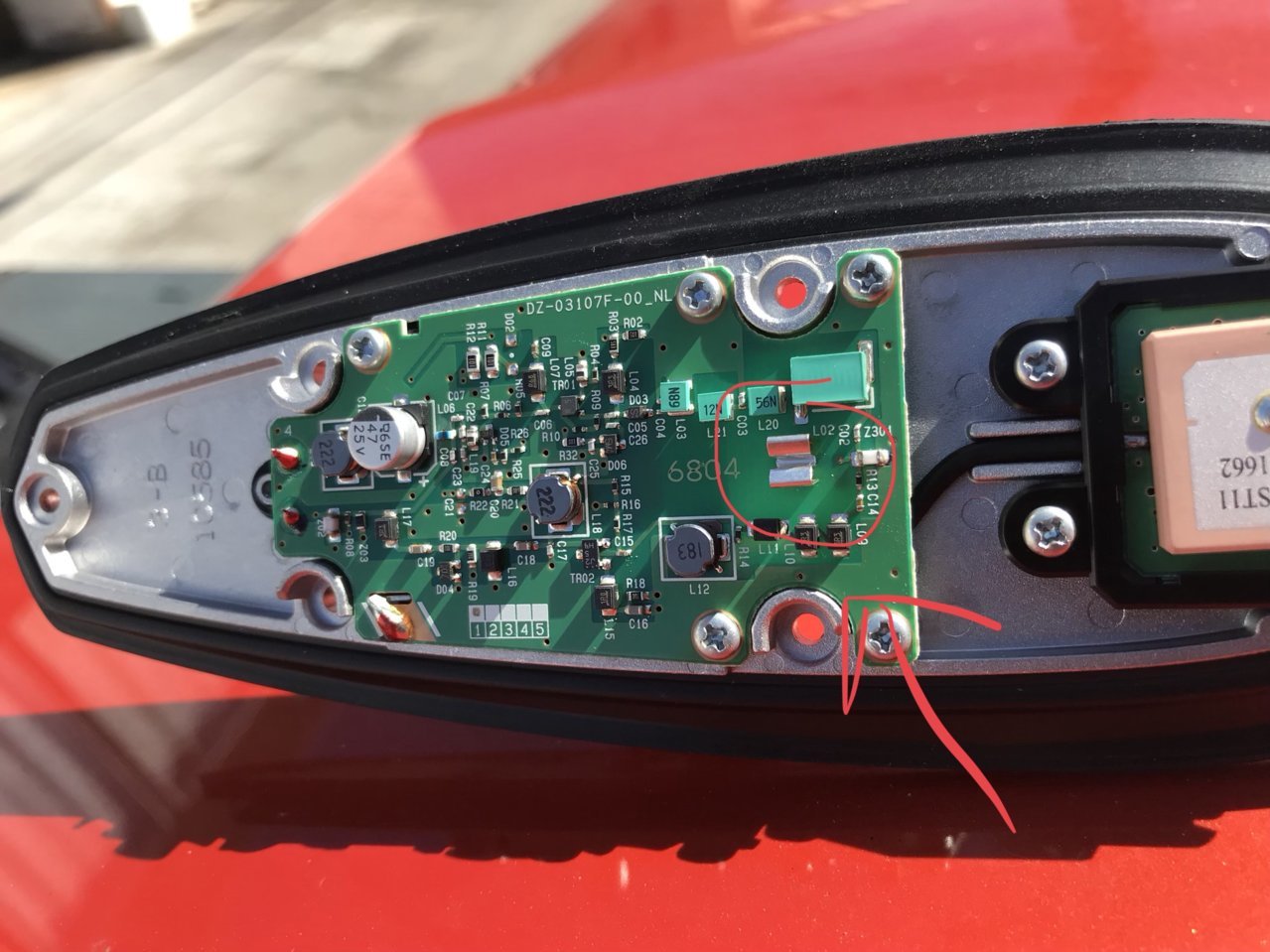

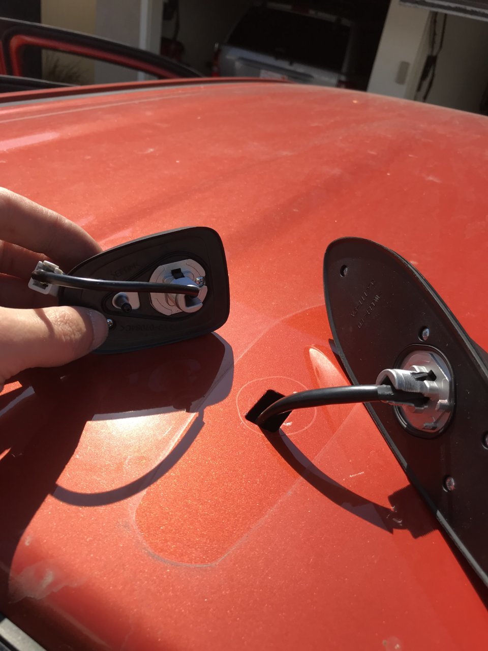

    I began switching out the shark fin on the 3rd gen based on this post: https://www.tacomaworld.com/threads...shark-fin-with-a-oem-satellite-stubby.552228/ only to find significant differences between the two generations. I believe the Nav and sat radio are both wired into the shark fin on the 3rd gen. The electronics and hole configurations are completely different:
    36309C6D-A753-4ED6-87D2-8F7BFD1BF4AA.jpg 55800644-1DF2-4CF2-ABC3-E93B0A8A59E9.jpg
    I didn’t have the patience to try various shark fin models and years to make it work. Better to find out if the mod was actually necessary before I tore into the interior again.

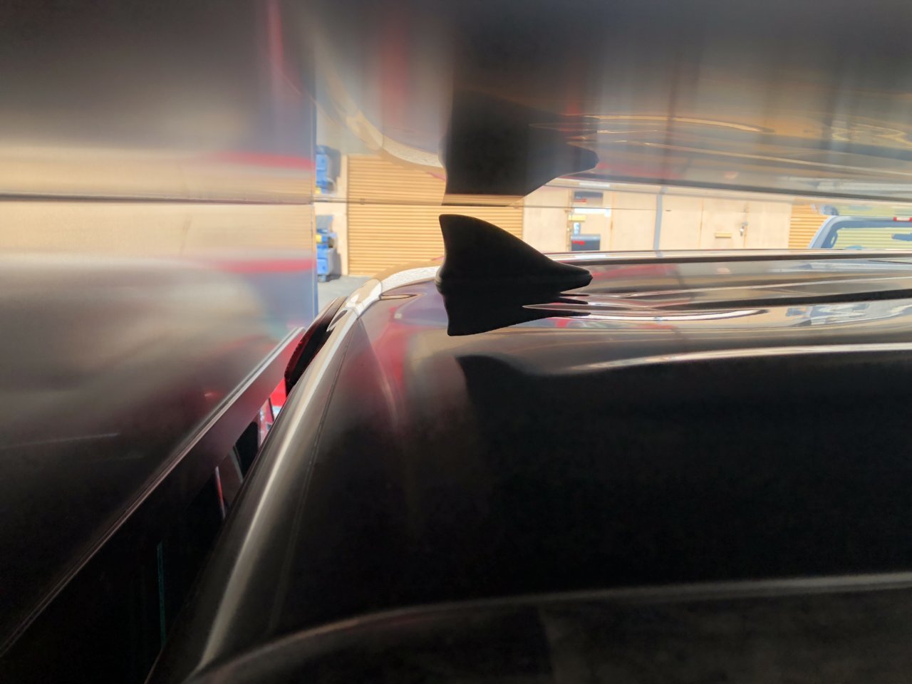

    Sorry for not chiming in earlier. Here’s @anomalyTRD ’s 2015. Sharkfin. KB Voodoo bed caps. It clears with no modifications.
    Not sure if XM Radio still works though.
    Edit: Not sure if the roof dent helped with clearance :notsure:

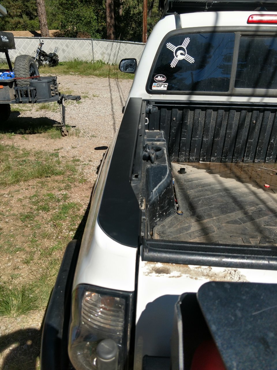

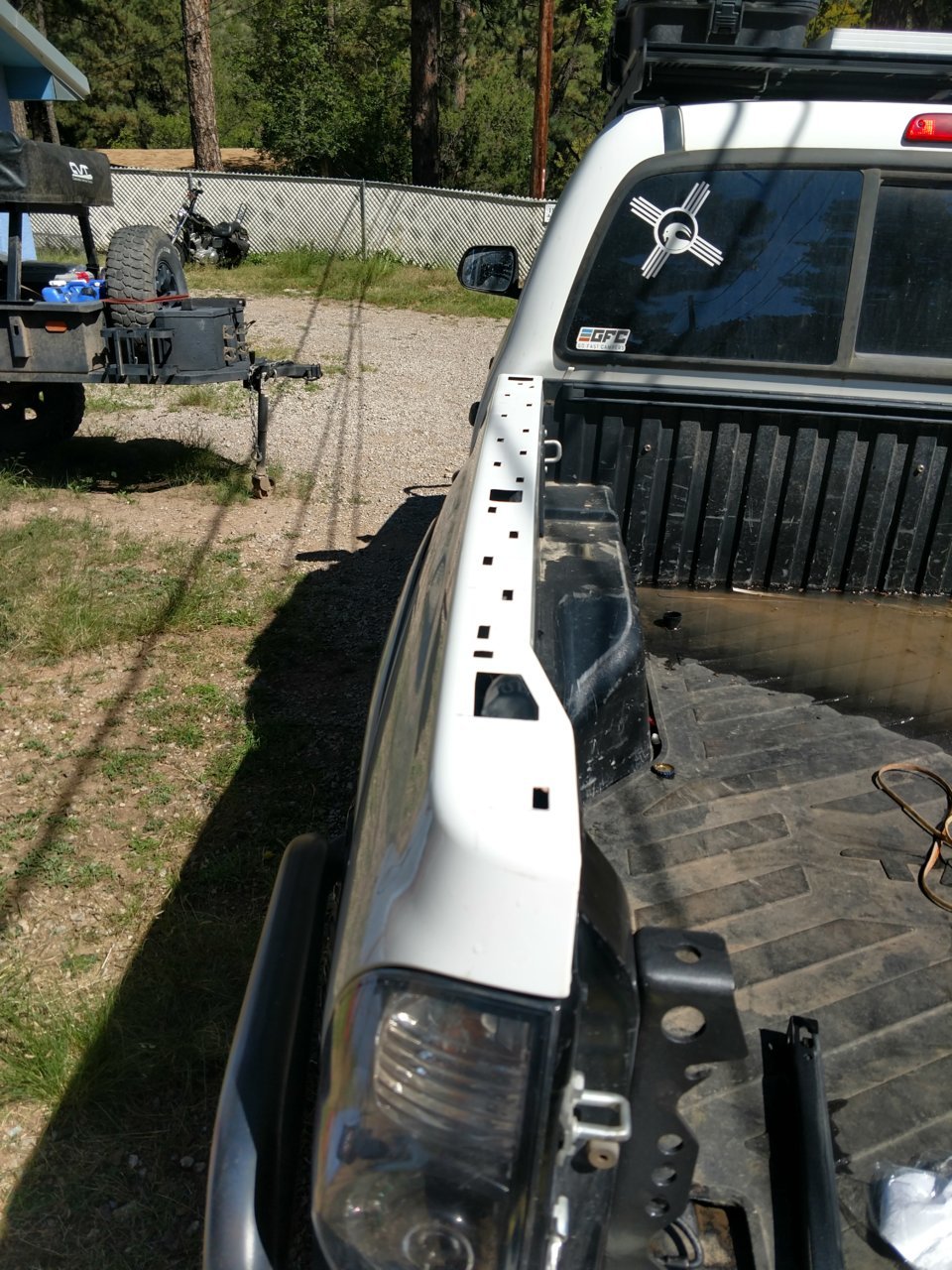

    I've been prepping for a GFC and so far I have the kb voodoo bed caps that I used aluminum duct tape and silicone to seal. I don't foresee any water coming from under them.
    IMG_20180930_123611992_HDR.jpg IMG_20180930_124638083_HDR.jpg IMG_20180930_132849221_HDR.jpg
