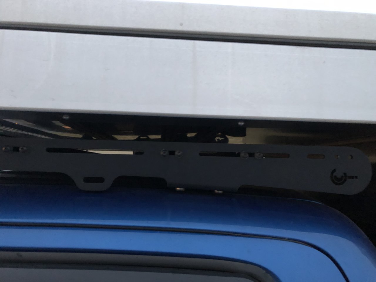

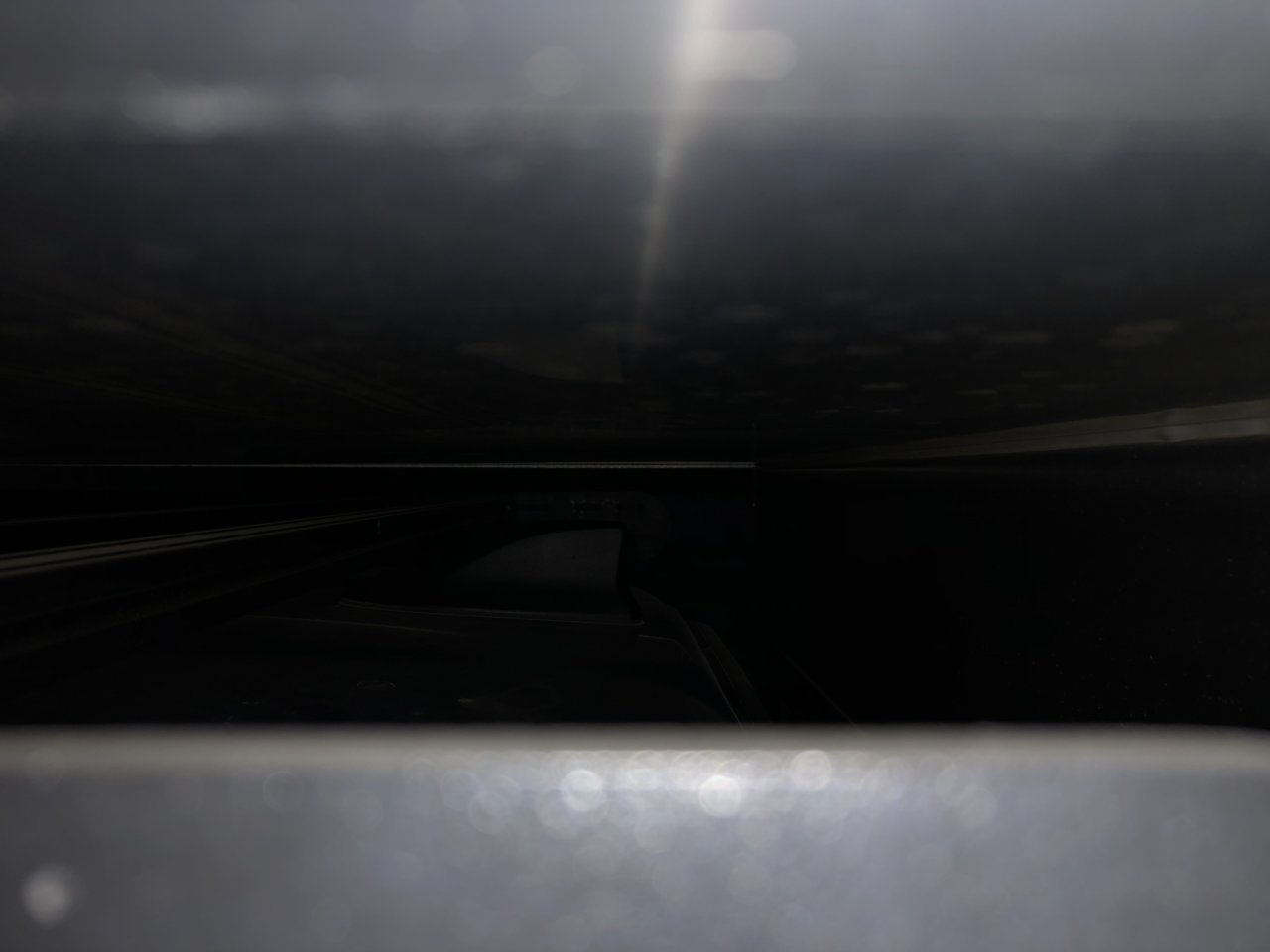

    Day late but here are the pics with the stock 3rd gen plastic rails and clearance with a drifter
    First pic ahows clearance to prinsu rack.
    Second pic shows clearance to shark fin its dark sorry i’m on the side of a hwy but you should still be able to see the clearance oooks to be about 2” 80387F3A-F819-42A1-AEB2-C076D3D51018.jpg

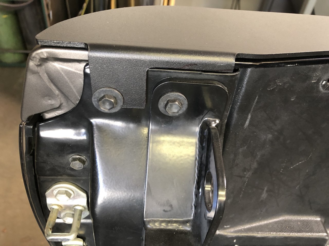

    @huruta ,
    Your truck is a 2015 model, correct?
    The TC Bed Stiffeners and KB Voodoo bed rail caps share a common bolt near the bed rail cap. Here you can see the TC bed stiffener using one bolt, and the KB voodoo using two.
    ^ Pic from KB site and google
    It does look like there will be interference and possibly modifications necessary.
    Edit: We did install these on one of our new builds. Here is a shot of the modifications.

    I’d still trim them. That angled part at the top provides no support to the bed. Kr just buy a different type of stiffener.

    I would not trim the stiffeners but trim the bed rail caps. It’s not necessary for the caps to use both bolt holes so just trim the caps so that only the rear most hole is used.
