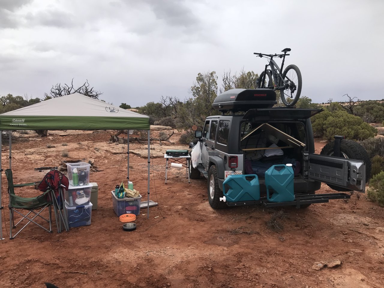

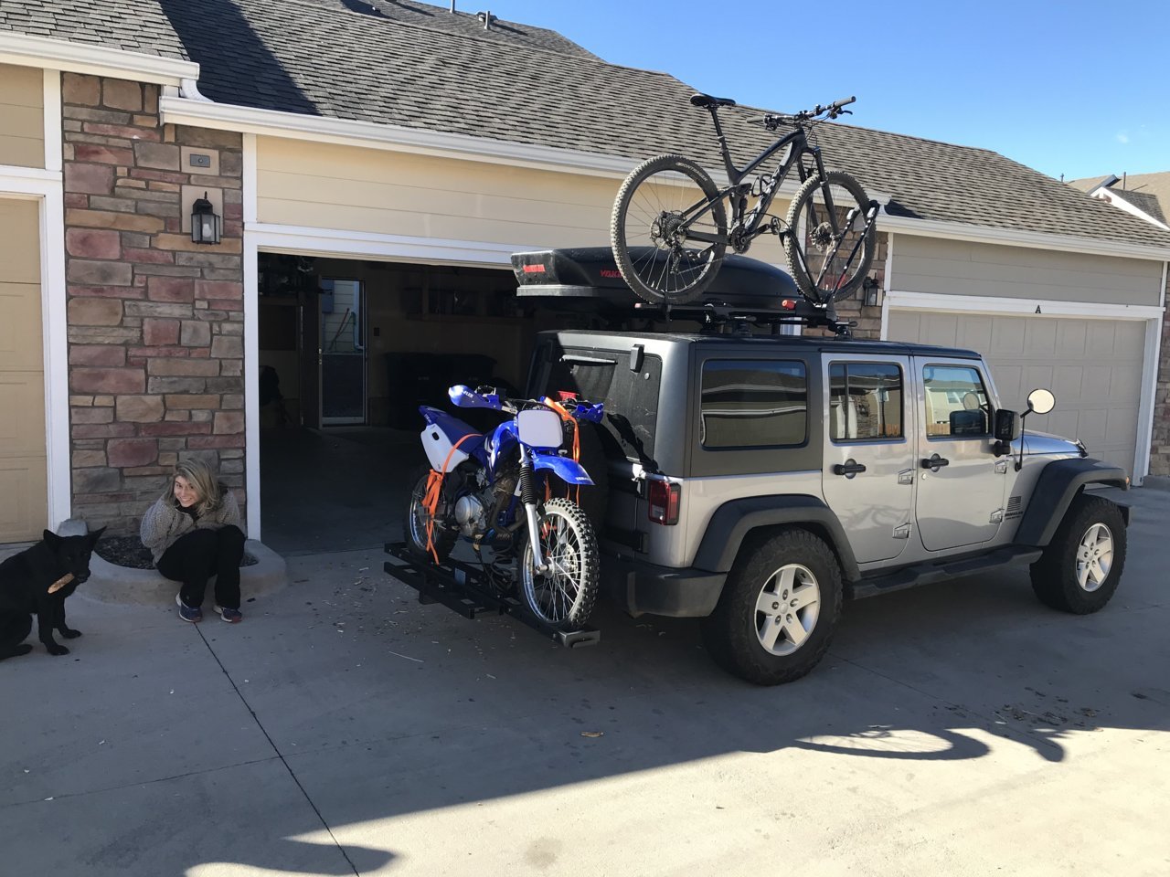

    1) what mod would I have to do to the truck to support the weight.. daily this would be the drifter plus... a mountain bike or rock climbing gear. I’m sold on the pro.. I like the look of it and seems to fit what I want.. to ride comfortably down forest roads as I race to a trail head or base camp spot. I take really good care of my vehicles and try not to go too crazy with after market parts.... try..
    However camping, it could be large cargo carrier, mountain bike on drifter roof and my wife’s dirt bike on a hitch carrier plus other glamping items..
    See photo.
    I do not plan on building up the truck bed as we use bins when we camp. Would like the option to build if I want though... as maybe our family grows... another reason I need to buy a new truck and drifter ASAP.
    I was leaning toward a deaver expedition heavy duty leaf set hoping this would be the only suspension mod I make... maybe upgrade the bump stop? I like to keep my rigs as stock as possible suspension wise. I will add rock rails but nothing much after that.
    (What would I need to do to truck to prepare it for daily drifter weight)

    Hey @georginclay04 , I don't have a Drifter, but I do have a Habitat, which is similar in weight.
    The only point I can really talk to is the suspension:
    I run the Deaver U402 Stage 3 Expedition springs on my 2nd Gen, and love them. Which Stage were you looking at? Mine are 2.5-3 inches of rear lift at 700-1000lbs (I think on a 3rd gen it's like 2-2.5 inches). I went with that due to tongue weight as I tow a trailer pretty regularly, so you might not need to go to that extreme; perhaps Stage 2? Day to day my rear-end is sitting pretty high, and that's with the majority of my camping stuff living back there full time. Also something to consider, I went with slightly longer shocks as the Deavers have more down travel. Your stock shocks might not like being extended to the max regularly.

    It seems Deavers are preferred well.. at least you all sold me on them. I’m spending a lot of $$ for set up so won’t skimp on this if I have to.
    The site doesn’t mention how much lift it would give. I was hoping it would be minimal so I could avoid shock replacement. Series II OR III.
    I could always do II and then get a bump stop if I need to? Airbags seem like a pita so trying to avoid. Plus... I know I could install the springs and a bump myself... airbags... ehh don’t want to deal with hoses.

    I NEARLY went with airbags. They are a great option if you are going to have highly variable loads. Running the hoses would be extremely simple if you just used a bike pump to air up the bags, it's obviously a little more complicated when you start running electric on board pumps and switches and gauges in the truck cab. You could also avoid any unwanted lift with airbags.
    I believe all Stages I-III have the same lift, just at different constant bed weights (I - 0-300lbs, II - 400-600, III - 700-1000). I sit about stock height in the rear with around 900lbs in the bed, plus 3-400 pounds of tongue weight.
