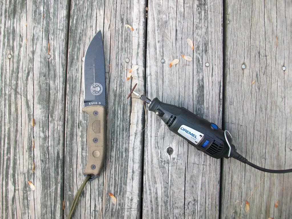

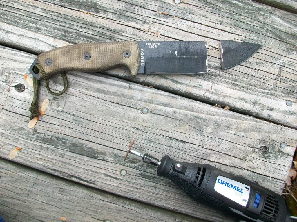

    So, I'm a huge fan of ESEE Knives, they're some of my favorite outdoor tools. So I got an idea one day to turn an ESEE into a gear selector (or shift lever, gear lever, shift knob, whatever you want to call it.) The 5 was the obvious choice as it's the fattest of their knives at 1/4". Took me about a month and a half to find a used one, I just couldn't cut up a brand new one.

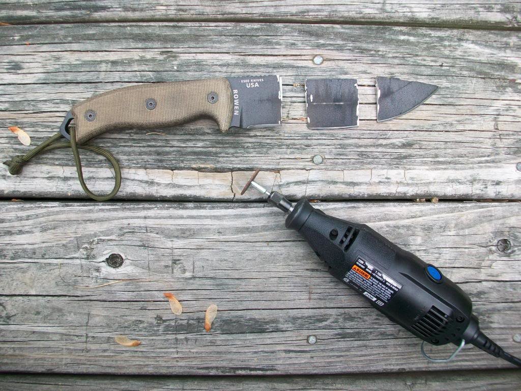

    Ready to meet her fate.

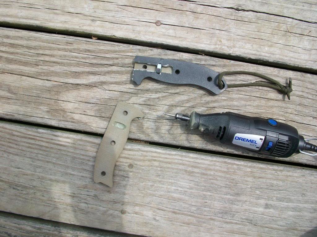

    First cut, man this thing is thick!:eek:

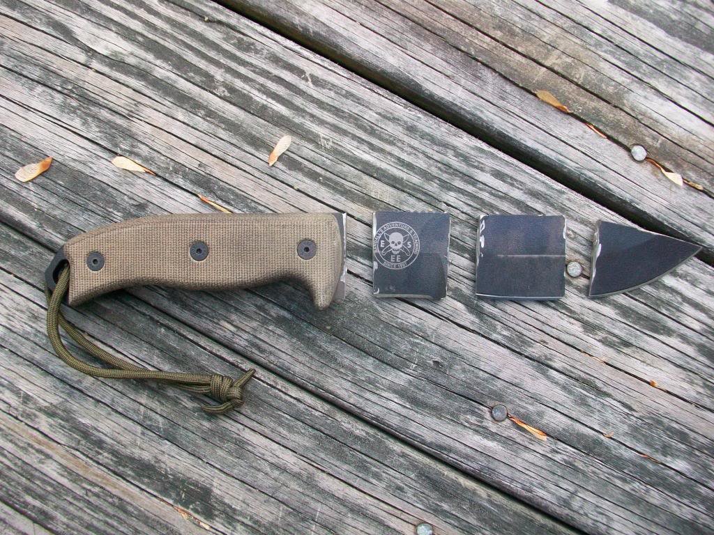

    Cut two, working towards the end.
    Cut three, down to the handle. I wonder if the warranty is still valid?:confused:

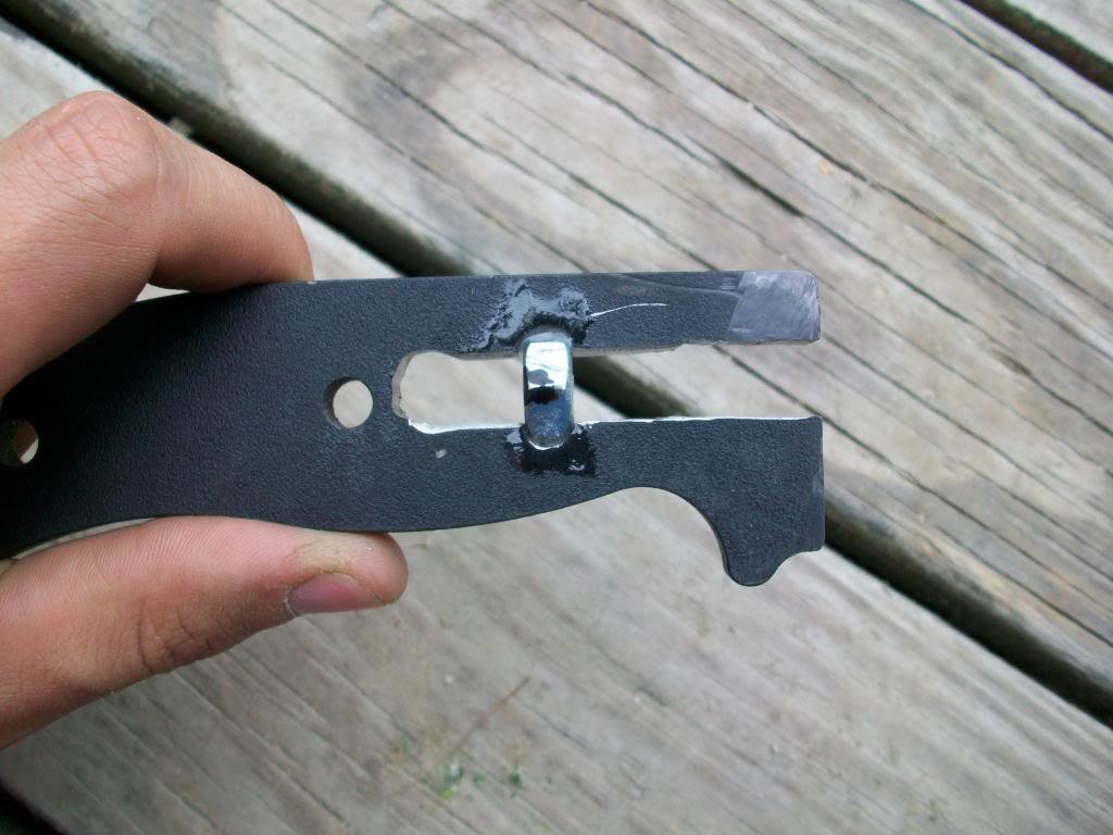

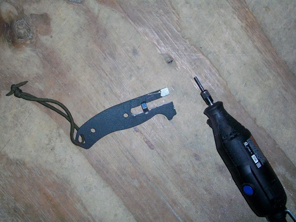

    I then cut the channel when the piece of gear rod goes and cut out a space for the nut.

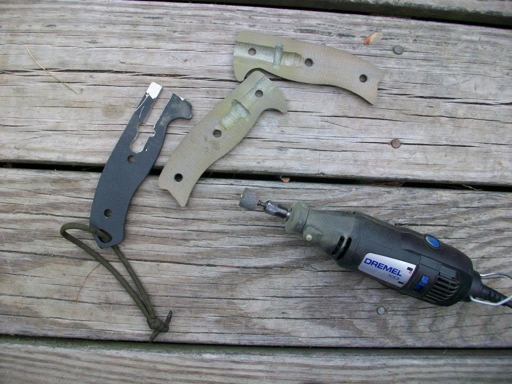

    Cut out a space in the handles for the side of the nut.
    Sanded out a small channel as the gear rod is about 3/8 think.
    Epoxied the nut into place. I also took a bluing pen to most of the exposed metal.

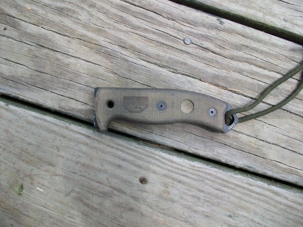

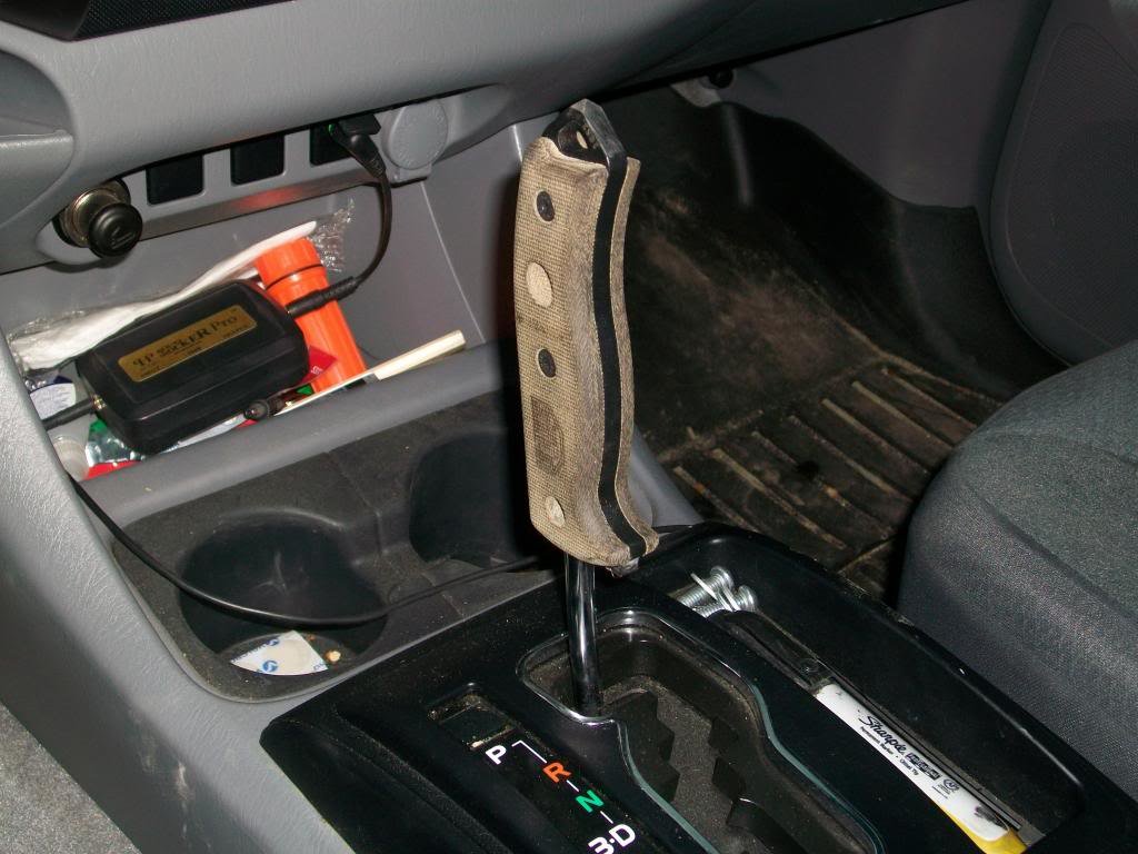

    The 98% finished product. Just need to cut the other two handle screws and glue them on.

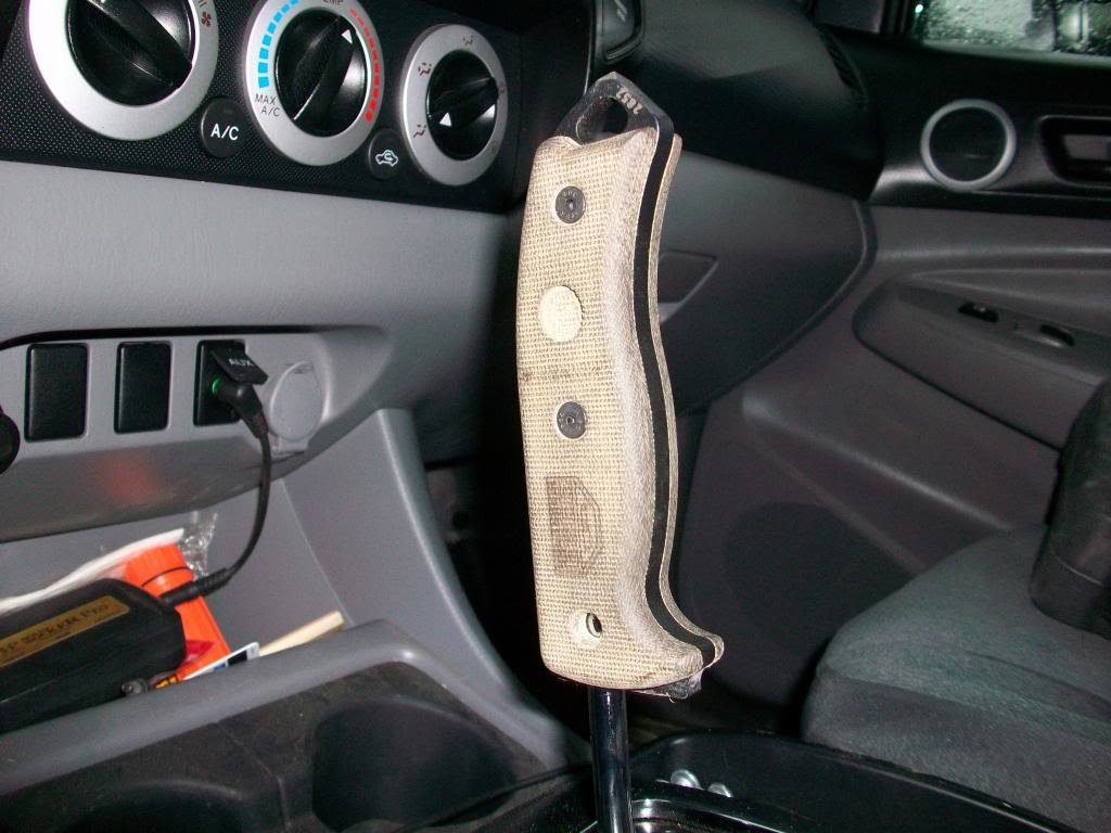

    Mounted. :cool:
    It was a great project, probably only took about 10-12 hours all together. I'm really happy with how it came out too! Definitely one of the more unique gear selectors out there. All it took was a Dremel, some zip wheels, A tungsten carbide cutter and an engraving cutter.

    Unique! I kinda like it! I used to make aluminum pistol grips shifter knobs back in highschool. Wish I had made a few more! I do think you should rotate it 180 degrees though, that way your hands holds it a little closer to how it was designed. Just my $.02

    I'm curious as to why you cut the blade into three sections, when all you were after was the handle? I agree with turning it 180° as well...

    The dremel can only cut so far down the blade until the end of the blade would get in the way not allowing it to cut.
