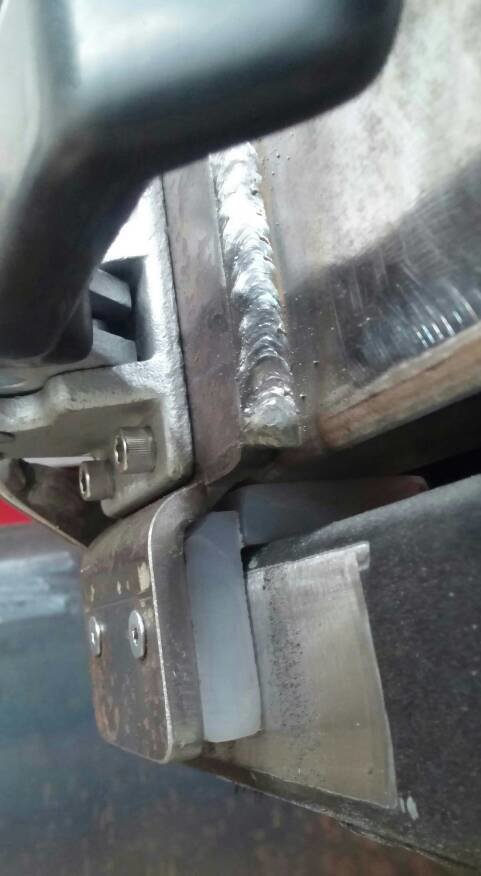

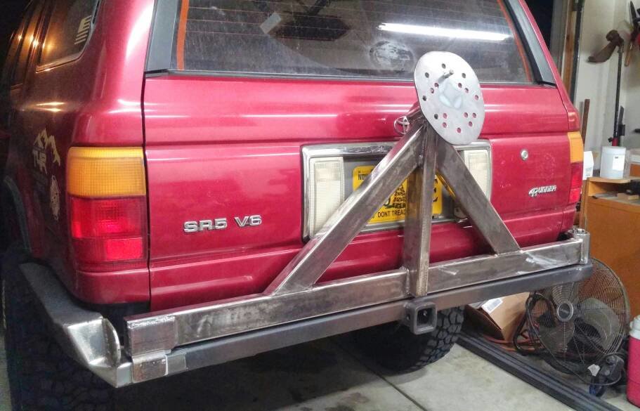

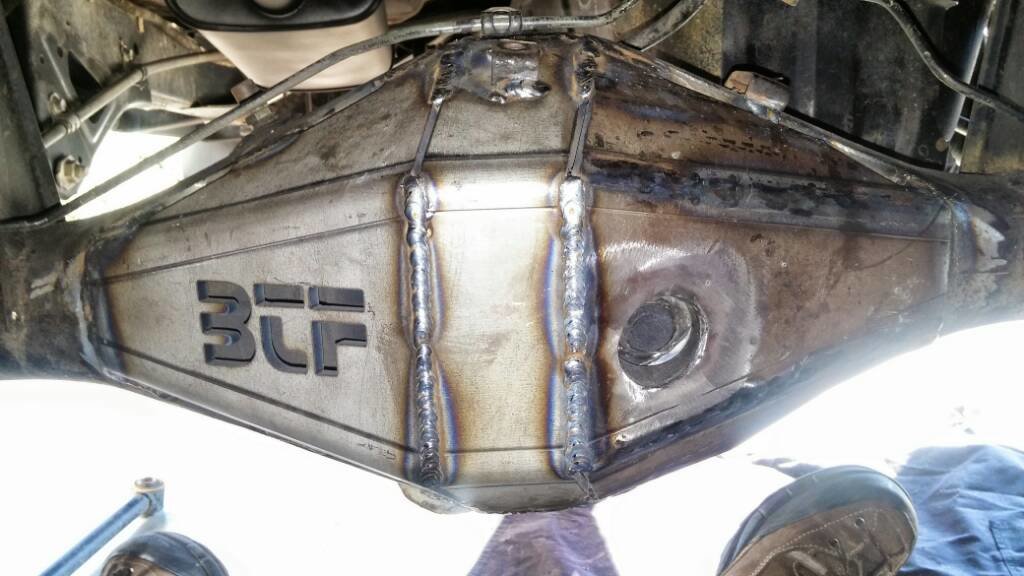

    Mad dash to get stuff accomplished this weekend...
    Rear diff guard installed.

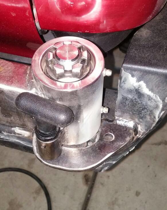

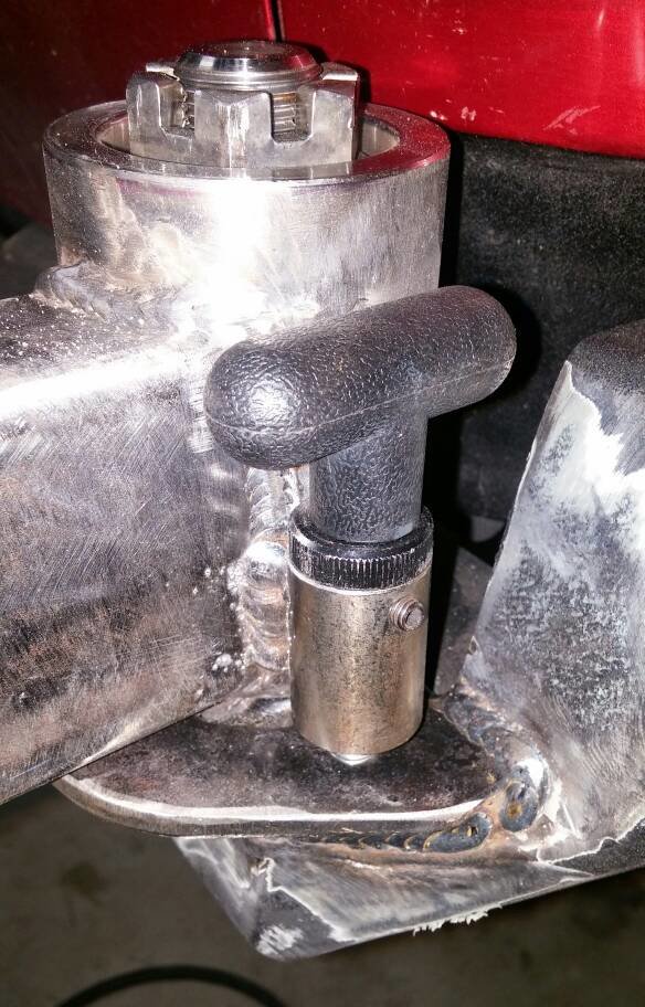

    More work on the swing out today as well. Down to drilling some holes for the latch and capping the end.

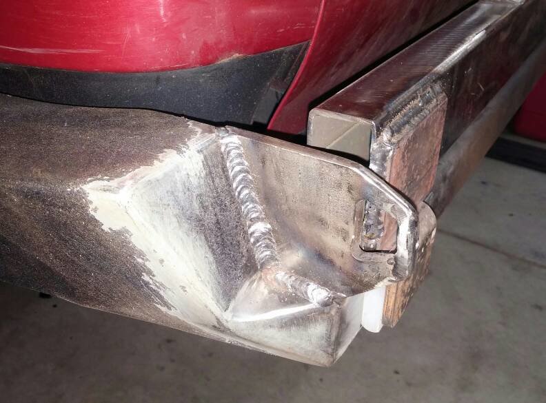

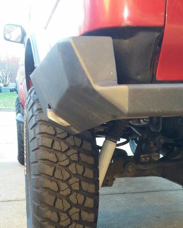

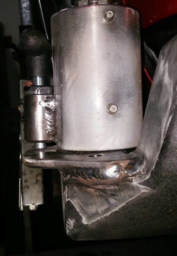

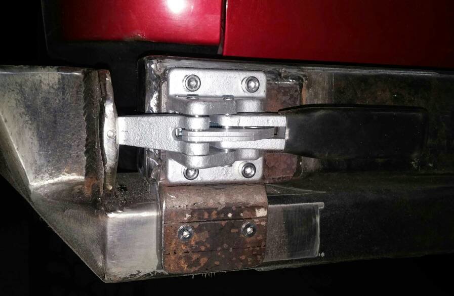

    More rear bumper work... This thing is close to done. Needs water/fuel can mounts, rear lights wired up and a license plate holder then some paint.
    Latch side

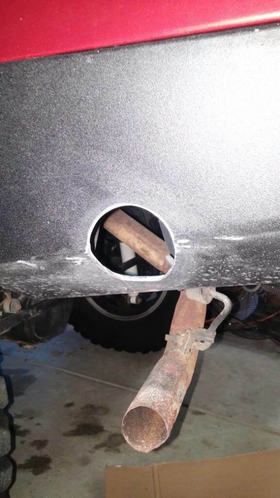

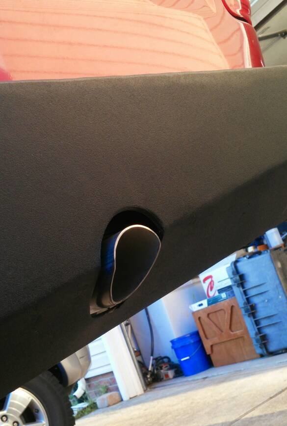

    Almost forgot to share this... Removed the stock exhaust and had a new system put in. Tucked it up nice and high and exit out the bumper side cap.
    The hole after I built up enough courage to cut my brand new bumper
    Since these pics I have painted the exhaust and tail pipe with 1200F Header paint. Seems to be holding up fairly well.

    Very cool, you have add some unique touches, really like the latch system you can up with.

    That's the whole reason I enjoy doing it myself... Well, that and the fact that only a couple companies make plate bumpers for this Gen 4Runner. I took a lot of little things I like about others and put them all together.

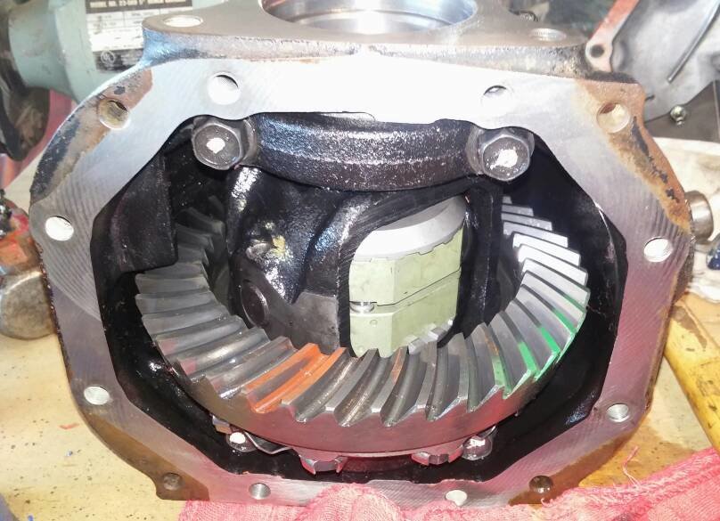

    Installed a Spartan locker in the front

    Holy cow your t4r is comin along nicely! How difficult was that spartan install? Do you happen to drive a silver 2nd gen taco too?

    Besides the carrier, that diff housing is completely different from mine. Glad to see that you got it done though

    The Spartan was pretty easy... Hardest part was taking out the front diff. Taking that ADD housing off the diff sucked too because of those stupid torx head fasteners.

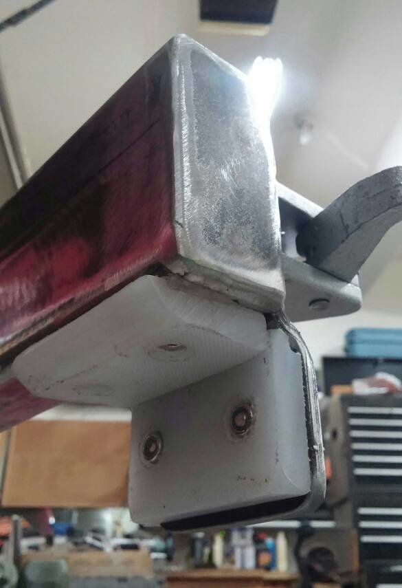

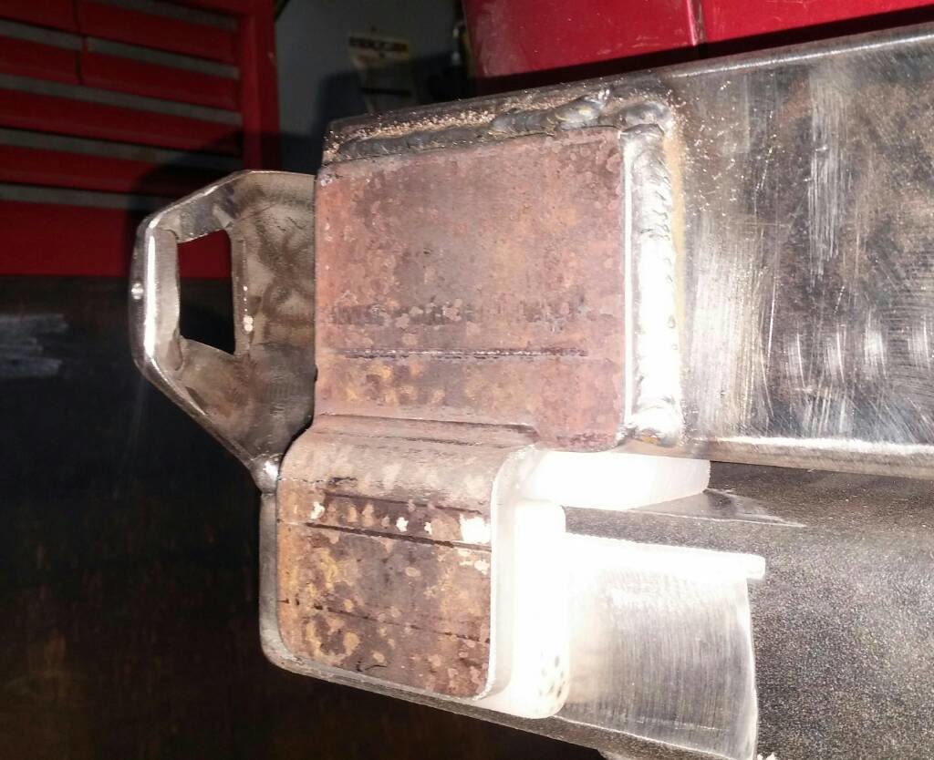

    Are you sure you didn't get that latch, stop and pin design somewhere?:rolleyes:

    Not sure what you're getting at here... However, like I said in the post you quoted me on, "I took a lot of little things I like about others and put them all together."
    Now, I have not seen any others attaching chunks of phenolic to their stops. Most will do metal to metal or some will have a thin strip of neoprene in between. The rub strip for downward force, yes, many others have done that.
    In the end though, what does it matter to you? I'm not stealing a proprietary design and calling it my own to reproduce in mass, for a profit.
    I built this bumper by myself, for myself. :cool:
