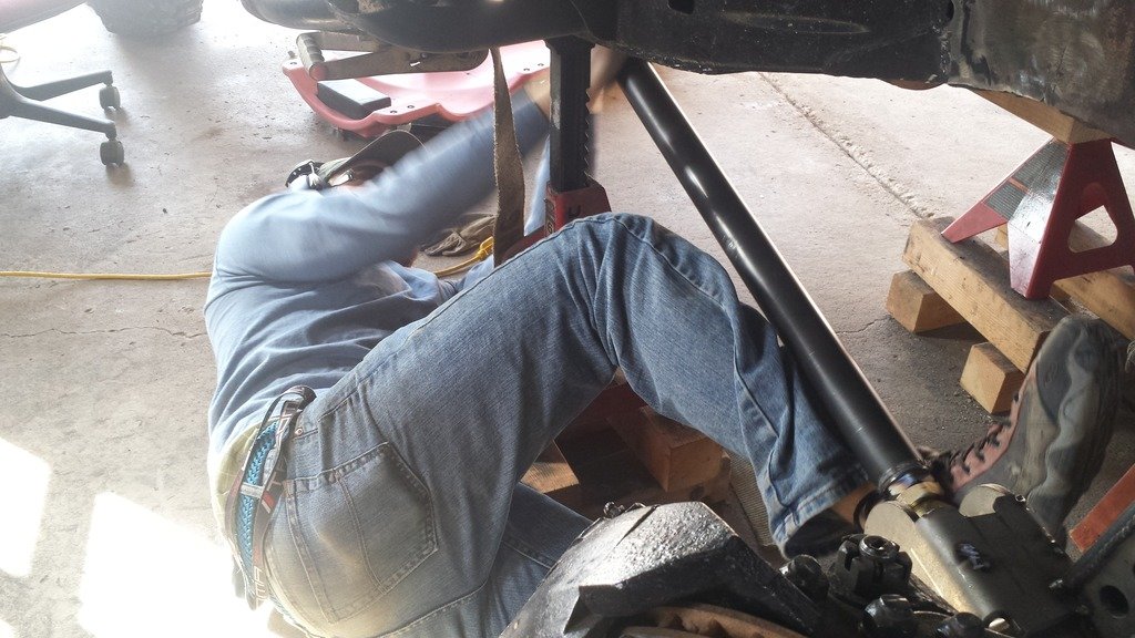

    Hey Monte, just wanted to give you a huge thank you for helping me out this weekend. Couldn't of gotten as far as we did without you man. It was nice meeting you. Thanks!
    Also,
    Installing links like a bad ass.

    Jon, welding in his most favorite position..After he did this, he said “See, this is why I cut the floor out.”
    When Jon starts thinking about cutting something you have to react quick to make sure nothing disappears from the body of the truck..haha
