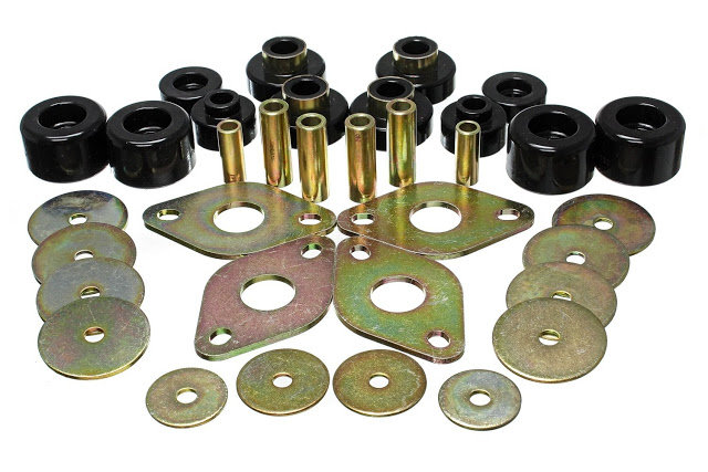

    Yesterday I placed an order for Energy Suspension Tacoma Body bushing kit, Part no. 8.4109G
    I can't wait, gonna have me some fun wrenching these puppies. :laugh: Gonna need a helper, I think.
    It will be great to get the old ones out, and cross another project off the list.
    There is a good install thread going on over here.
    EDIT: Add Tech info.
    This is for reference, there is an error in the diagram above though, radiator nut is not item #35. The correct part number for radiator nut is: 90177-A0010
    Item 30, Bolt, Radiator Support Mounting, 52217-04060, $7.84
    Item 36 Bolt, Front Mount, 52217-04040 $10.95
    Item 35 Nut, Mounting Bolt (3/Side) R 90177-A0012 $1.21
    Item 37 Bolt, Cushion (4/Side) 90080-11377 $1.21
    Item 38 Cushion, Front Cab Mounting Extended Cab 52203-04101 $69.99
    Item 40 Bolt, Rear Mount 52217-04050 $10.95
    Item 41 Cushion, Rear Cab Mounting Extended Cab 52205-04141 $69.99
    Note to self: 45 ft.lb for frame bracket bolts, and 34 ft.lb for cab mount bolt / nut.

    There were noises reported with them, but it turns out people were dramatically over tightining them by as much as 2.5x!

    You're gonna love those once they're on. I changed mine and immediately noticed a dramatic reduction in higher frequency vibration. Just be sure to use your PTFE grease on any of the metal/poly interfaces.
    Side note: I had to buy a new set of mount hardware because I was sleep deprived and torqued one to 90 when I thought I had 40 dialed in. Snapped the bolt after the nut tried to pull itself through the washer... Lesson learned.

    Thanks for the tips. Your post prompted me to go look up the part numbers for the non-reusable nuts on the body mount bolts. Turns out they are the same as the radiator bushing bolts.
    If Toyota only knew how many times I reused the radiator bushing bolt nuts, they'd probably :goingcrazy:
    Post above updated with diagram, parts, prices, etc.
