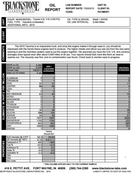

    A little old, but this is my 5K UOA from a few months ago.

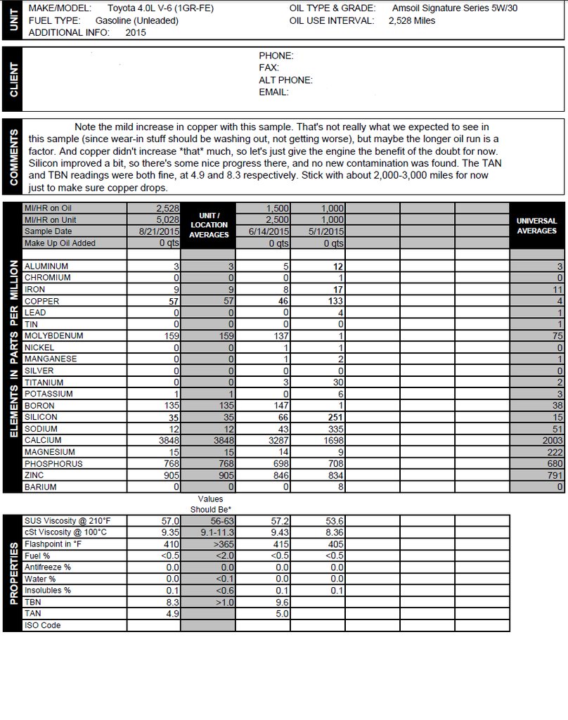

    Here's the latest on mine...I have been doing them very frequently, including the initial factory fill, just because I am curious how long the break-in process takes.

    Are you taking samples without doing a full drain and fill? If so, how are you taking the samples?
    Edit: Never mind. After reading your report in more detail I see your doing a full oil change.

    Yes - doing a full oil and filter change after the sample is taken. I am changing it out frequently during the break-in process to get the break-in remnants and traces of factory fill oil out. Beginning with the current fill, I will now be doing 5K intervals.
    I extract the sample by inserting a plastic tube down the dipstick tube and using a handheld pump to pull the sample into the container. I'm currently using Mobil M1-209 filters. I'm hoping the levels of copper and silicon will come down. I suspect the copper is coming from the oil cooler under the oil filter.

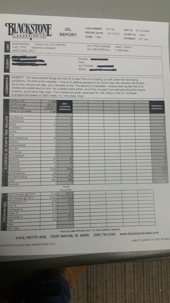

    Mobil 1 0W-40. Heavy towing in VERY hot conditions. 11,866 miles on the oil.

    I've read that 0-40W oil comes from good base. It's just too heavy of an oil to use for daily driving. The mustang guys use this weight on their V8's for drag and track.

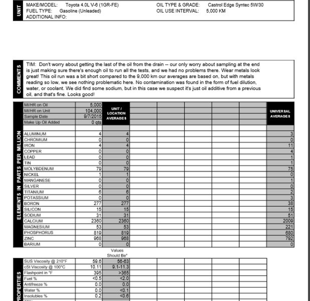

    from about a month ago, looked good :D

    jetty those #s look great for that many miles and the severe duty usage. I am surprised that with a TBN of 1.0, Blackstone says you can go another 2K miles. From what I have read, a 1.0 is when you want to change the oil, especially with your towing usage. Matter of fact, I would change the oil at 10K for a little large margin of error. What type oil filter you using? Thanks for sharing.

    Oops, my bad, I was looking at the averages column. Doh.

    I was using OEM oil and air filters.

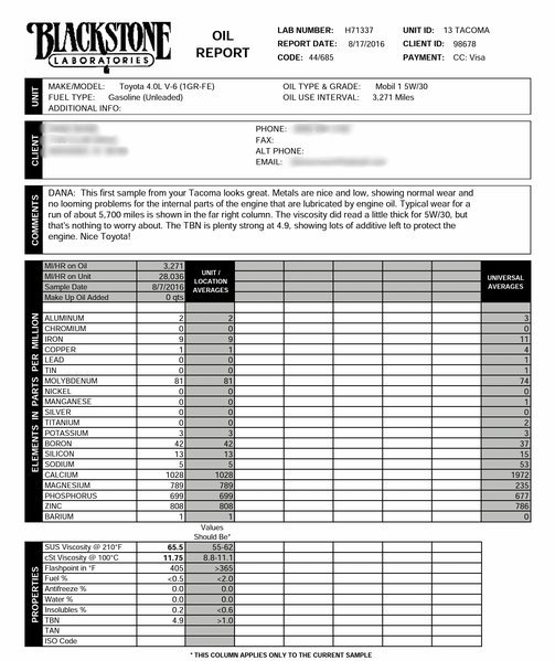

    My truck's first analysis. It's not an issue, but what would make the viscosity go up?
