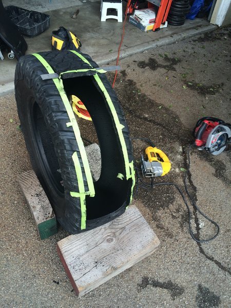

    I would be in. I don't have any junk tires or tools to cut one up.

    If Nick passes on them, ill take em.

    Helluva an idea. I have a shredded tire I can make one for myself with.

    You made a Ho Chi Minh sandal for your HiLift.
    And more rubber for your Ho Chi Minh sandals.
