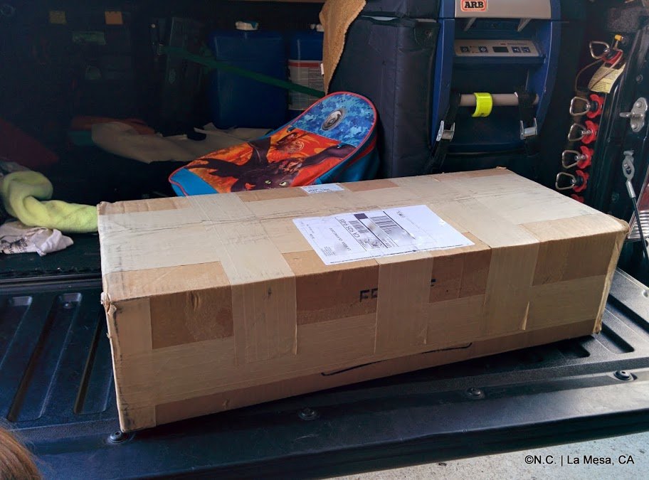

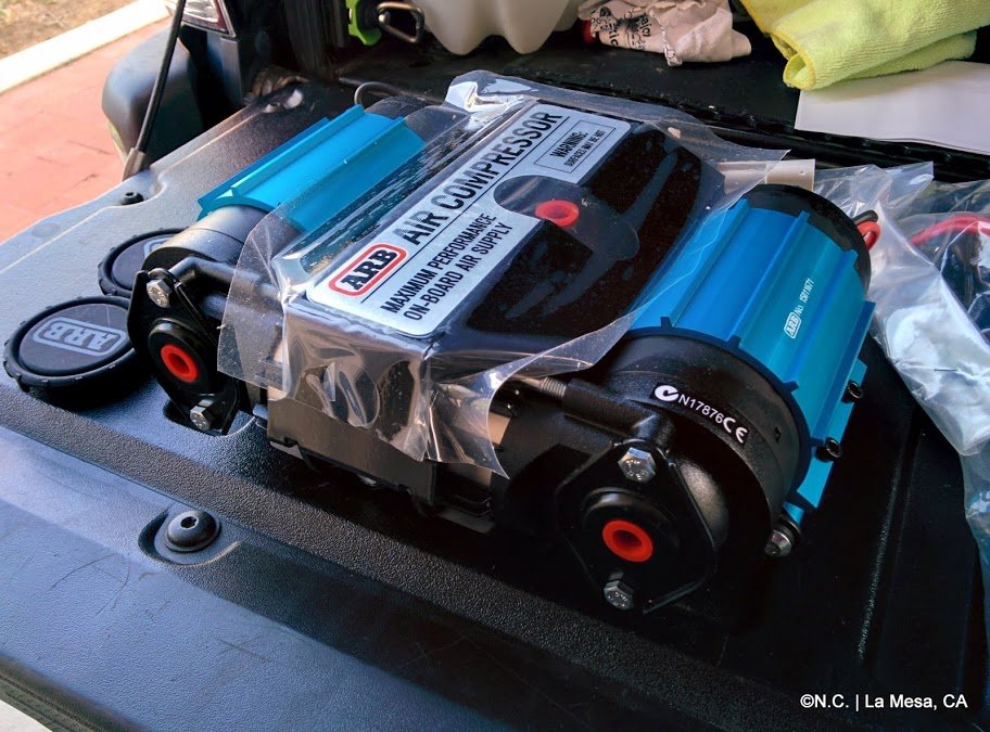

    Air Compressor shipping carton.
    Retail packaging

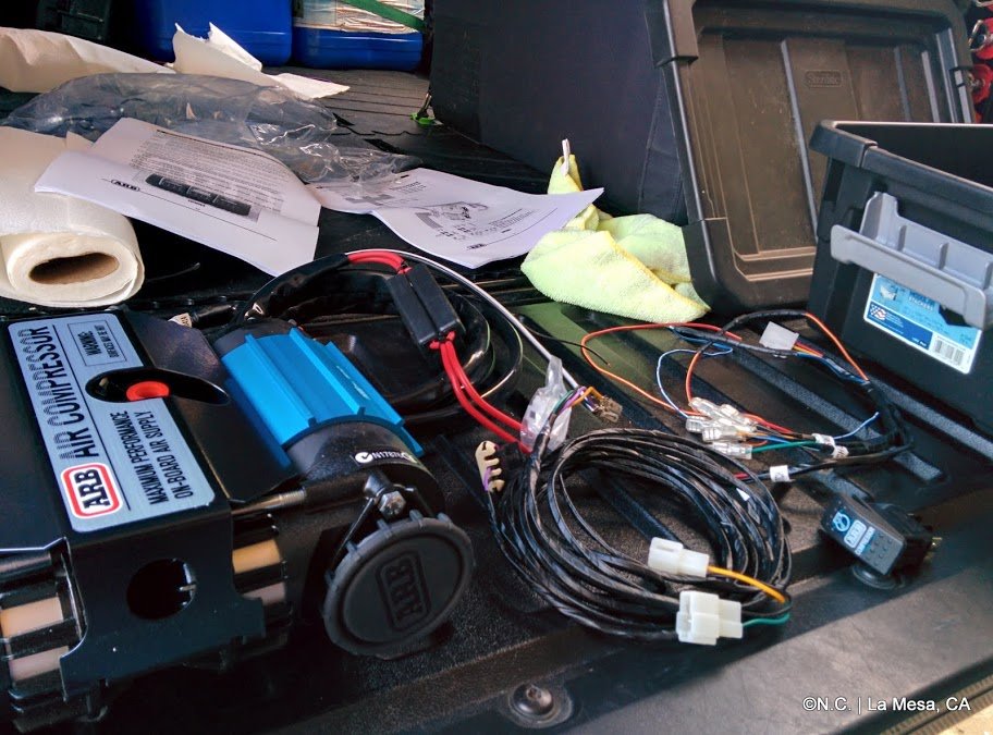

    Compressor

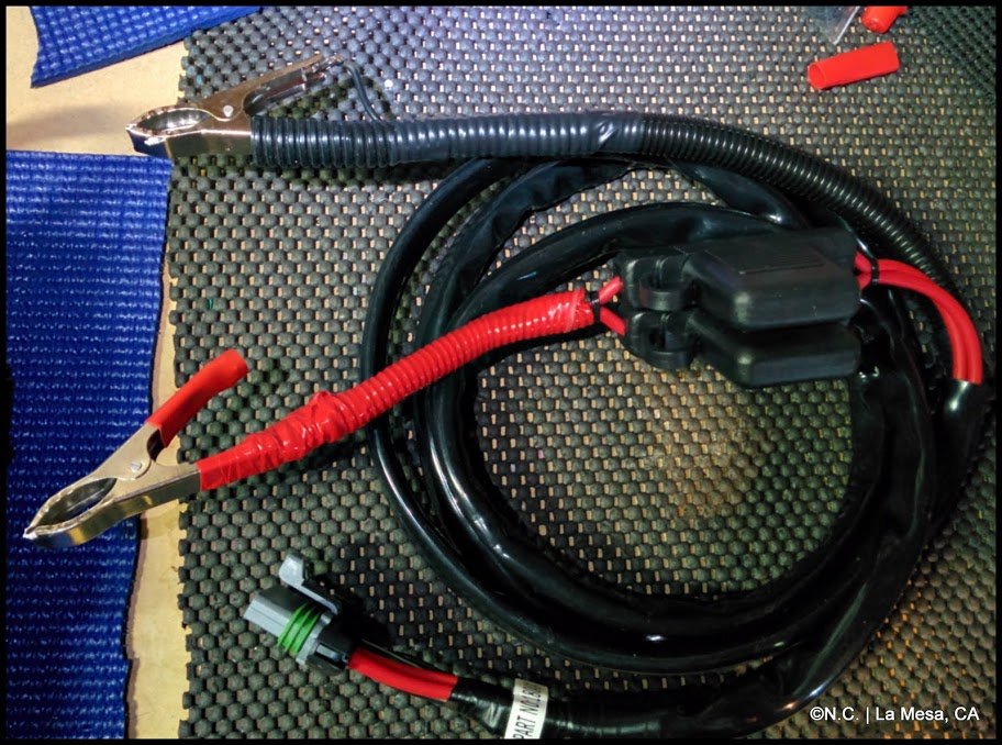

    ARB's crazy ass wiring harnesses with huge slow blow fuses, molex and other assorted DC connectors and rocker switch.

    Getting down to business,

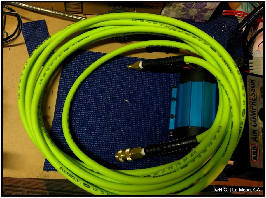

    Installed some Milton V fittings on an air hose. 25' 1/4"

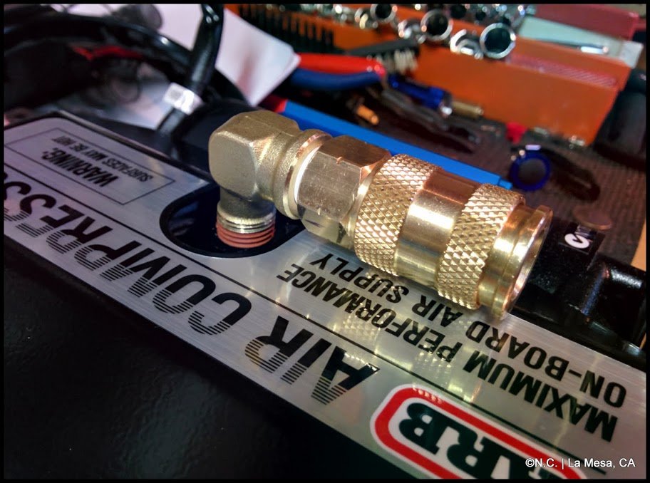

    I installed a Milton quick connect fitting into a street elbow and then installed the assembly into the manifold. Everything is 1/4" NPT fittings.
    Built a power harness. Soldered and crimped some clamps onto the power harness, used some 2" deck screws for strain relief, dressed with split loom auto-grade vinyl electrical tape.

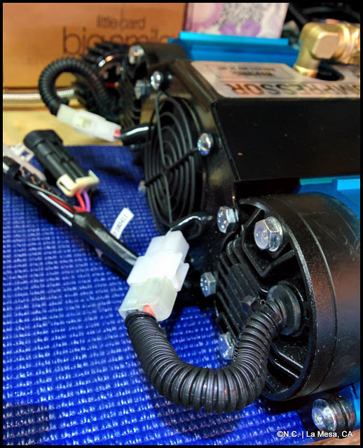

    I also installed some split loom on the power leads of each compressor to make it look better and protect it better.
    The second to last step will be to install a piece of jumper wire to make the compressor ON all the time, hillbilly--yes, but it will work just fine until I can do phase 2 hard mount. :D Remember this thing has an internal pressure switch for 150 PSI, so when the air hose is plugged in and compressor running it will pressurize the hose to 150PSI and STOP. :)
    Tonight it goes into a case.

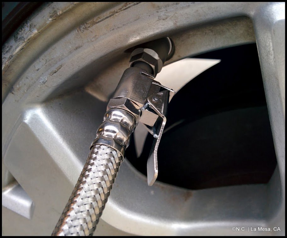

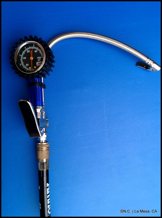

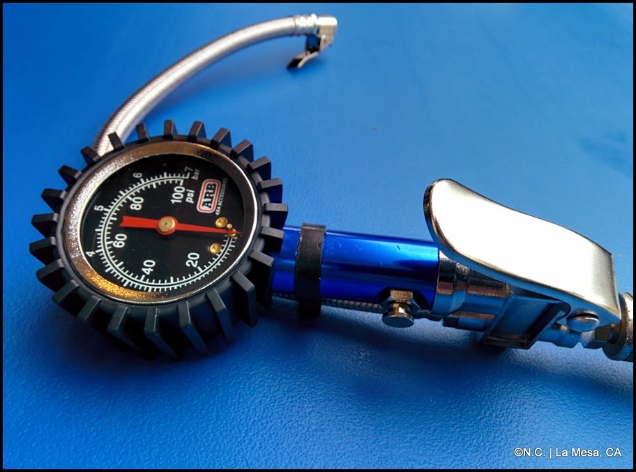

    For $30, I also picked up the ARB tire inflator with gauge. I'm not crazy about it, but it seems decent enough. Holds pressure, zero air leaks. Gauge seems to be about 1 PSI off at 40. It has a release button which can let air out of the tires, which is nice. Made overseas, comes with 2-year warranty.
    Holds nice and firm on the valve stem, no leaks, easy to attach / detach.
