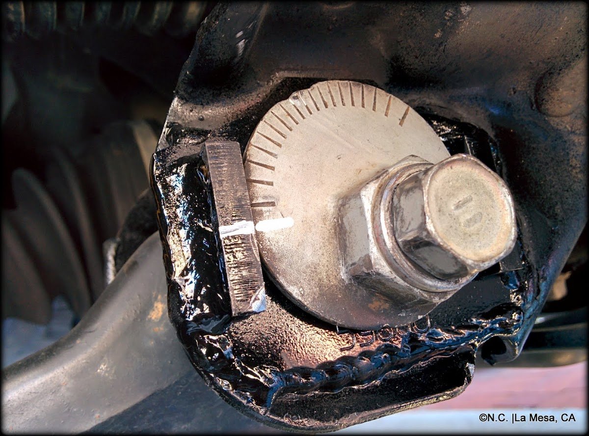

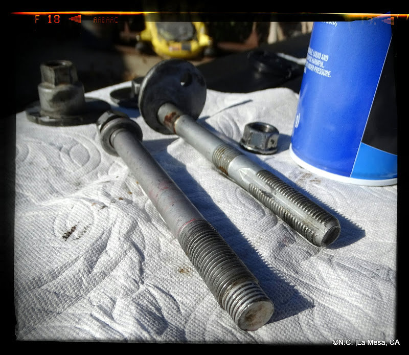

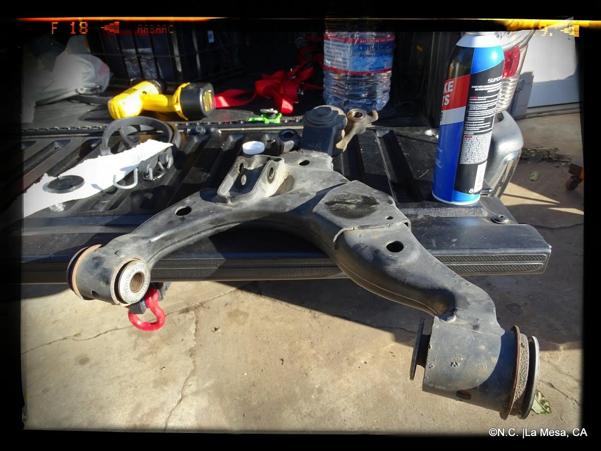

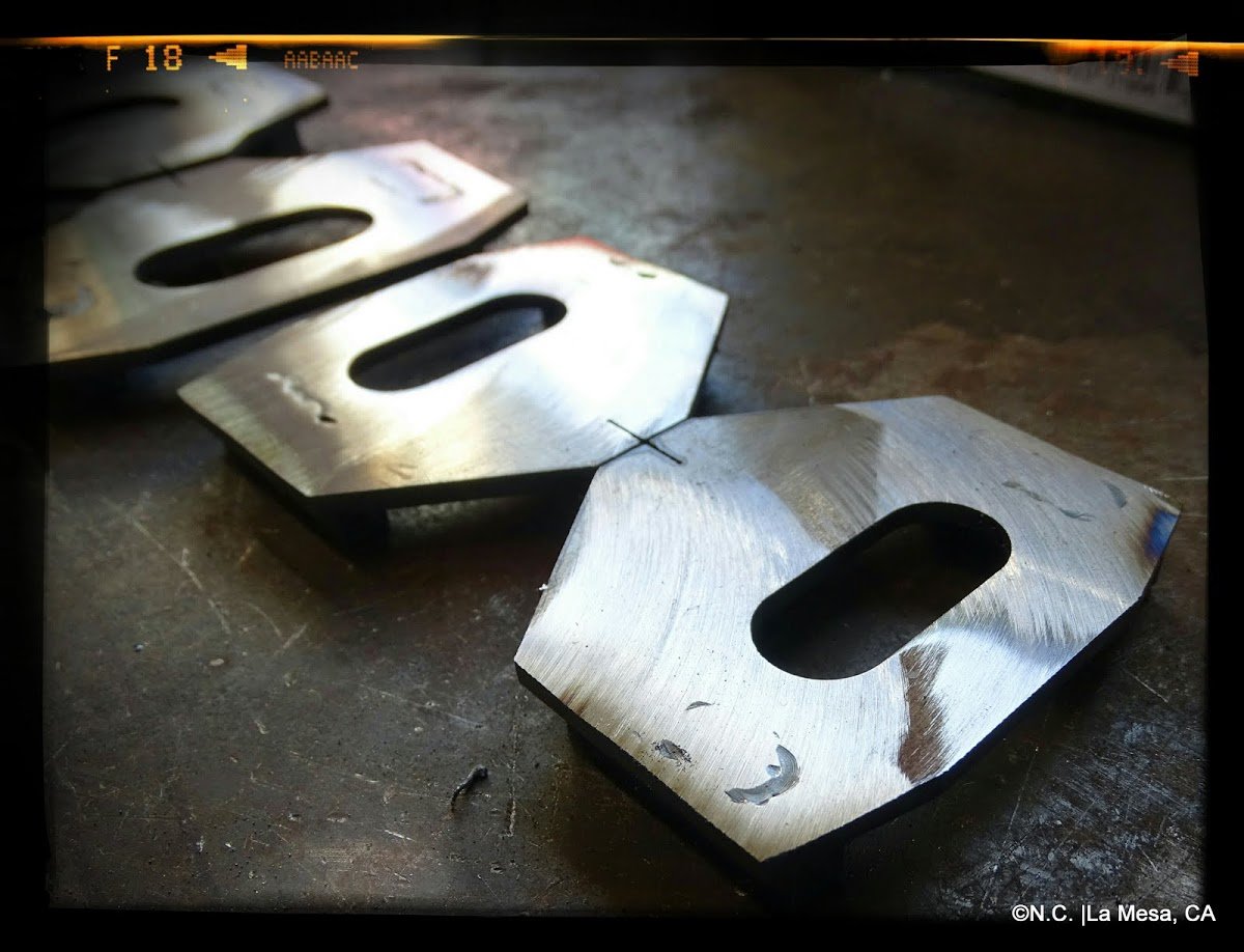

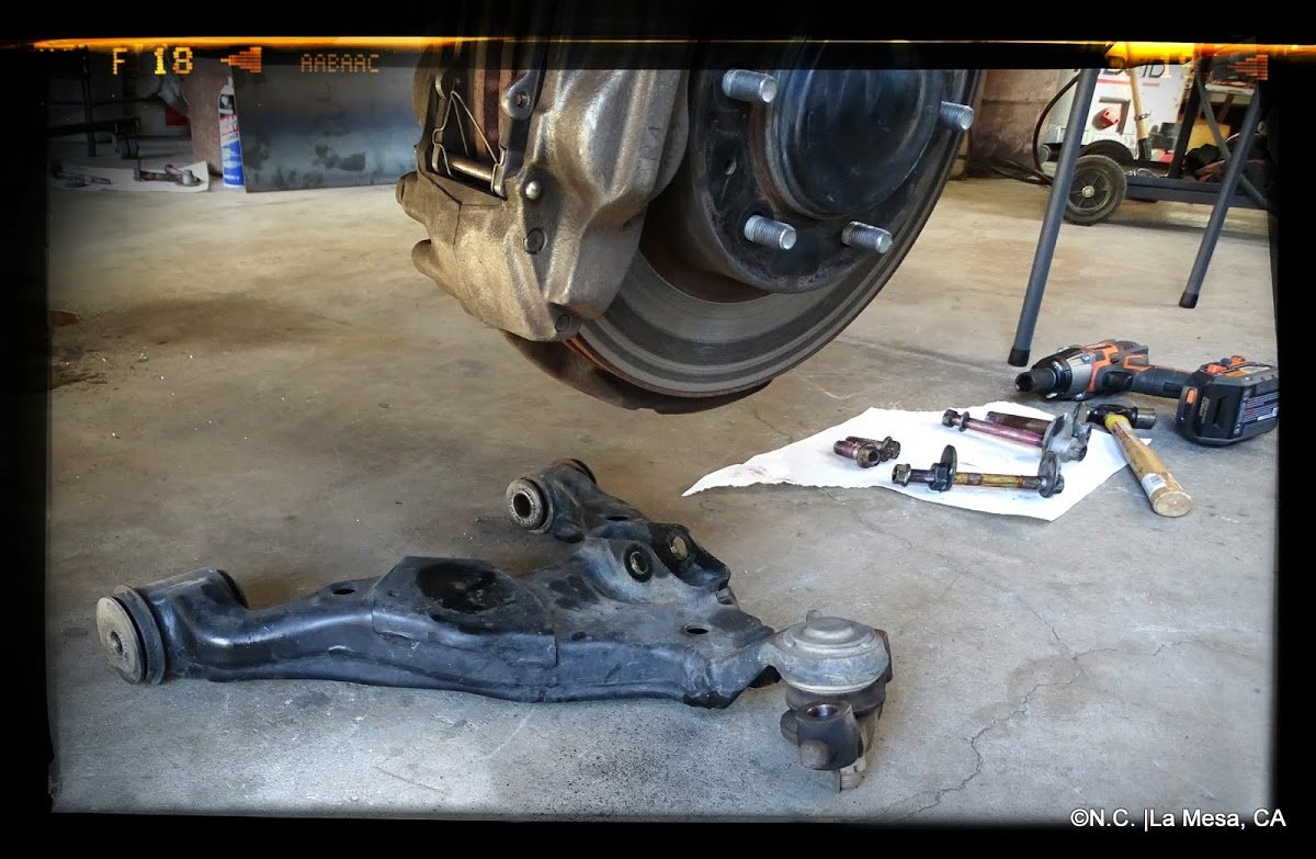

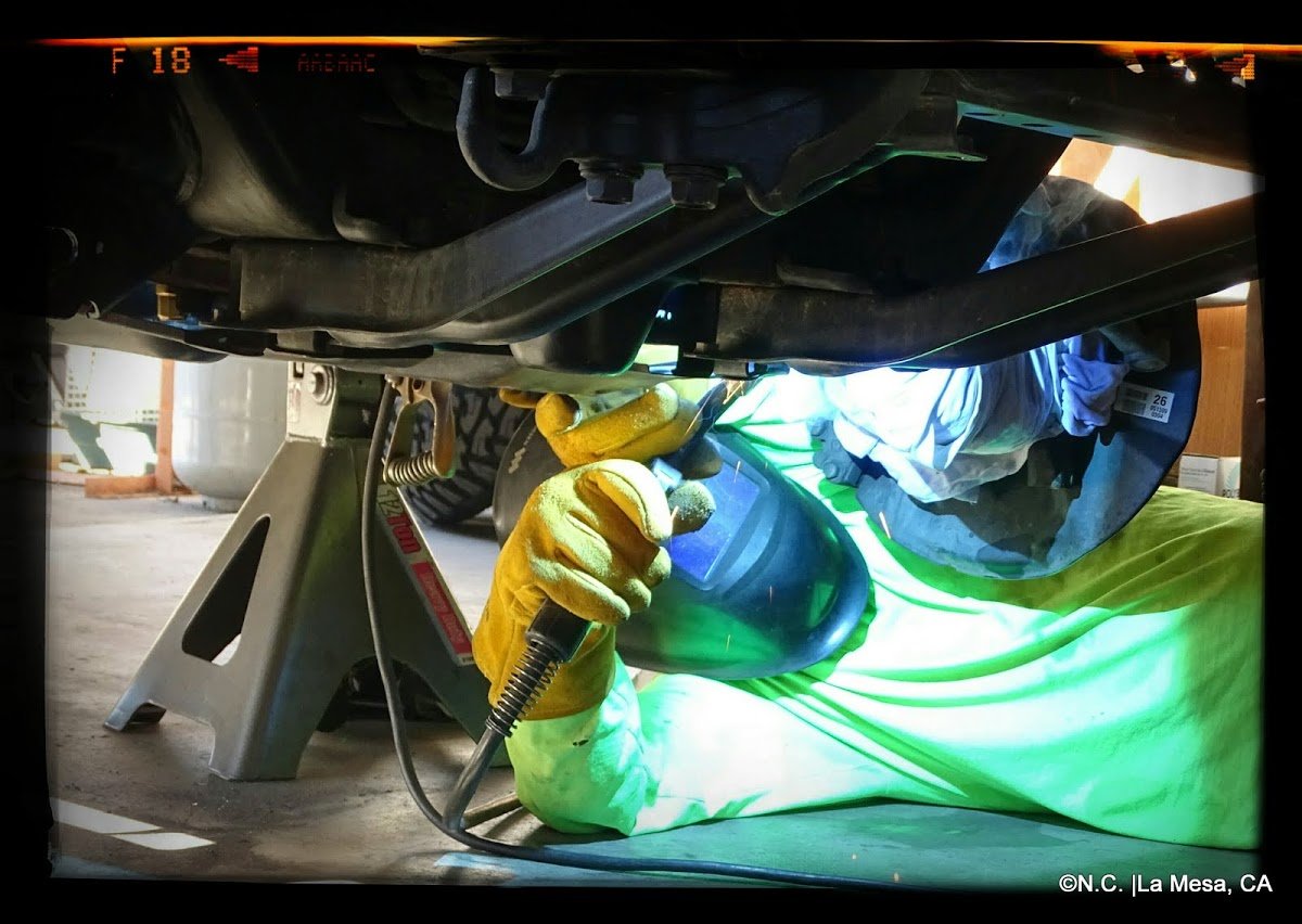

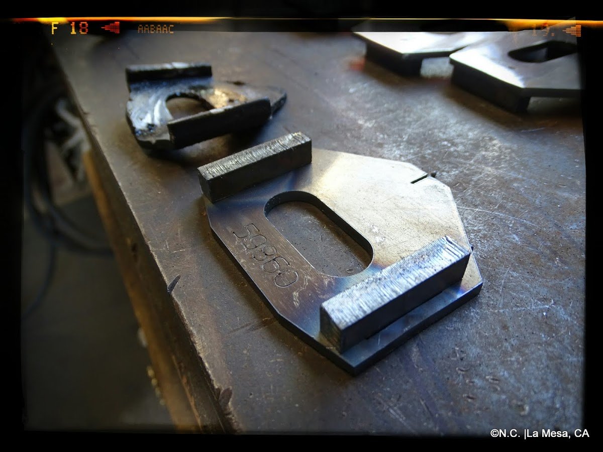

    The impact gun took apart the Tacoma like child's play. Took less than 5 minutes and LCA was on the floor. I cleaned the bolts and bushings, while Jeff @jeffz0rz chiseled off the factory tabs, cleaned and burned on the new TC cam tabs and then painted. Then i put back LCA. It was awesome working in tandem. The Firestone tech even came to me and complemented Jeff's work! Thank you Jeff!
    A couple notes.
    -I greased my bolts and cams 2 years ago this month. When I took them apart, they looked like they were greased yesterday!
    -I think all but one of the bushings now has the rust cancer. :D
    -I cleaned the bushings real well, used a 12 gauge shotgun brass brush and screw gun to clean bushings and reapply grease.
    I'm posting this mobile, so hopefully it looks okay.
    Jeff doing his thing. :cool:
    Clean bolts!
    Strike another project off the list! :)

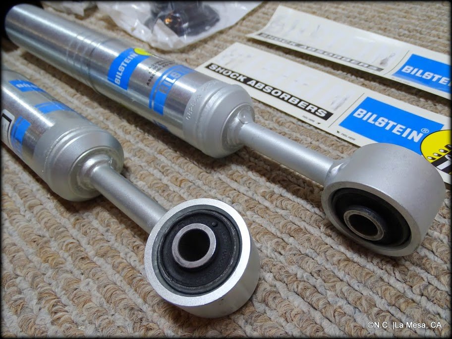

    The 5100's are here. Gonna put em on tomorrow. I will use the "normal" ride height setting, because the 885 OME coils provide about 2.5" of height increase over stock.
