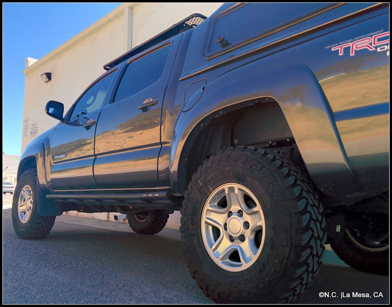

    They look great! These wheels are 7.5 or 8in wide? I thought I read that they were 4.5 bs can't remember the width.

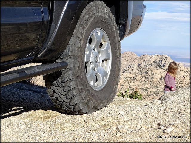

    Yes. I will get some for you. But to explain, I'm using a typical heavy duty rubber tarp strap. It goes around the ABS pipe, around the Yakima bars and then wraps around and secures behind the tarp strap itself with s-hooks. Similar to a hitch knot.
    The trap strap is backed up by stainless steel hose clamps. It's been on the truck for over 3-years, and only once did I have to maintenance it, and that was just tightening the screws on the hose clamps and squirting some thread locker into them.
    yes
    So wish I could have made it there this month. Wife and I had toyed with the idea of using this holiday weekend to go to DV, but decided to stay home and play around town instead. Kinda glad we did as we've been battling some really stubborn colds, thanks to my youngest kid. :rolleyes:
    Thank you. :)

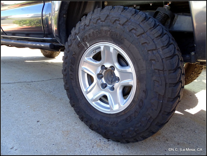

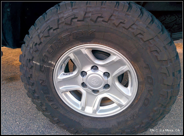

    The 4runner limited wheels are: 16" x 7" 4.5" BS. They moved the tire exactly 3/4" away from the frame, which was exactly what I needed in the front.

    Crom i gotta get caught up but what were u rubbing that made u swap to the 4 runner rims?

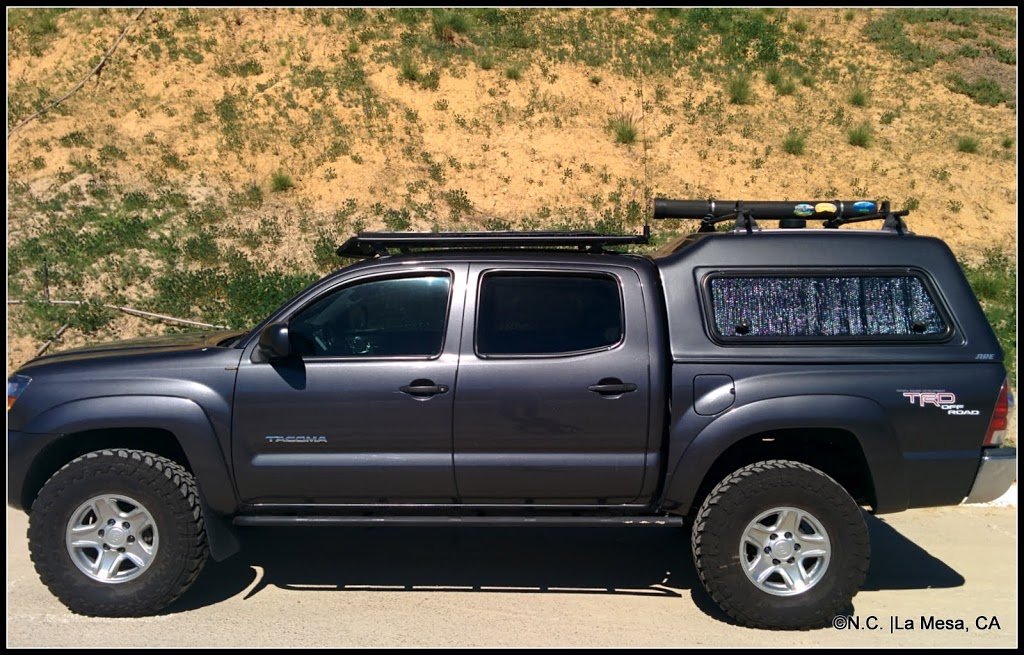

    All the work for the Toyo's I've had to do...
    • Moved to 4runner Limited wheels with 4.5 back spacing to solve: frame, LCA, and UCA rubbing.
    • I had to beat the pinch weld flat with a sledge hammer,
    • I had to cut back the mud flaps a lot,
    • I reformed the rear fender liner with a heat gun to make flat (after pinch weld was beat flat)
    • I also had to relocate the spare tire carrier back 1" to avoid the diff hitting the 255 spare under compression.
    • I had to install 1/4" bump stop spacers to stop rubbing tops of fender well under full compression.
    • Cab Mount Chop (CMC) Oct. 2016
    The 255/85/R16 Toyos are the largest in their size and to make them fit was a lot more work than I bargained for. But I am glad for it. They are a really tough tire and have performed really well off road and I'm quite happy with them.

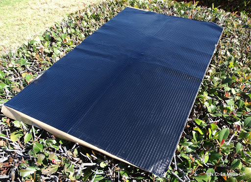

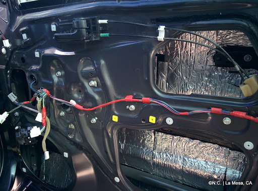

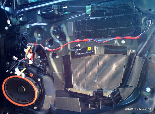

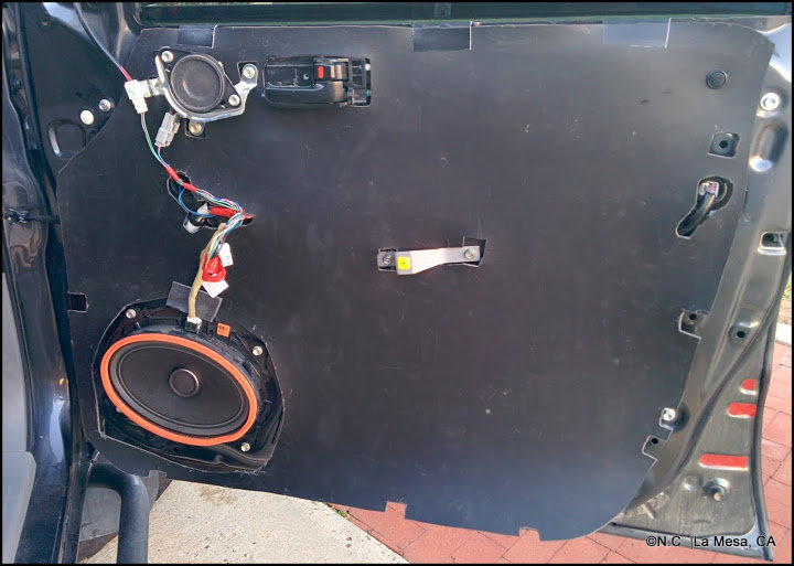

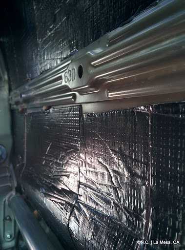

    Over the long holiday weekend, I managed to knock out another door for the Sound deadner project that I started in November 2015. This was the front passenger.
    I have six solid hours into this one door, and it's probably at least 6 pounds heavier! :laugh:
    I used a different sequence on this door.
    I used Noico black self-adhesive Foil & Butyl mat on the inside of the outer skin. It has a total density / weight of 0.65 lbs / 1 sq ft. :)
    I put it in the sun so it gets hot and malleable.
    Cut to fit, and pressed into place on the inside the outer door skin.
    Then covered the mat with the Frost King vinyl duct insulation stuff! :thumbsup:
    Outer skin done.
    Inner skin got sealed up, filled the holes with HDPE like this, then some deadner mat, and foam applied.
    And finally, a layer of 1/8" mass loaded vinyl (MLV).
    There are a lot of details that went into this that I'm leaving out, but for those that know, it's a shit ton of work. I also greased the square nuts in the window track and the gears for the window lift motor.
    I was smart about it and I took my MLV template, traced it out, copied it, and cut one for the drivers side. I did the same for the polypropylene filler plates I made. This will probably save me 2 hours or more on the driver side door.
    Link to my Front Passenger Door, Feb 2016
    Link to my pics for the first back door, Nov 2015
    Link to pics of my back doors: Sound proof second back door, Nov 2015
    Link to pics of how I make filler plates from cheap HDPE plastic.
    Link to Sound proof the roof, ceiling, Mar 2016
    Link to post explaining strategy, theory, and my mentor here.
    Project parts list, and prices here.

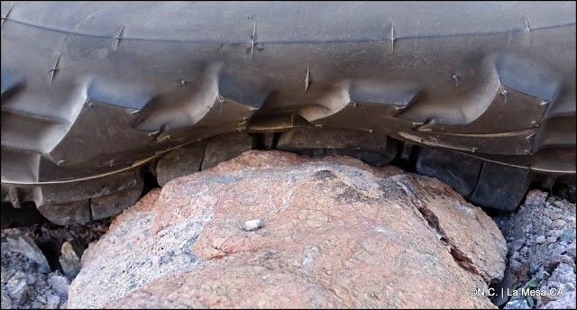

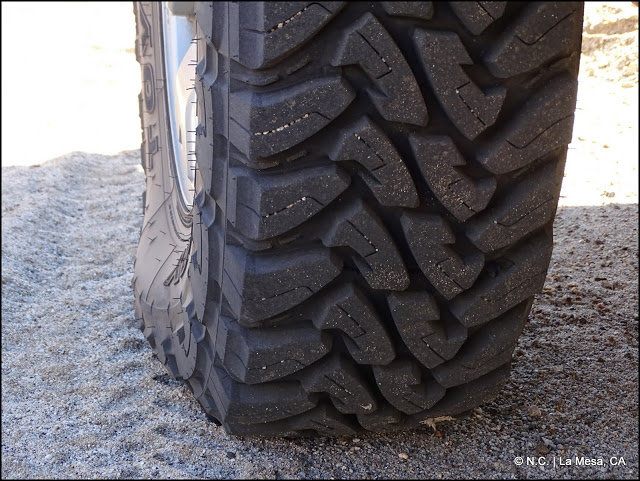

    Thanks! You are welcome. ;) It should be noted though, that apparently this only happens with the big Toyo's. They are 33.5" tall. The Cooper ST MAXX, and other tire manufacturers in the same size, are slightly smaller and do no rub like the Toyo's. I did not know that when I purchased. I found out the hard way. ;)
    Thanks. I've been running them since August. All I did this weekend was swap the newish tires over to the 4runner wheels. The Toyo's are 255/85/R16. The tire casing (sidewalls) are 3-ply polyester. And as of right now, they are wicked tough.

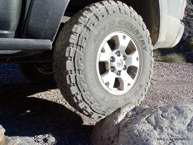

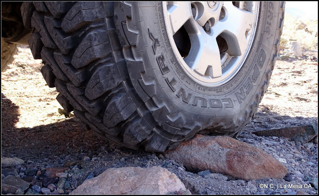

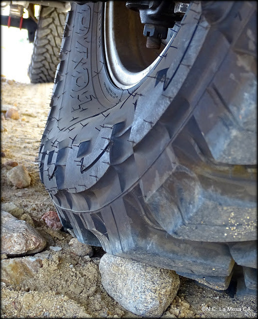

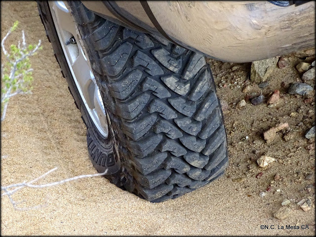

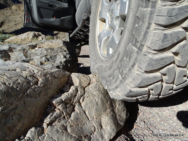

    Here is a small collection of photos of the tires at various pressures.
    12 PSI
    15 PSI
    @ 15 PSI and 40° angle!
    DSC02670%252520-%252520Copy%252520-%2525_bbe0b5103558dc9d3c95eeed221b3db6dfc0ad8c.jpg
    19 PSI
    19 PSI
    19 PSI
    19 PSI
    Thanks. The 5-star design is a classic in my book. I do like the SCS F5's and If I needed an 8" wheel, it would probably be them... ;)

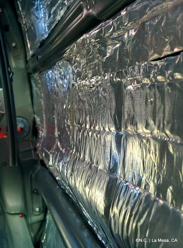

    I actually sound deadened my roof and back wall this weekend using Noico products (black foil and heat insulation). I can attest that it is a PITA, but well worth the effort. I've used dynamat before and application is the same. Lay it out and roll it on nice and tight., making sure to avoid air bubbles. The good thing with the foil backed deadener is that if you do manage to get air bubbles, you can pierce the foil and roll them out. It does not affect the product at all. I still need to do the doors, but my back shoulders were toast from rolling the deadener on overhead so that will wait a while.

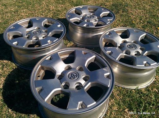

    Let me know if the stockers don't sell. Really only need two and am in no rush.
    This is an odd size, I know because that is what I run but in a Goodyear All-Terrain Adventure teflon. My friend and I have about two dozen trips to Death Valley alone and no issues for either of us.
