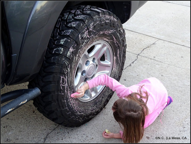

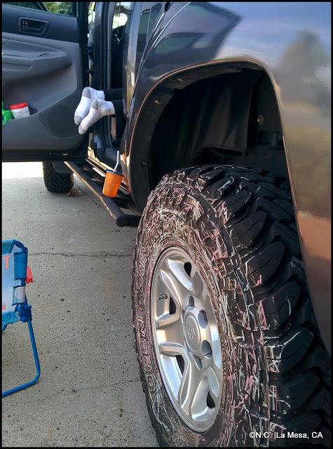

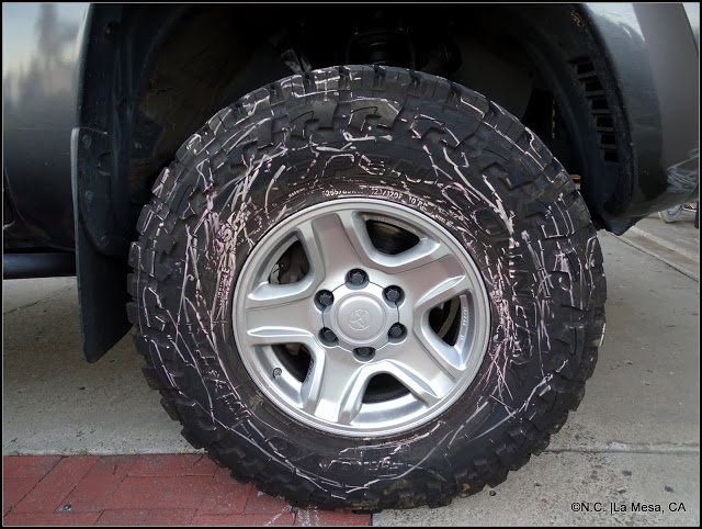

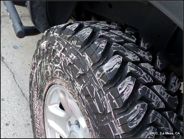

    The Calcium Carbonate Mod. :thumbsup:

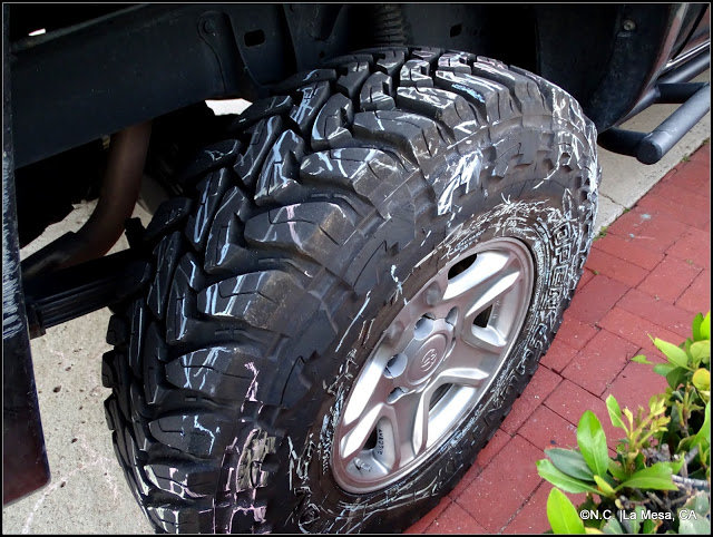

    She hit them all. No tire was spared. I've been driving around like this five days now. Chalk on sidewall has only faded a little. lol

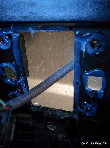

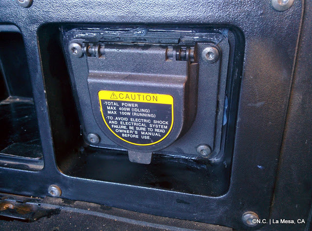

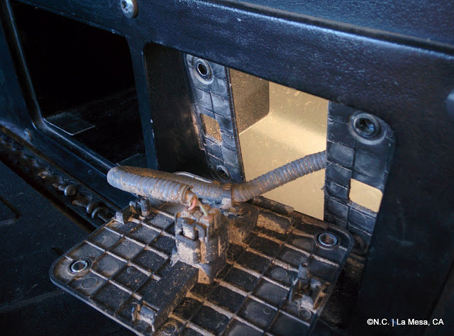

    Today my oldest daughter and I sealed up another pain-point-dust-intrusion offender in the truck.
    It's the inverter plug in the bed. The bracket, and the drain hole inside the plug door.
    Absolutely filthy. No wonder dust was coming in, nothing to stop it! lol
    Another fast fix with a tube of sillycone. :D
    If it gives me any further issues, I'll hit it from the back side with some flexible roofing sealant.
    Take that desert dust!!! :cool:

    I'm guessing a 5-10 year old daughter already chalk testing for even tire wear = Daddy win. Teach them early.
    Crom[QUOTED][OP] and Biscuits like this.

    Thanks. Yes, it was a chalk test. She is 5.5 years old. She is my wrenching partner and helper. Anything that isn't dangerous or involves chemicals, she is usually actively involved until she doesn't want to be. I think she has helped me on maybe 3/4 of the projects I've done. Whatever I'm doing, I try and turn it into a game for them and they like that. I have tons of hilarious pictures, and stories of them just having fun out in the front yard while I try and get stuff done.

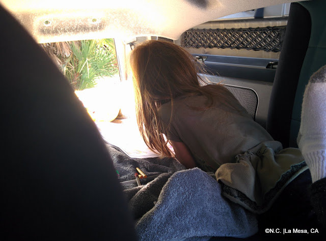

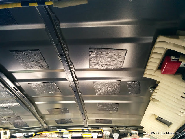

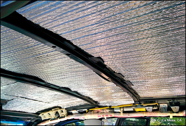

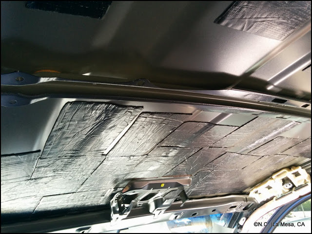

    Sound dampen roof is done.
    This is a four hour job. I followed @GHOST SHIP 's well written and sometimes humorous guide to removing the headliner in his Heat reduction in dark Tacomas's thread.
    The only thing I did different was, I was a cheater and didn't bother removing the B or C pillar interior panels. After all the headliner fasteners were out, I more or less just pried the headliner out around the edges and when I was all done I shimmied it back in. It worked, but I wouldn't want to do it again. lol
    I also had to make a strategic decision on materials. I didn't have enough of what I wanted to put in and had to improvise. I knew this going into it... Surprise chance to work on the truck, so work got done.:cool:
    For the front row of the roof I did 100% coverage with butyl mat (dense sound damper stuff), followed by Frost King Duct insulation.
    For the middle and back row of the roof I did scattered coverage with butyl mat, followed by some foam and a layer of Reflectix heat insulation.
    I felt this was a good compromise. The front of the roof (towards the windshield) is where most of the wind noise is generated from, so I wanted the best material I had for that. The second and third rows of roof, got some damper applied, which helps change the resonance of the panel, and it passed the knock test when I was done, so I'm satisfied there. The foam helps insulate and stop vibrations, and lastly, the Reflectix insulation can help insulate, and if it helps stop noise then that's a bonus too.
    The day stared off with me gathering tools, while the tires got another dose of chalk.
    I removed the sun visors, retention clips, grab handles, rear view mirror, and other related hardware. Daughter helped by collecting the hardware and running it to the back of the truck and placing it all on the tailgate. She was a great helper placing all the fasteners in a bag. I laughed at how she used one of the grab handles as a telephone.
    Front row of roof
    Middle and back rows.
    And finally after foam and reflectix layers applied.
    My daughter and I had fun together during this time. We played interactive games, told stories, played with radios, all while getting the work done.
    Difficult to see in this photo, but the headliner is lowered and propped up just above her head. She hung out in the back and liked her "cave" In this photo she is doing a great job with her coloring book. :)
    Also for anyone who was wondering, this red device at the rear of roof line is the trucks TPMS receiver.
    Toyota Part No. 89760-35021 FCC ID: HYQ13BCG, Made by Denso, in Japan
    I looked up the frequency of device, 314.98 MHz of the ISM radio band. I am such a geek!.
    After I finished installing the headliner, we had lunch, and went for a test drive. :mudding:
