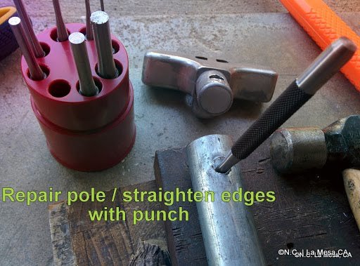

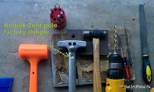

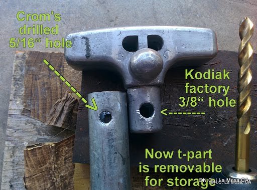

    I'm fine tuning some of my camp gear...
    Short story is I had to store two of my tent poles in the bed of my truck because they would not fit inside the ABS pipe on the roof rack. I have a system for it, but it was getting old and I wanted to remedy it to save time. So my solution was to mod two of the four Kodiak poles so they would fit in the ABS pipe.
    Inside the Kodiak tent t-bar pole. How to modify your tent T-poles
    I placed a call to Kodiak Canvas prior to modding my poles, they assured me I would succeed with common sense procedures. The poles are constructed out galvanized steel. The "T" part where the spring rods are inserted into is a cast part. At Kodiak's factory, during final assembly the T-part is inserted into the pole and a punch is used on both sides of pole to lock in the t-part. The T-part has a 3/8" hole drilled through the part. I used 5/6" drill bit to drill the dimple out and a little common sense and 15 minutes later I was done. Below is a write up on how to do it.
    Here is how to safely remove the dimple. I will now use quick release pins when I need to assemble my tent.
    1. Drill out each dimple with 5/16" drill bit. (two dimples per pole)
    2. Use screw driver or mini pry bar to pry up around the lip of old dimple.
    3. Use hands to twist, wiggle and a dead blow hammer to tap out T-part.
    4. Use punch to straighten bent edges.
    5. Clean up 5/16" hole with file.
    6. Chase new hole with 5/16" bit.
    7. Test fit T-Part into pole.
    8. Insert quick release pins to test t-part in pole.
    9. Done.

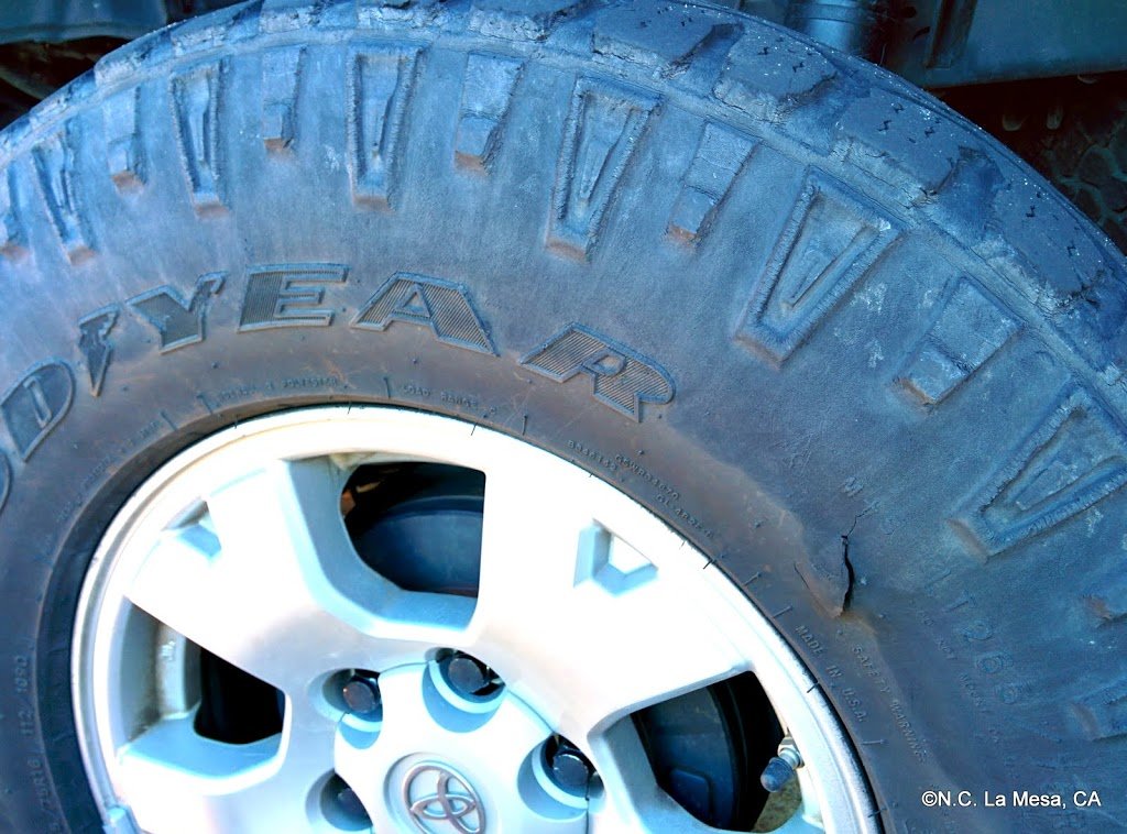

    My daughter was doing a tire inspection and noticed this new damage on the sidewall of the Duratrac.
    She probably saved our lives.

  14. Jul 25, 2015 at 7:26 AM

    See Build Thread
    No surprise! Duracraps strike again!
    ebbs15 and Crom[OP] like this.

    If that thing let go on the interstate at interstate speeds, I'm certain that we'd become a statistic, and a footnote in some tire failure study. F-that. I'm ordering new tires today and will be swapping that tire out today with an extra duratrac in the garage. :mad:

    No doubt, that's some scary stuff. Deep and big chunk there.

    Seeing that on the sidewall seems to lend to the general consensus that Duratracs have really thin Sidewalls that cut easily

    Absolutely. Of the five duratracs I've run on the truck, two are defective IMO.
    One has some pretty heavy torsional cracking around the sidewall lugs, I showed it to Discount tire and they said it's bad and they would give credit for the tire, and then this one with the chunk missing from sidewall.
