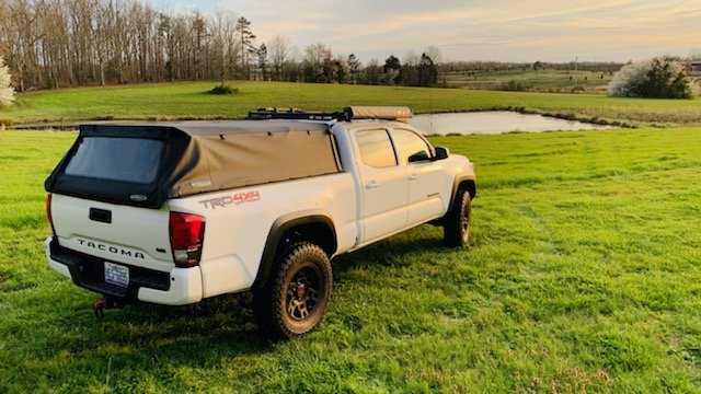

    Just purchased a new to me 2016 TRDOR and i love it. Seeing as how i have a little girl that loves the outdoors and me being the person i am..id like to get my tacoma to a point where i can access those out of the way campsites a little easier.
    Im 45min from Uwharrie. 5 hours from the outer banks and have quite a few more local areas that are accessible for camping and enjoying gods playground.
    So bear with me and fallow along. I will update as often as possible.
    The way she sits now as of 3-29-21
    Exterior
    ~ Victory 4X4 roof rack
    ~ TRD Pro wheels
    ~ TRD Pro skid plate
    ~ TRD Pro Grille
    ~ Cooper 255/80 ST MAXX
    ~ Arb Awning
    ~ SofTopper
    Suspension
    Eibach Pro Lift
    ~ 1" rear block
    ~ Wheelers U Bolt flip kit w/superbumps
    Interior
    ~ Weathertech mats
    ~ TRD Pro shift knob
    ~ Midland GMrS
    ~ Hondo Garage Unholy mount w/Ram X Grips. (x2)
    Recovery
    ARB snatch straps
    ~ ARB soft shackles
    ~ Receiver Shackle
    ~ Shovel

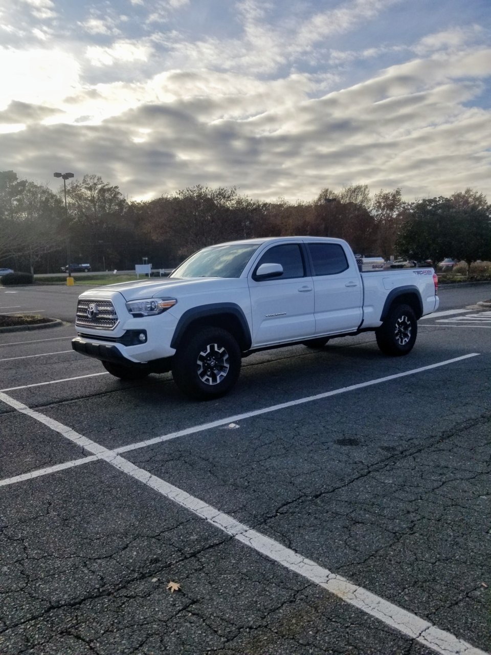

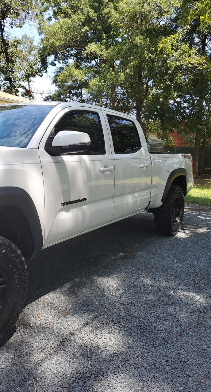

    20191113_172016~2.jpg This is how she sat the day i picked her up. Other than the running boards and a set of 265 70 Open Country A/T's she was all stock.
    Running boards have since been removed(free to a good home btw).
    WeatherTechs and a WeatherGuard box have been added recently. Next on the list is onboard air and a small leveling kit just to get rid of the rake.

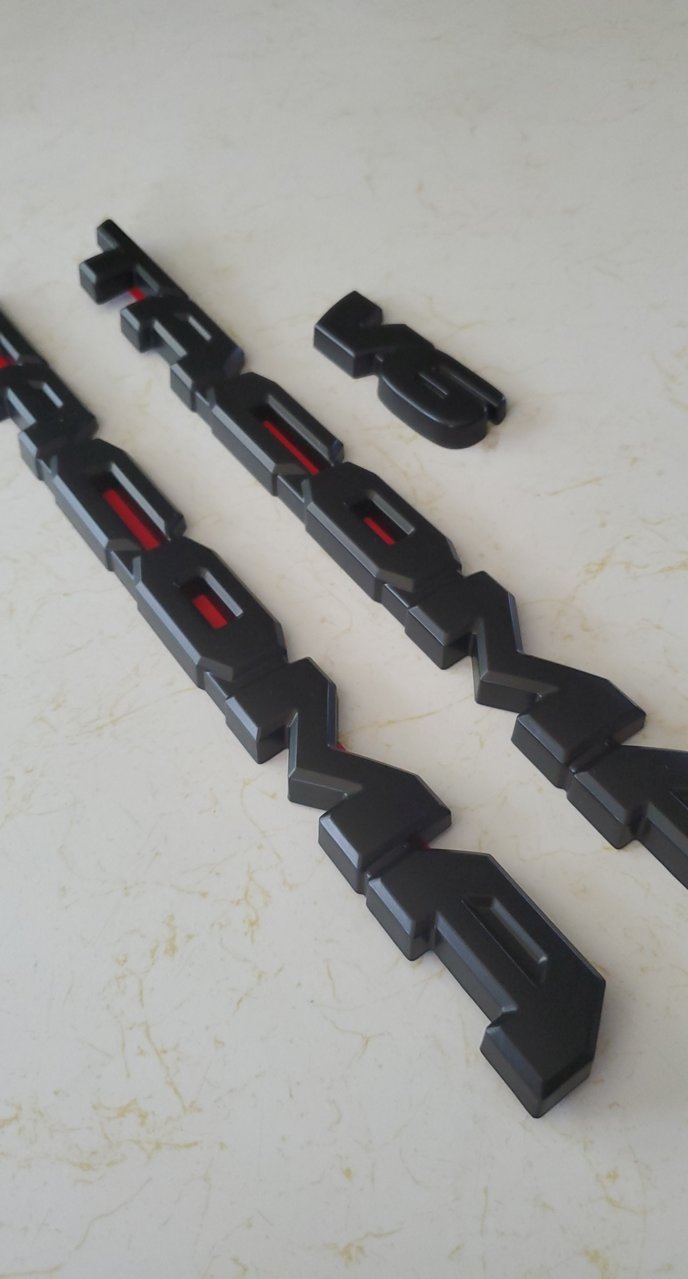

    20200607_125103~3.jpg 20200607_124915~2.jpg Its been a long time since ive updated my build thread.....a 4 year old little girl and a divorce will do that to you.
    Ive made a little progress since my last post.
    Added -
    Bed Mat
    Tailgate letter inserts
    Trd Pro skid plate
    Trd pro grill.

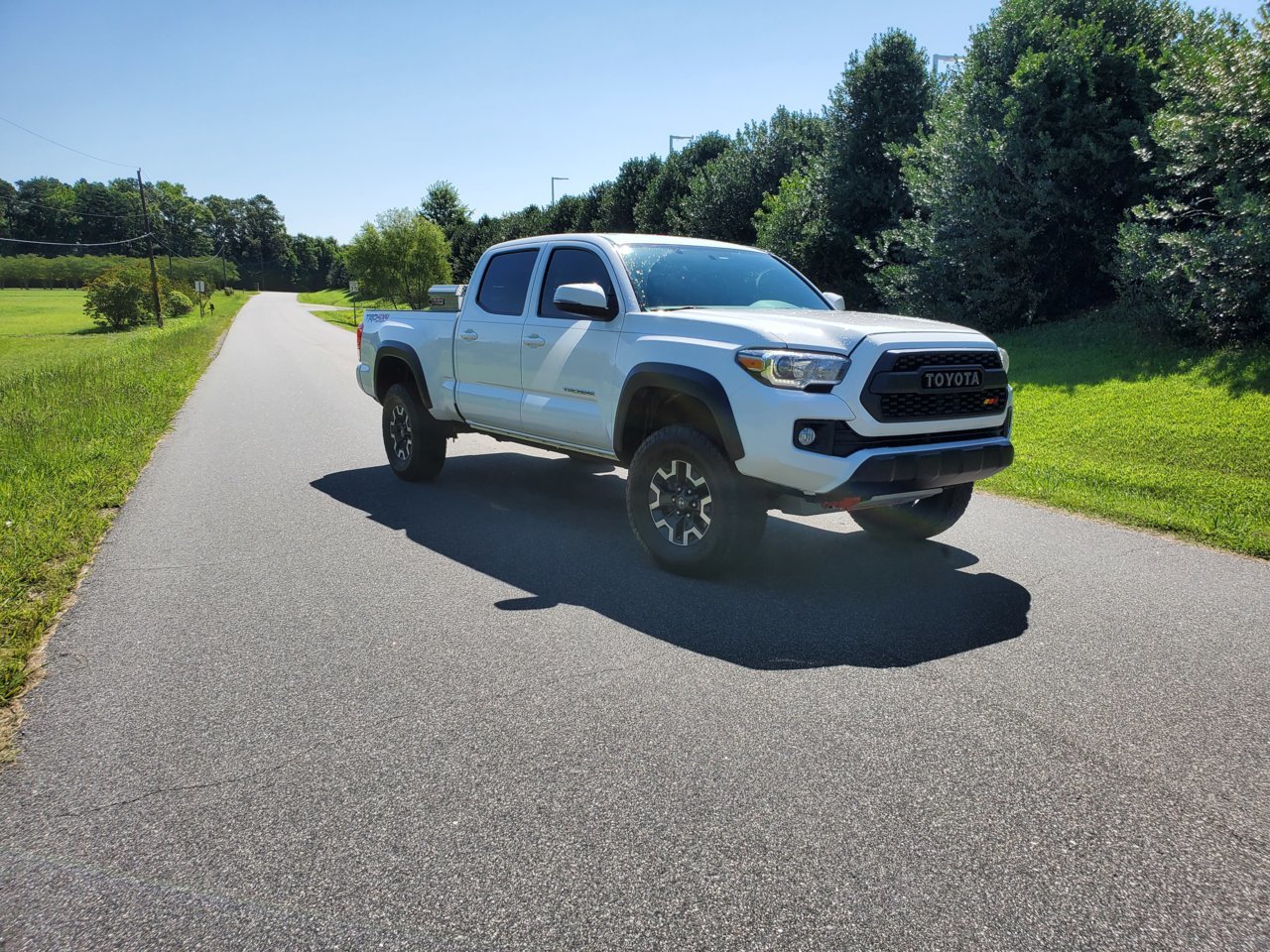

    Snapchat-1972092590.jpg in other news we have added a 2019 TRD Off Road t4r to the stable.

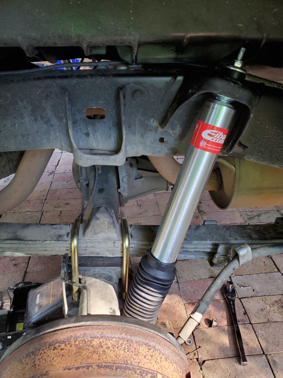

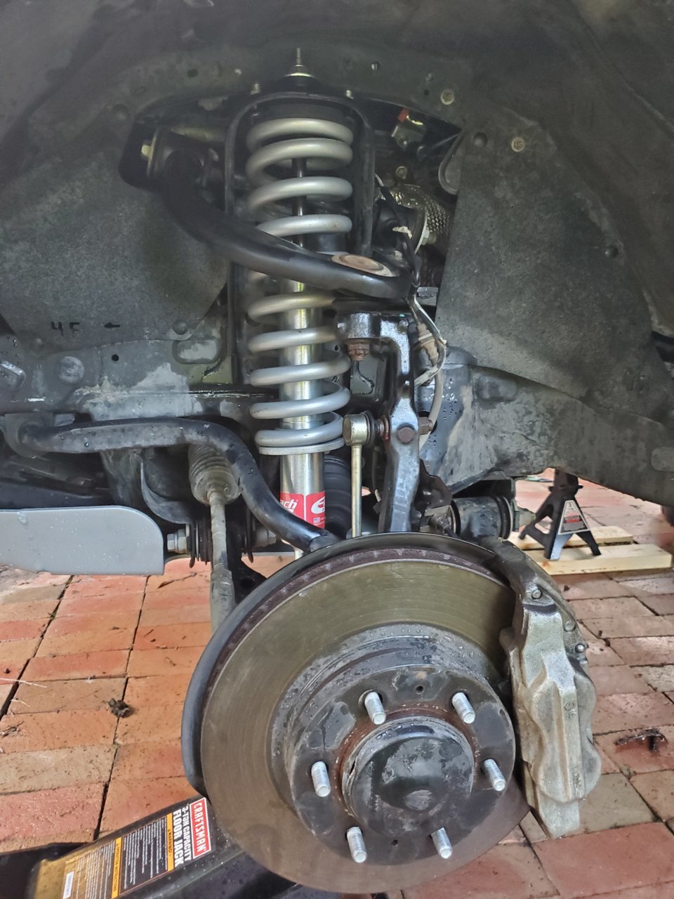

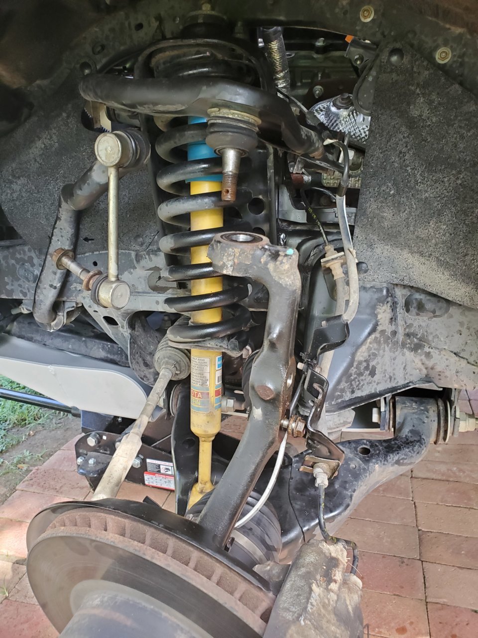

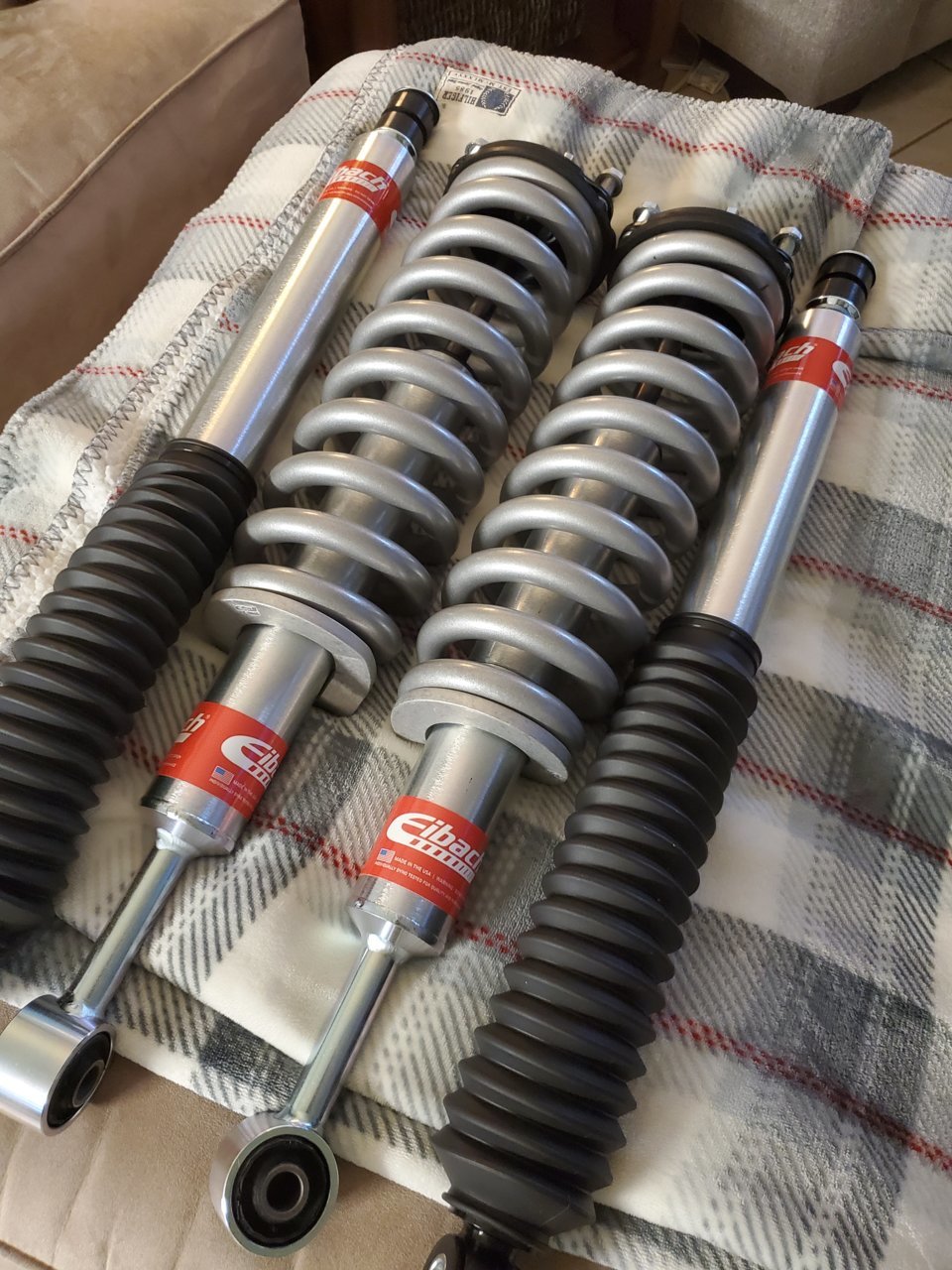

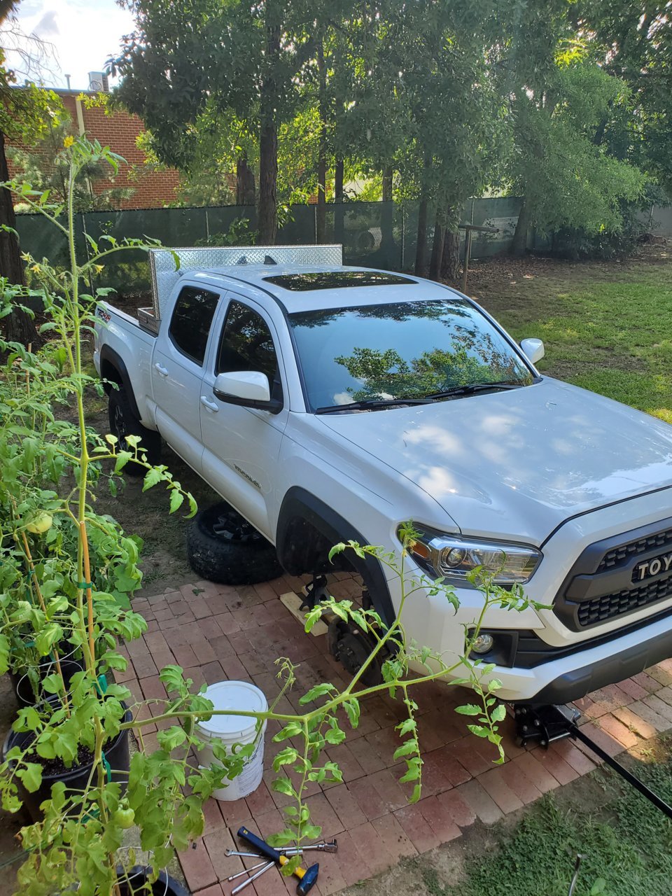

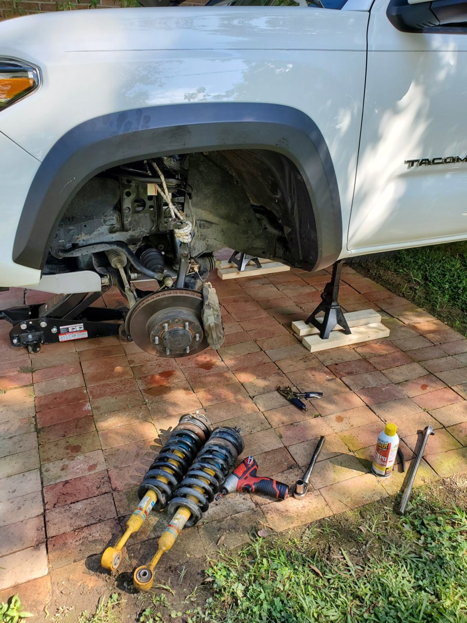

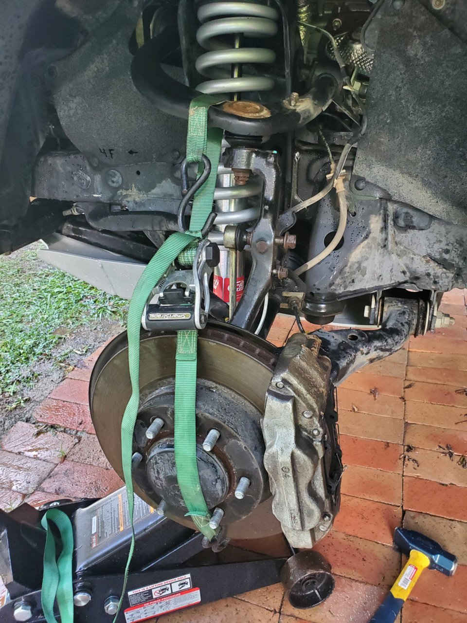

    Time to update the build thread. Got my eiback pro lift on. Set to lowest notch on the coilovers. 1" block in the back.
    My swaybar ended up touching the coil perch after the lift so i picked up a supreme suspension sway bar relocation kit.
    Eibach kit out of the box.
    Factory front coils.
    Out with the old
    Back to my glory days of improvised work space and hand tools.
    Getting the UBJ back together
    All done with the fronts
    Got the back squared away with the 1"black and Eibach shock.

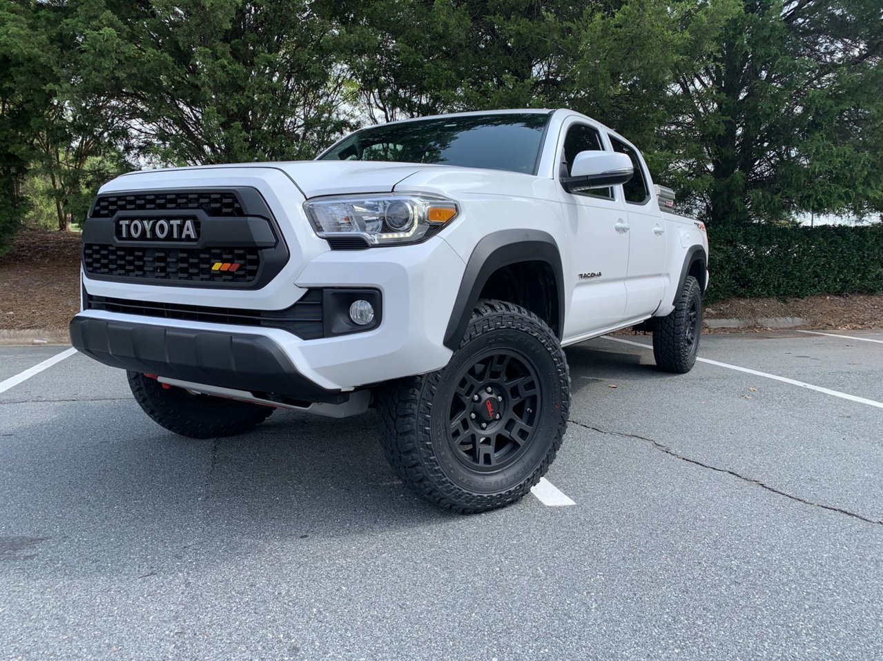

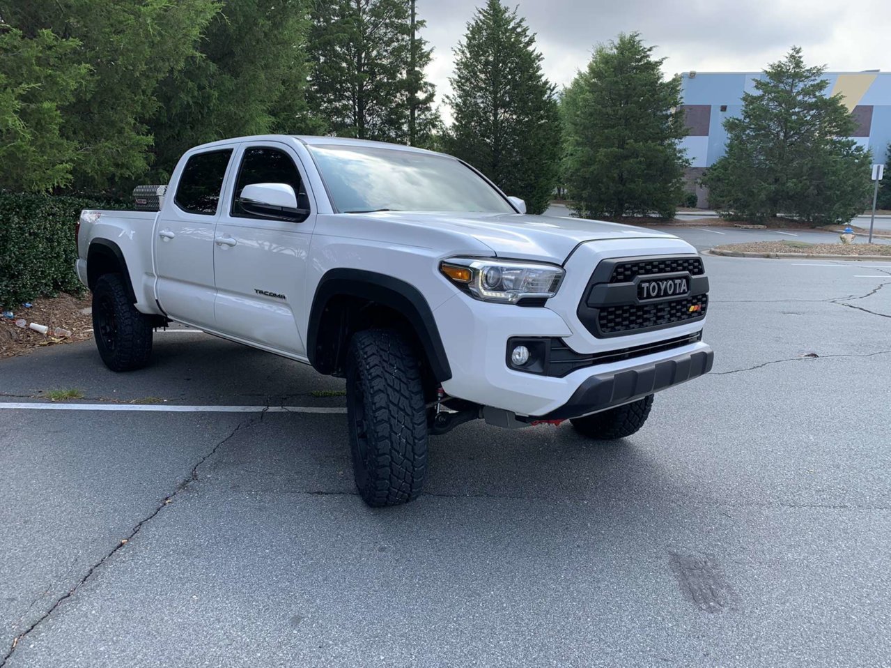

    So i had a delay with getting the TRD pro rims delivered. So here is a pic with factory wheels and 265/75s

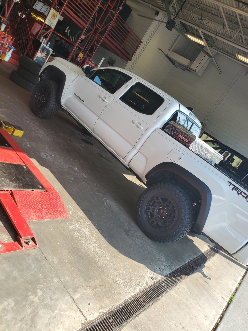

    Wheels finally got delivered and it was off to @Discount Tire to have the new 255's mounted
    Finally made it to DT
    Discount tire did a great job mounting the new coopers. Very satisfied customer.
    As she sits now with 255/80 17 Cooper ST Maxx

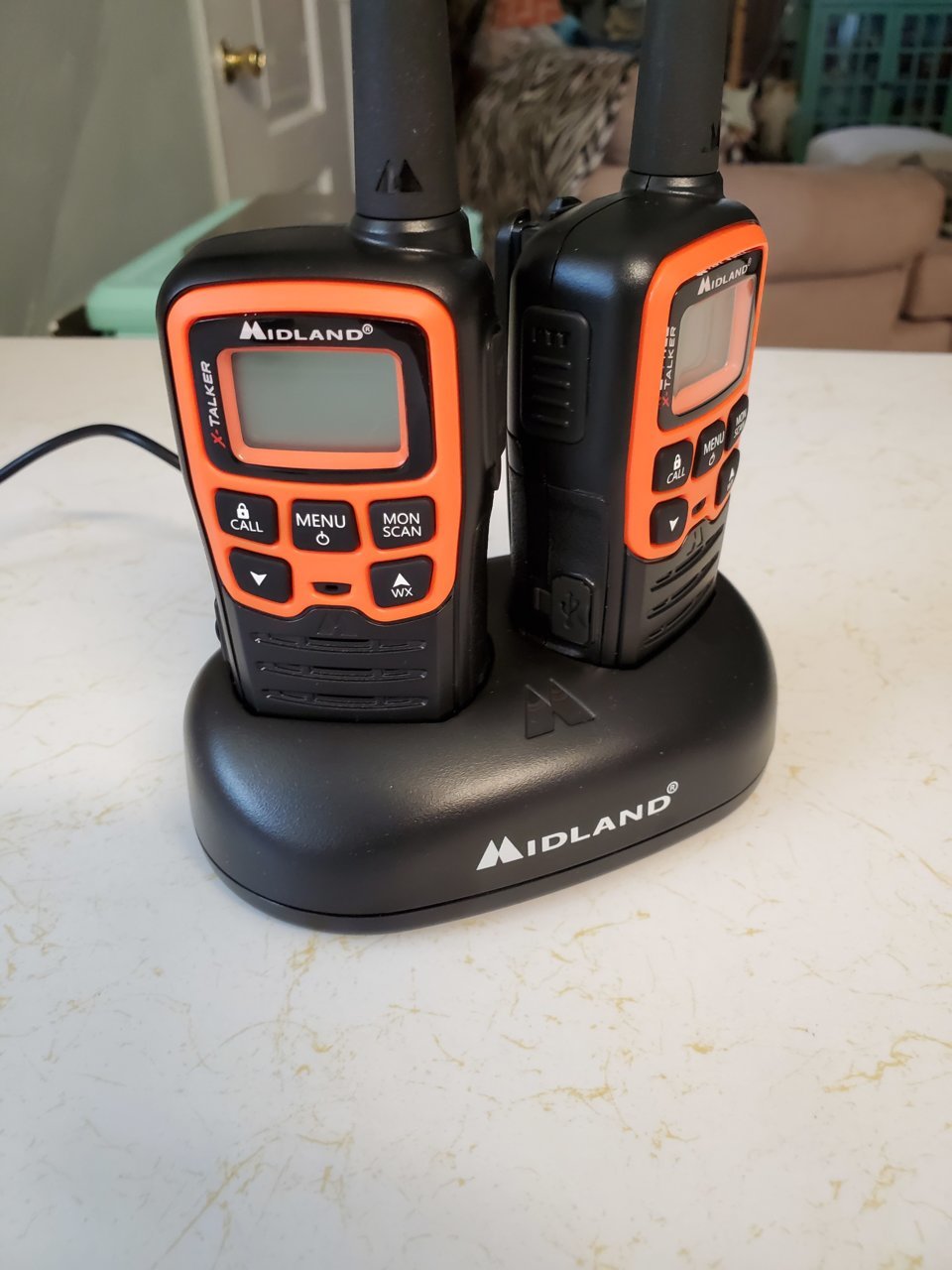

    Also picked up some Midland two-ways

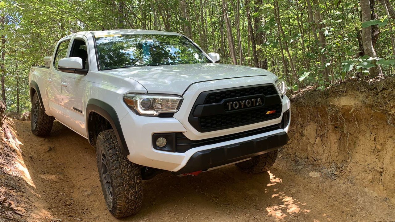

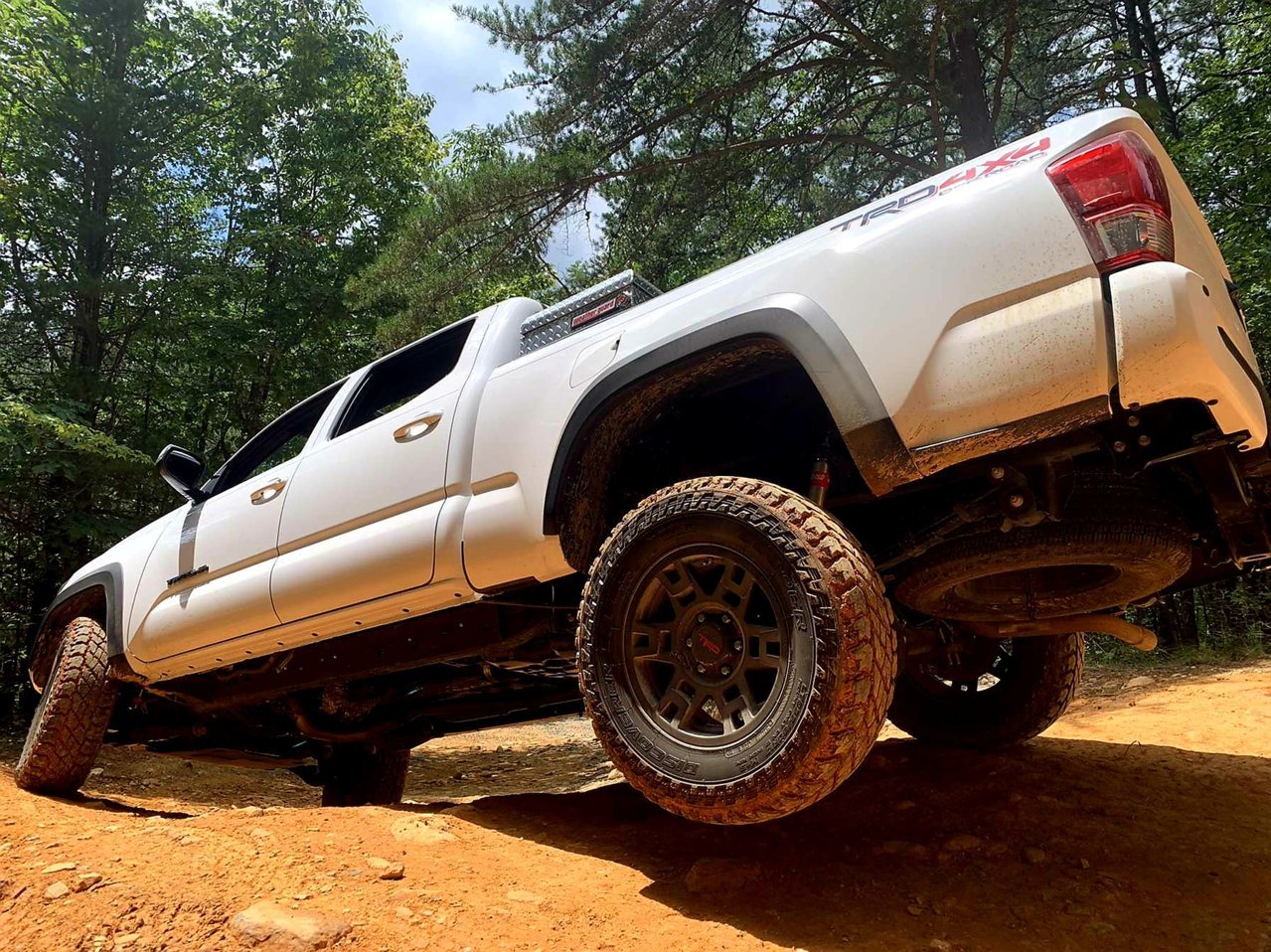

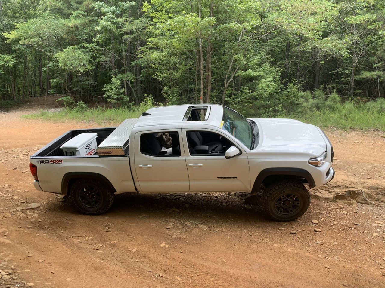

    Took the trail limo out to U.R.E over the weekend. Truck did great.

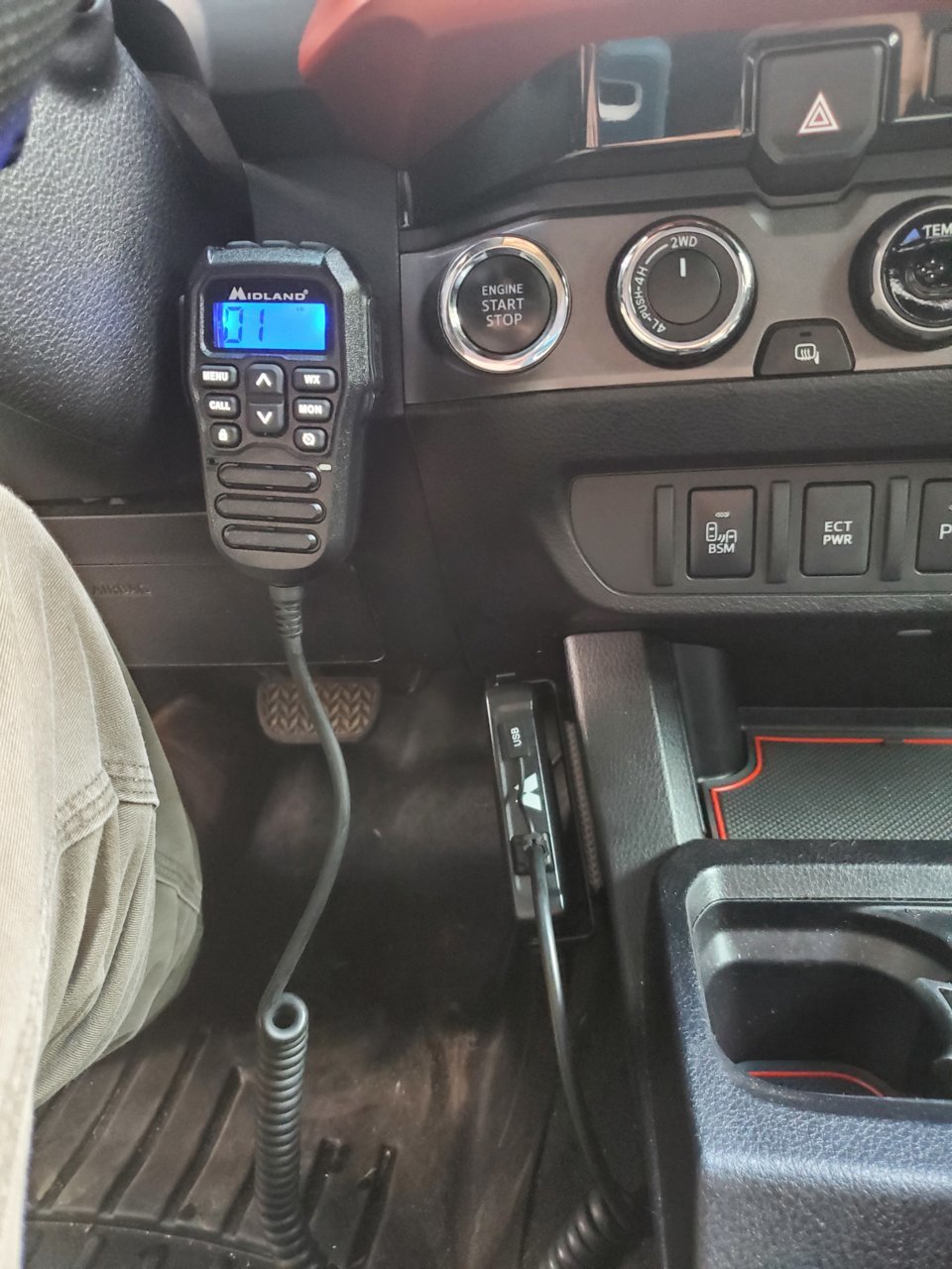

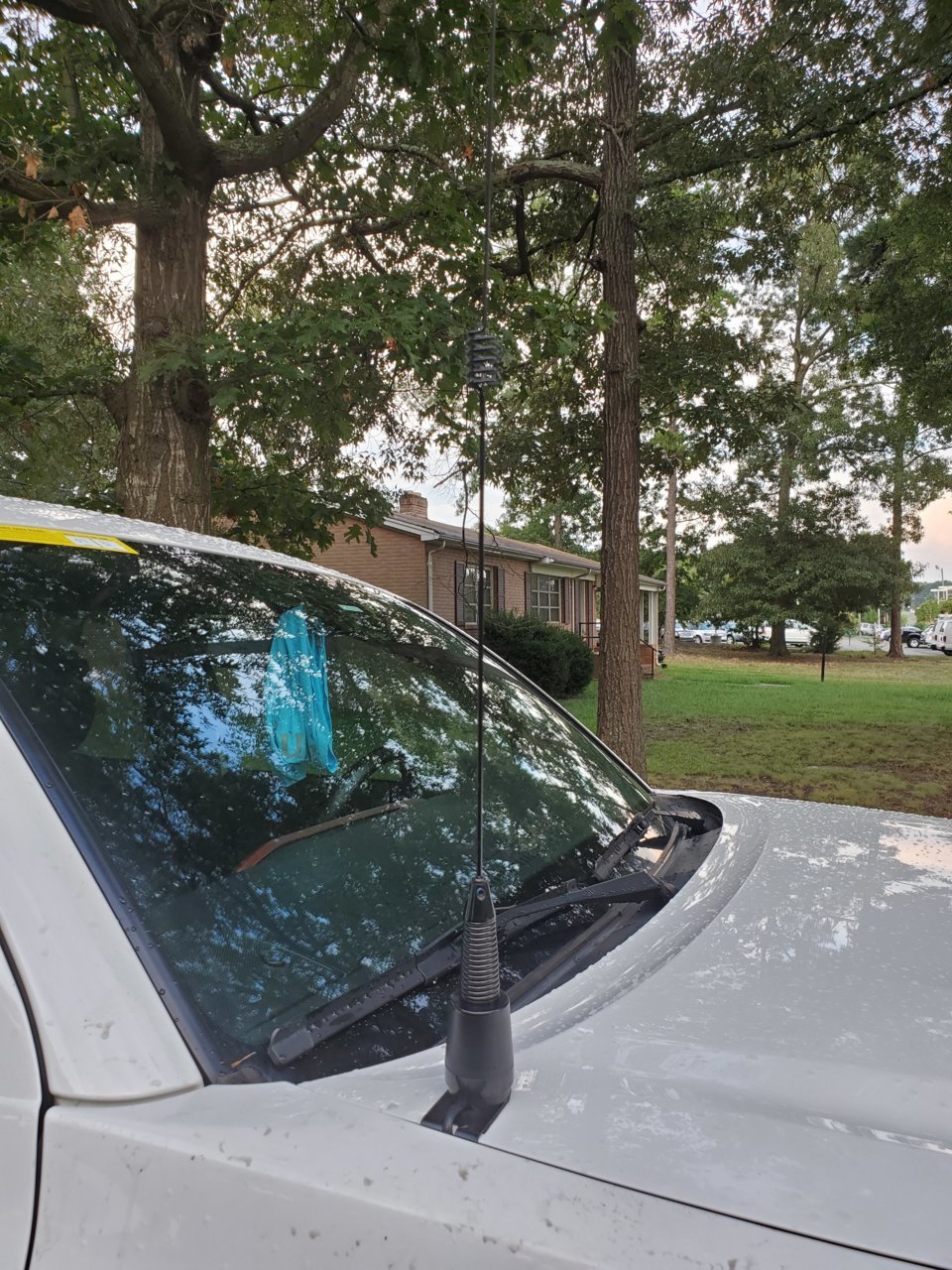

    where did you go through the firewall for the antenna cable and where did you tap in for your power? I’m planning on going the same Midland route... struggling w/ antenna location and mount. looks clean from your pics... any advice is appreciated.
  17. Aug 11, 2020 at 4:21 AM
    #17
    jlemmond
    jlemmond [OP] Well-Known Member
    Nov 15, 2019
    #310790
    2,884
    josh
    Monroe, NC
    2006 GX470
    Ill snap some pics for ya
    EagleUSMCRet[QUOTED] likes this.
  18. Aug 11, 2020 at 4:58 AM
    #18
    jlemmond
    Nov 15, 2019
    #310790
    2,884
    josh
    Monroe, NC
    2006 GX470
    So let me first say im not an electrician but im capable of wiring things with out the fear of doing damage to components.
    With that said you have an unused grommet on the upper corner of the firewall on the drivers side. Pope that out and you have enough room to run the coax and your power and ground.
    The MXT275 is wired with a 12vDC adapter. I cut that off and ran power straight to the positive on the battery and the ground to the ground stud on the driver's side fender right next to the negative battery post.
    All in all an easy job.
