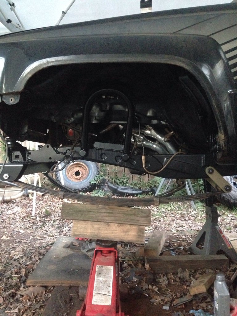

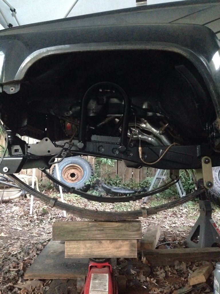

    TG 4" springs with Sky crossmember all the way forward, cab mounts chopped for shackle frame tube placement.

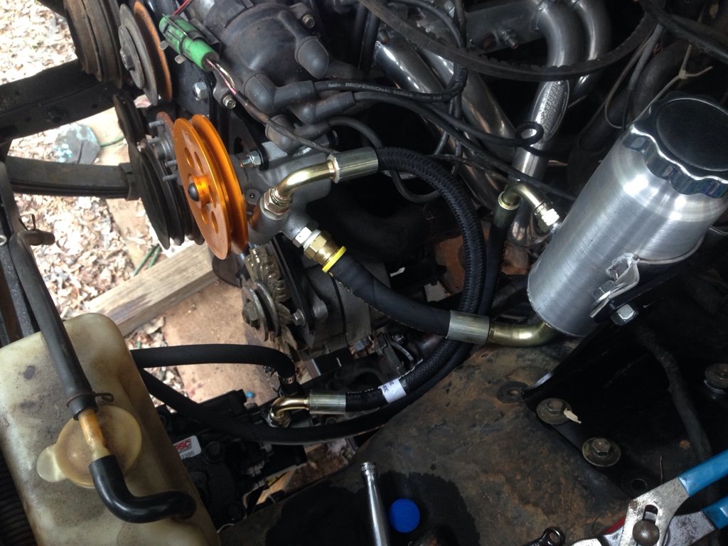

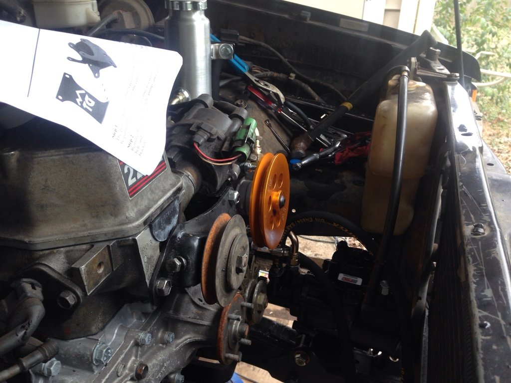

    I have been trying to get the steering system in place. One of the hydro assist box fittings wants to occupy the core support right at the body mount. I tried pounding the support, but I'll have to cut it.
    The TG steering pump kit install is frustrating with the shitty instructions. The included cooler fits no where, so I'll use the heat sink cooler I have. I cross-threaded the fitting on the bottom of the reservoir. I lost my shit after that. :goingcrazy::annoyed::frusty:

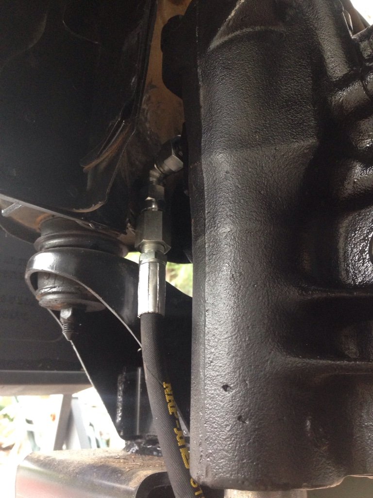

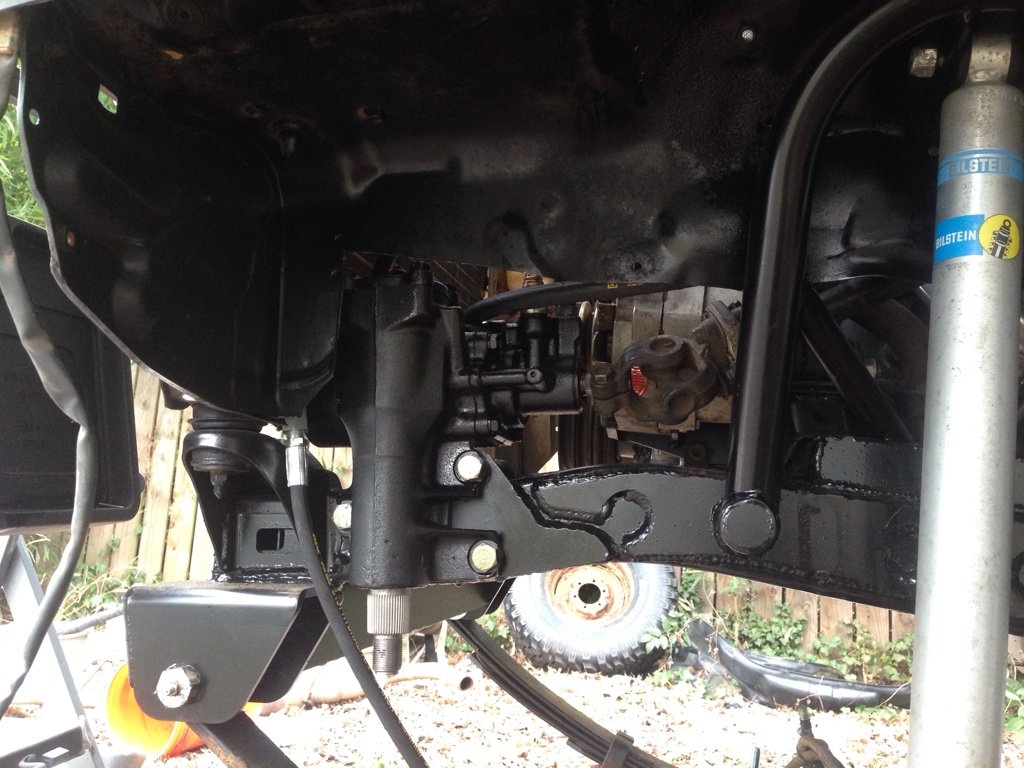

    Finally got the steering pump kit installed and box mounted. I did not need to extend the steering shaft, I just loosened the clamp at the firewall and pulled the shaft out a tiny bit.
    The front hydro fitting barely clears the core support so I went ahead and installed that line.

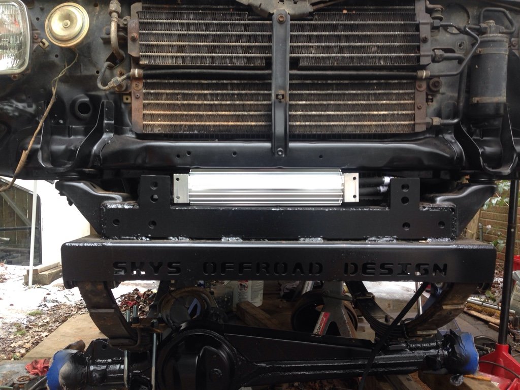

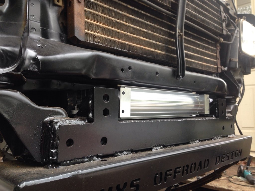

    My 12" dual pass heat sink steering fluid cooler will barely fit here, I fit the radiator to make sure. Hell I'll probably have to use countersunk hardware to clear the bumper when I make some brackets.

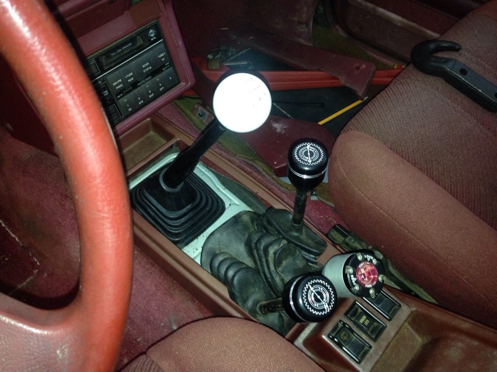

    Trimmed the shifter bezel

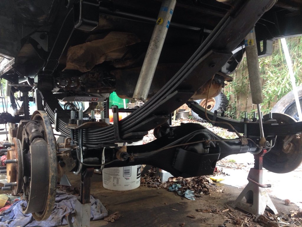

    Rear axle pretty much done
