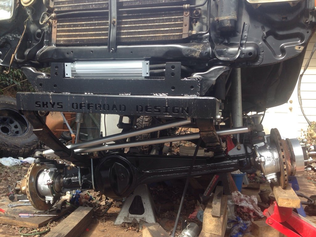

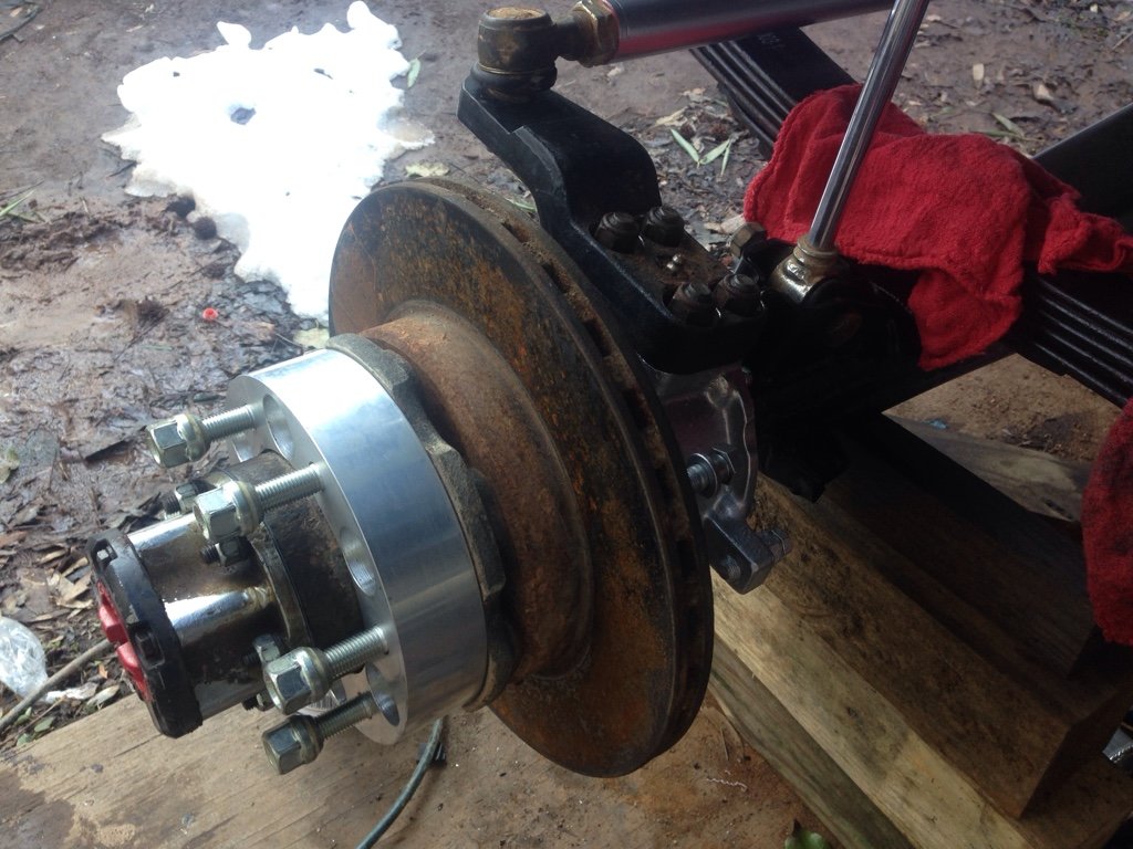

    One knuckle done
    And bumper mounted
    Need ta clean my mess up

    Is that grease fitting in the high steer arm for the trunion elim?

    Yea, there is one on each lower cap as well. The lower cap comes ready to bolt on. The upper arm had to have the pin pressed out and greaseable pin pressed in.

    Ball joint spacers and lift blocks, am I doing it right?
    How do you like the trunnion eliminator kit? I'm thinking about getting it for my Runner.

    It works. I peaked at the bushings and pins while they were apart and they are only polished. As long as they stay greased often I think they should last a long time.

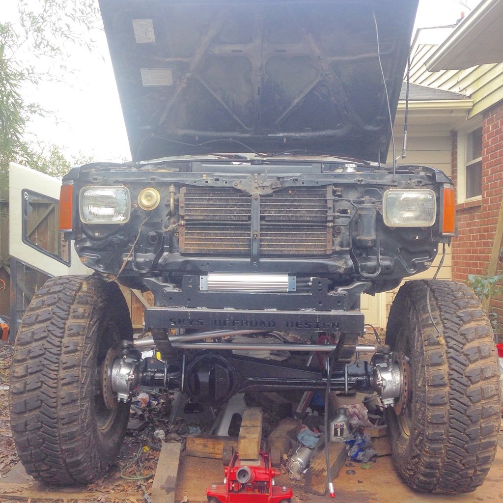

    I got the frontend together, but in typical fashion I will have to take it back apart to grind down my knuckle gussets some more. They are hitting the knuckle seals before full lock :mad:
