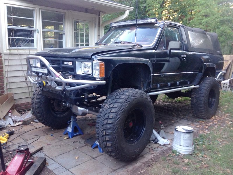

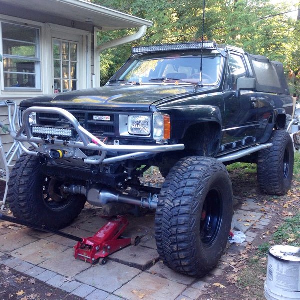

    Almost ready. Need to shorten the drag link, set the bumpstops and button up a few things. It needs moar glam.

    Paint da wheels silver for more glam!

    Looks good man. Where did you get that led mount?

    Thanks. For the roof lightbar? I modified some Chevy Silverado mounts, they were $30 compared to $150 for a vehicle specific set :laugh:

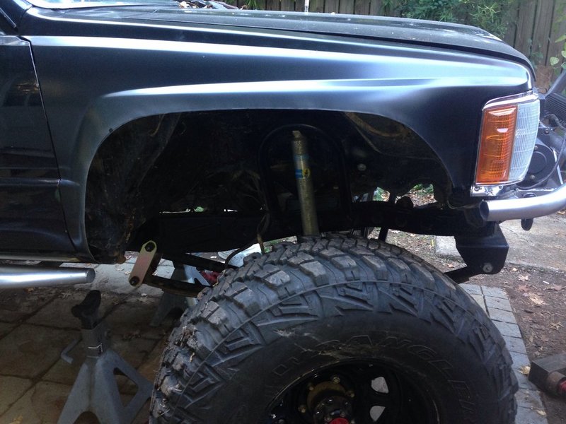

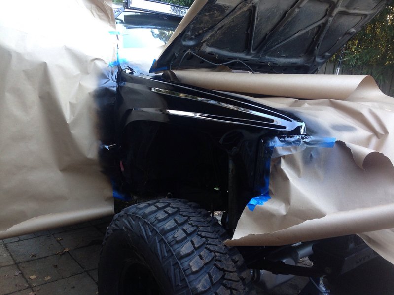

    Chopped mah brand new fender, and bumper
    @Boomtacoma01 \/\/\/
    :woot: almost there, just a few bolts to tighten, pour in some fluid, swap my rear shackles for 6" and check everything.

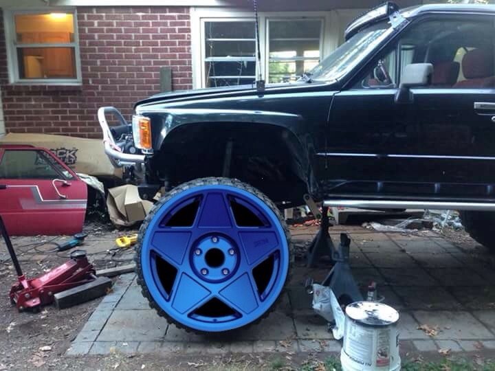

    I'll just rock these

    Rockstars bruh

    The cut came out nice. When I did mine I took a piece of quarter inch rod and bent it to the shape of the opening. It put some strength back in the panel and left it with a nice rolled edge.

    Nice. I'm planning to do that with the rod when I close up the rear wheel wells, will make it a little easier to weld the fender lip and smooth it out.
