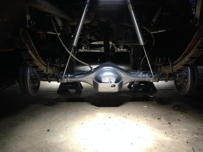

    What length shock are you running?
  5. Mar 2, 2016 at 4:55 PM
    #1045
    ajohnson
    ajohnson [OP] Glamour Shot
    Apr 19, 2009
    #16145
    8,496
    Andy
    Charlotte, NC
    07 DCLB TRD Sport Prerunner 4x4
    Things and stuff and such
    12"

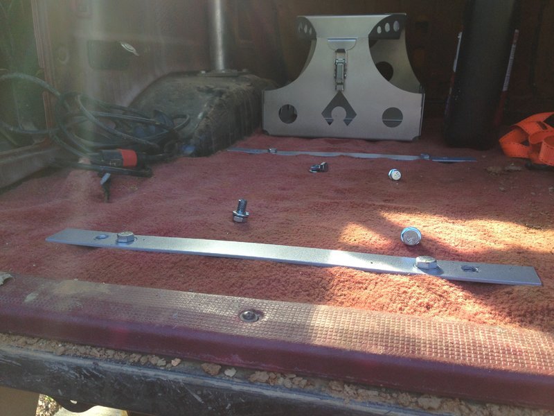

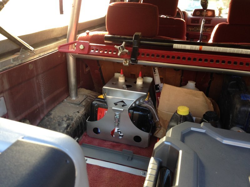

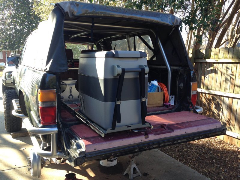

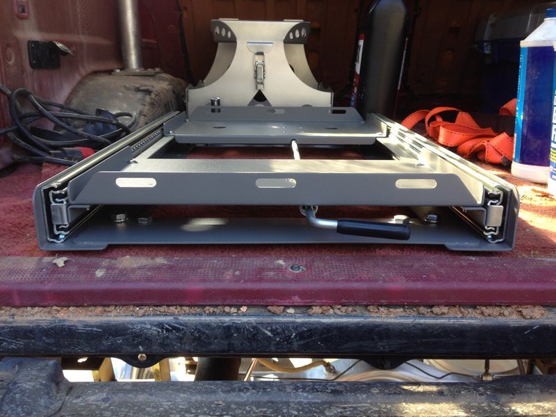

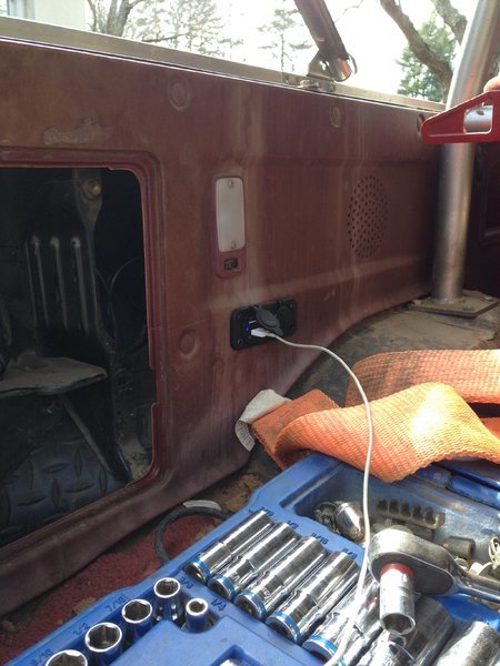

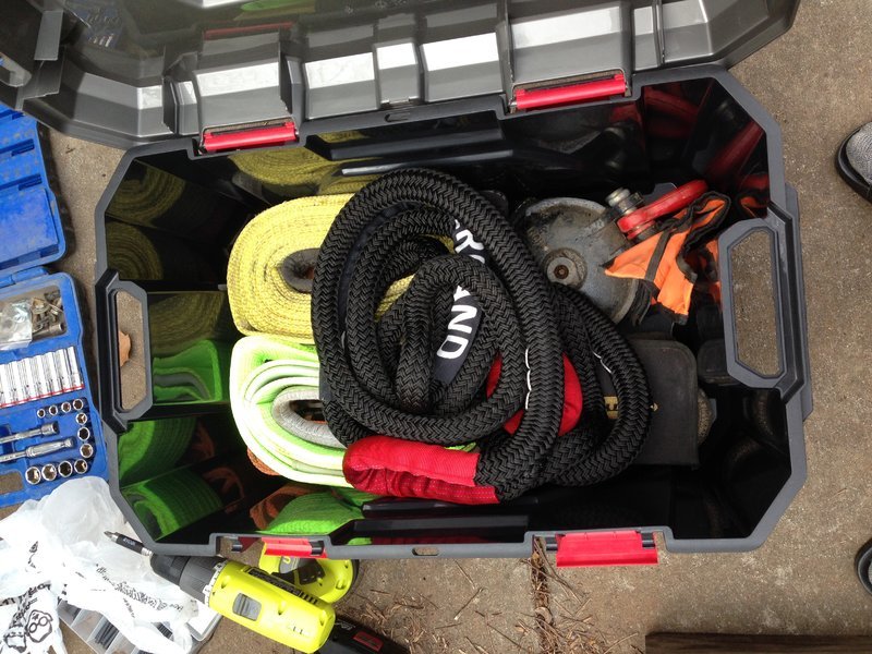

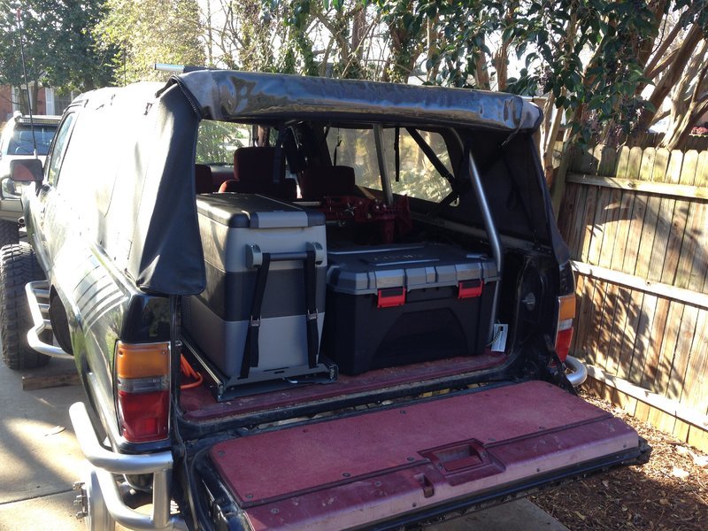

    I'm waiting on a new rear brake line, so I installed my 12v outlet for the new fridge. Pretty simple and it has USB ports as well.
    Finally picked up a tote for my recovery gear so I can keep the cargo organized

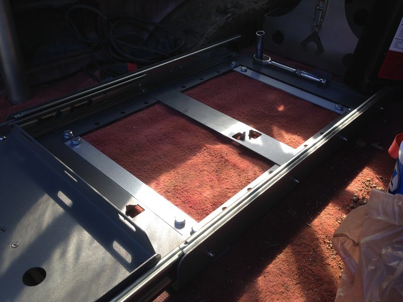

    Then I fabbed some mounting plates for the fridge slide. 3/8" nuts are welded to the bottom of the plates, they fit perfectly between the floor ridges, and the slide bolts to these nuts. The plates were then bolted to the bed floor and will stay in place. I will make another set of plates for my Tacoma, and the slide can then be transferred easily between the two trucks. I forgot to get pics of the plates before paint and install.
    Then I found a spot for the Artec quart crate.
    I'm really excited about this setup.
    ChamYota, Redneck92 and HomerTaco like this.

    Made by Husky from Home Depot, I think about $17. It's pretty sweet, either side of the lid can hinge.

    I like that fluid rack!

    Why you no paint it?
