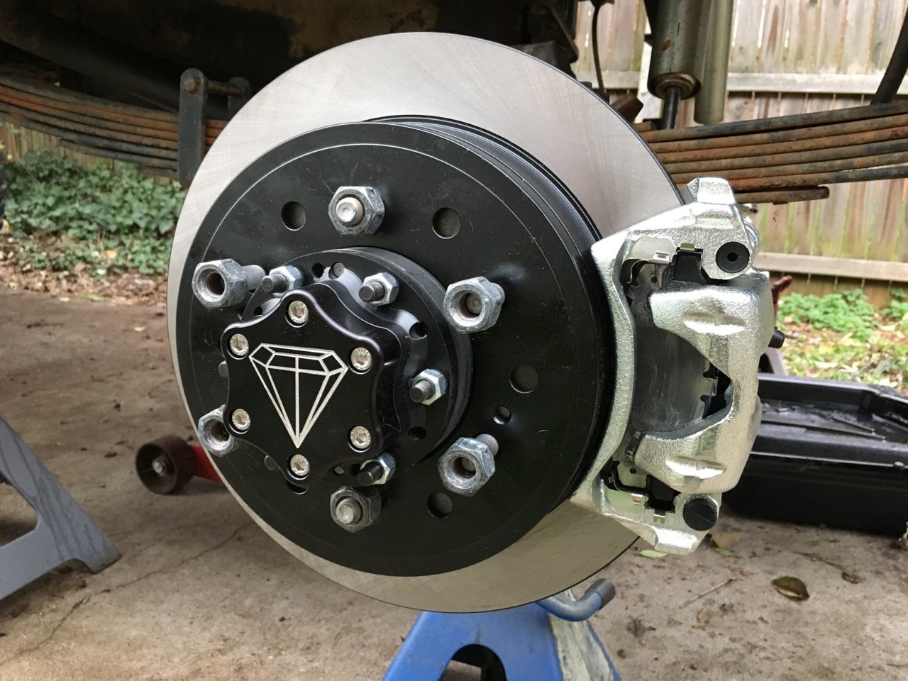

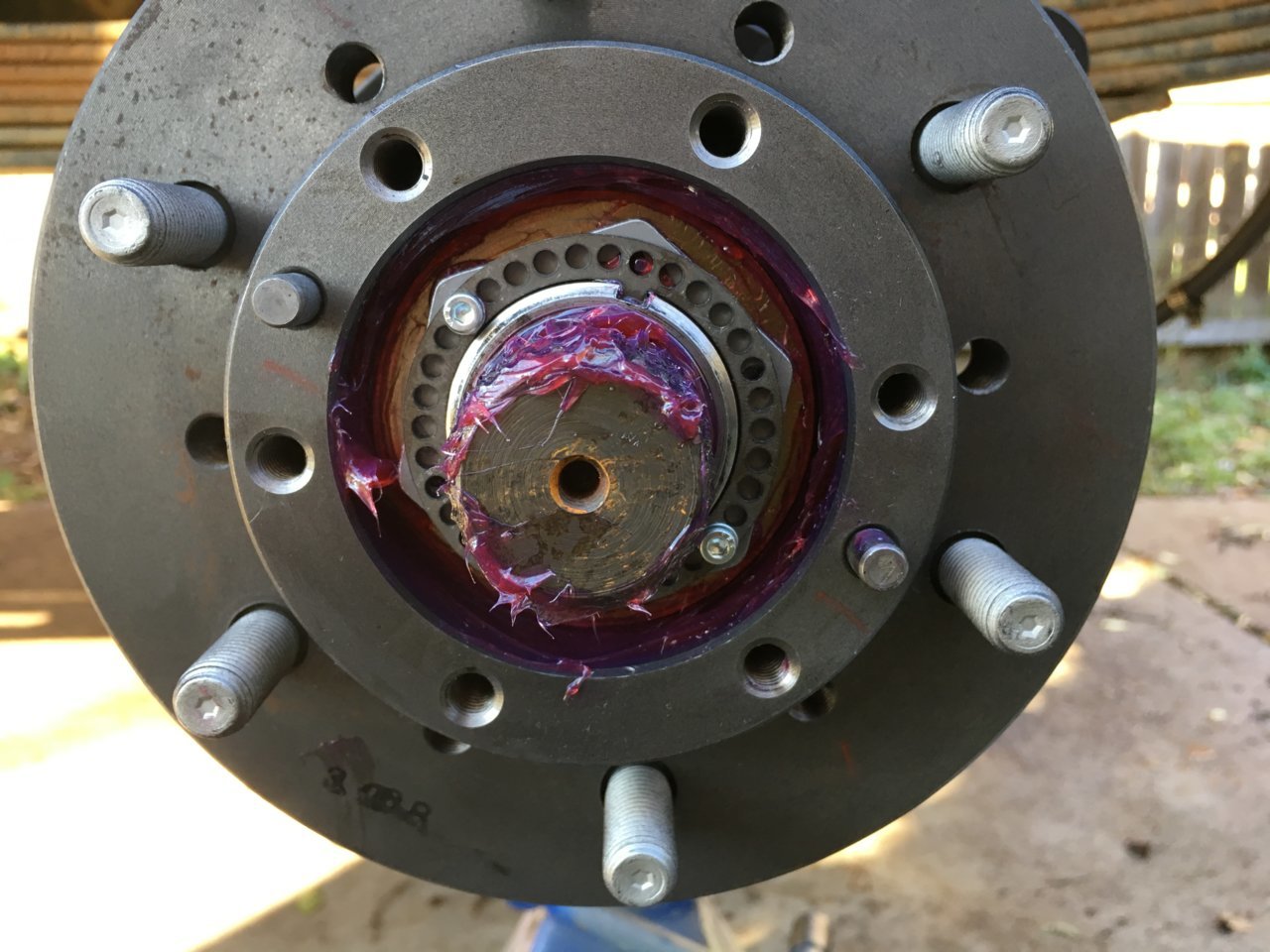

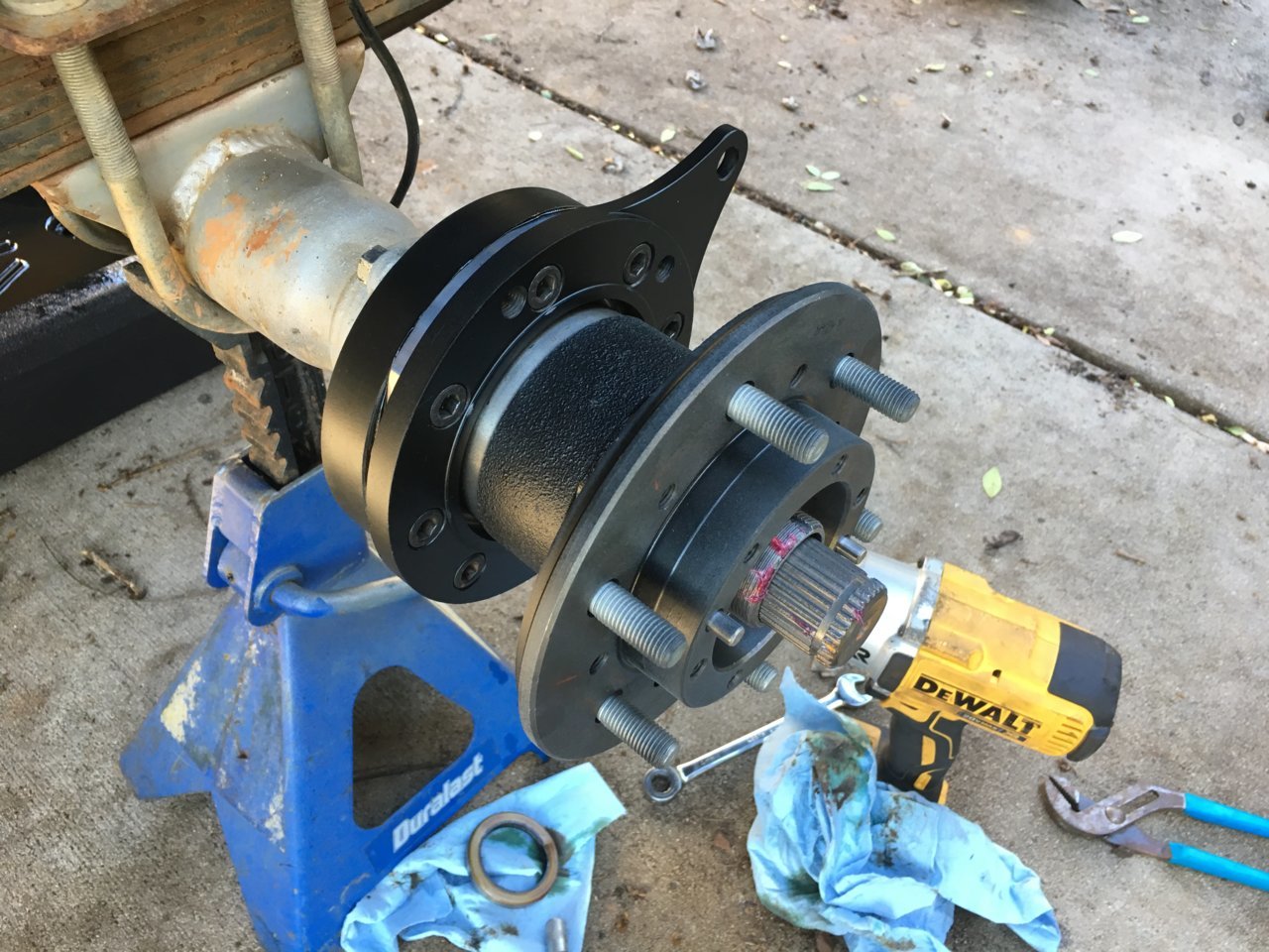

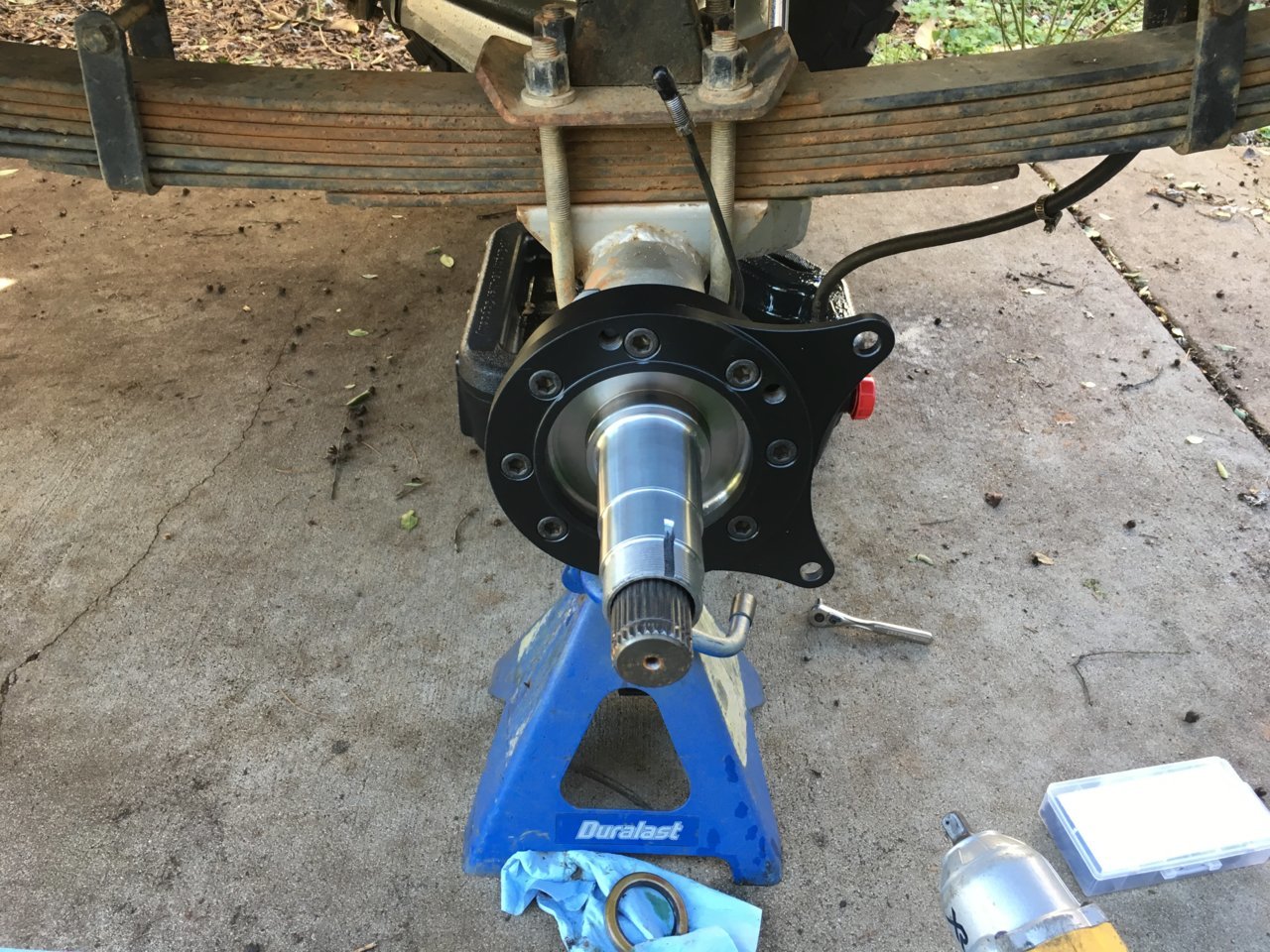

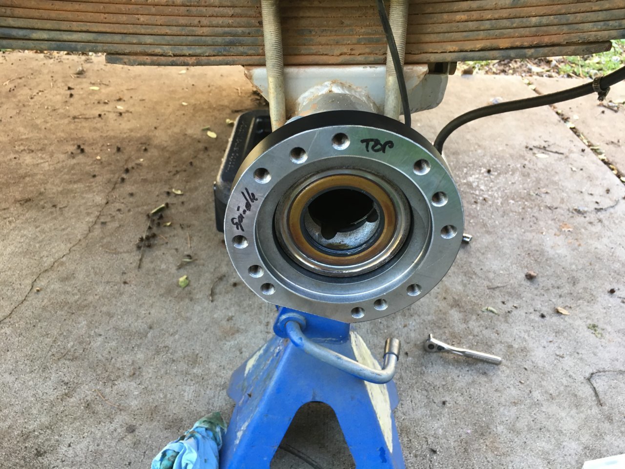

    I installed a FROR rear full float kit with the late model 4runner caliper mounts. This setup requires IFS hubs, so now my front and rear hubs match and I ditched the rear wheel spacers. I used 2015 4runner brakes which I thought were identical to 4th gen, but I needed two washers to center the caliper on the rotor :confused:.
