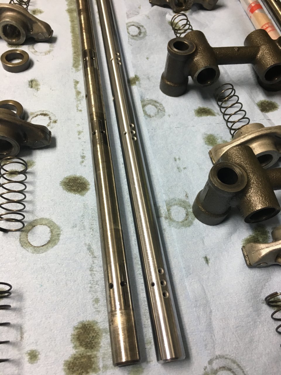

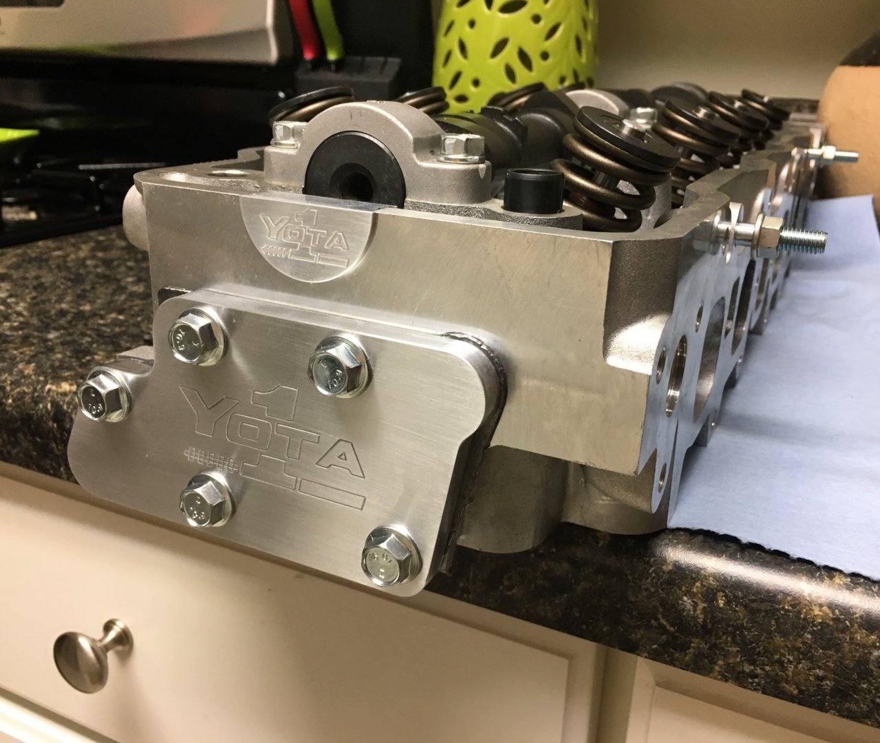

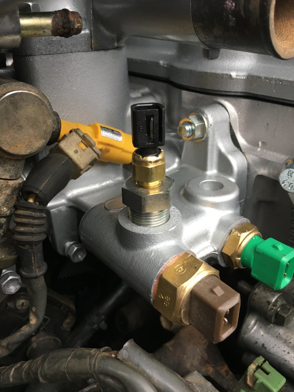

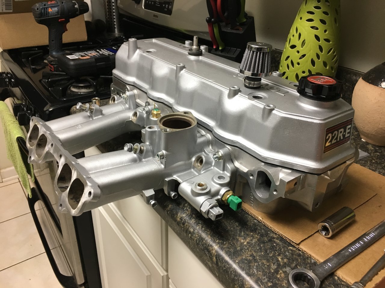

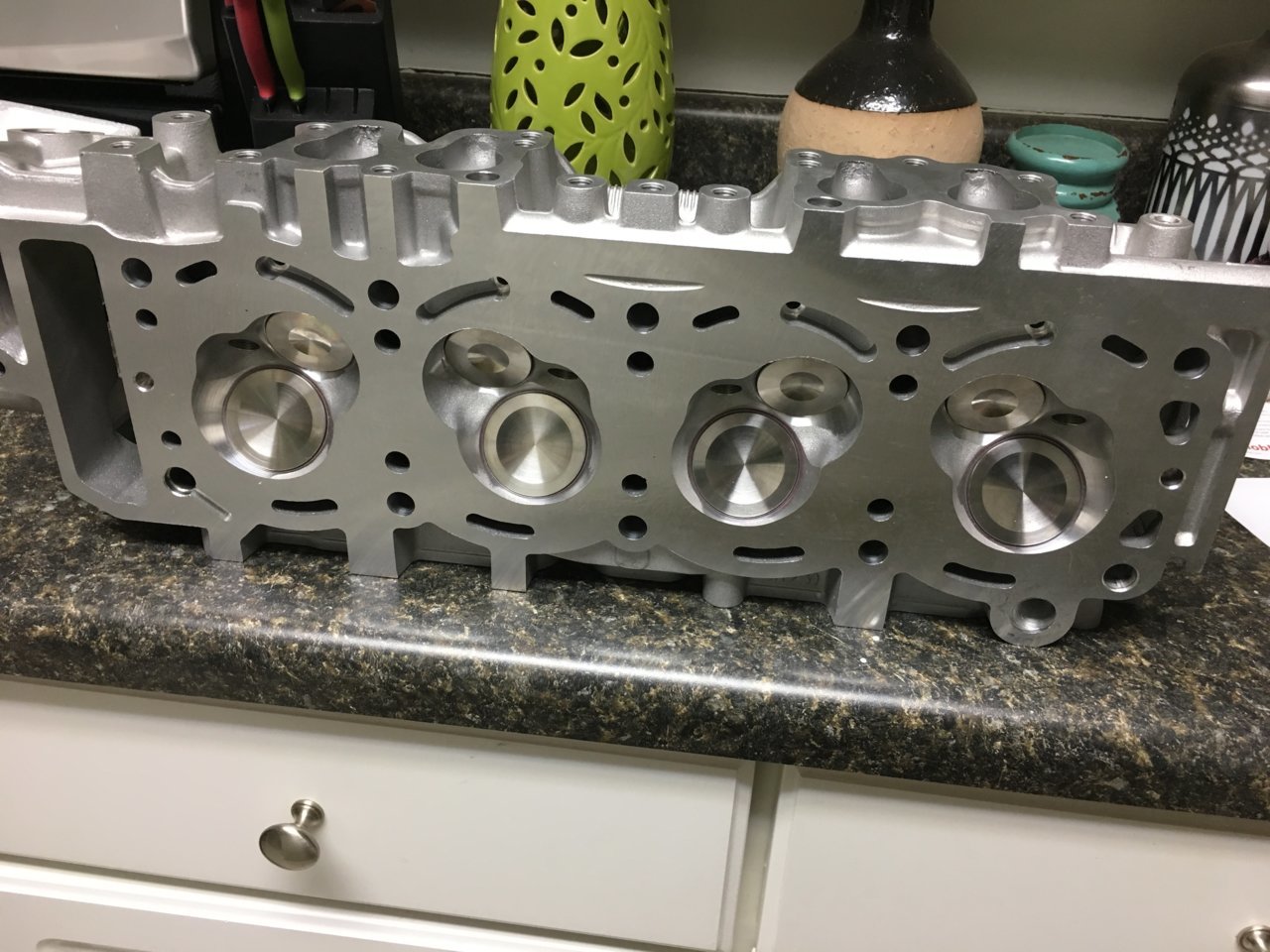

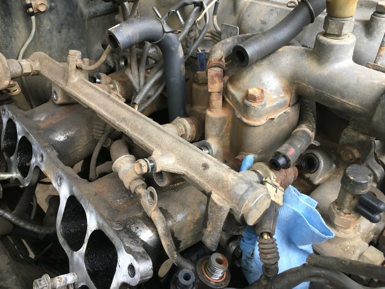

    My next project is a late model upper intake with a 7mgte throttle body and ‘82 Supra AFM. So I pulled the intake yesterday and found the #1 injector leaking and they looked pretty rough. So now I have BOSCH 4 hole injectors on the way and then things escalated to ordering a Redline Engine Builders big valve head and 268c camshaft, so that should be fun.

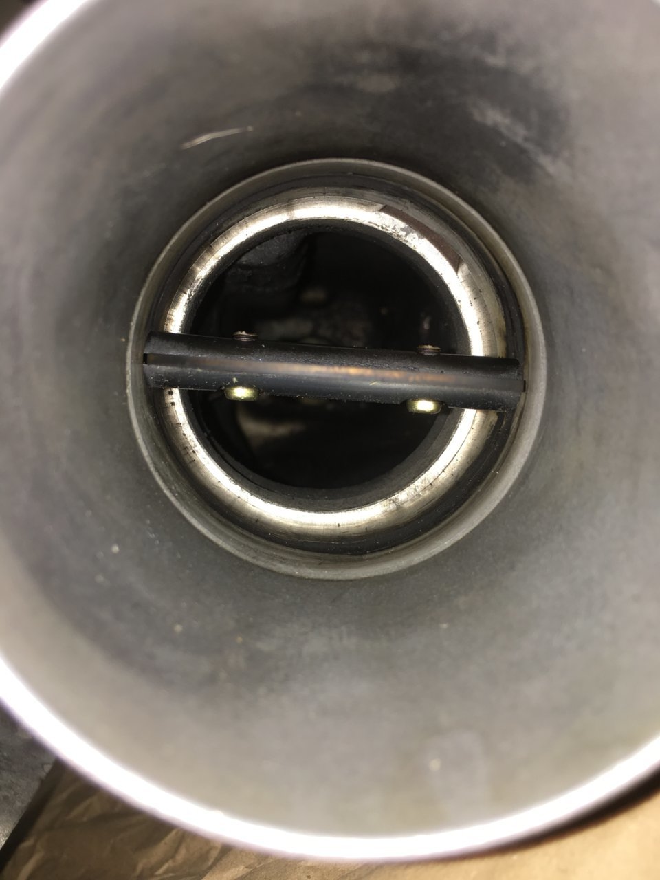

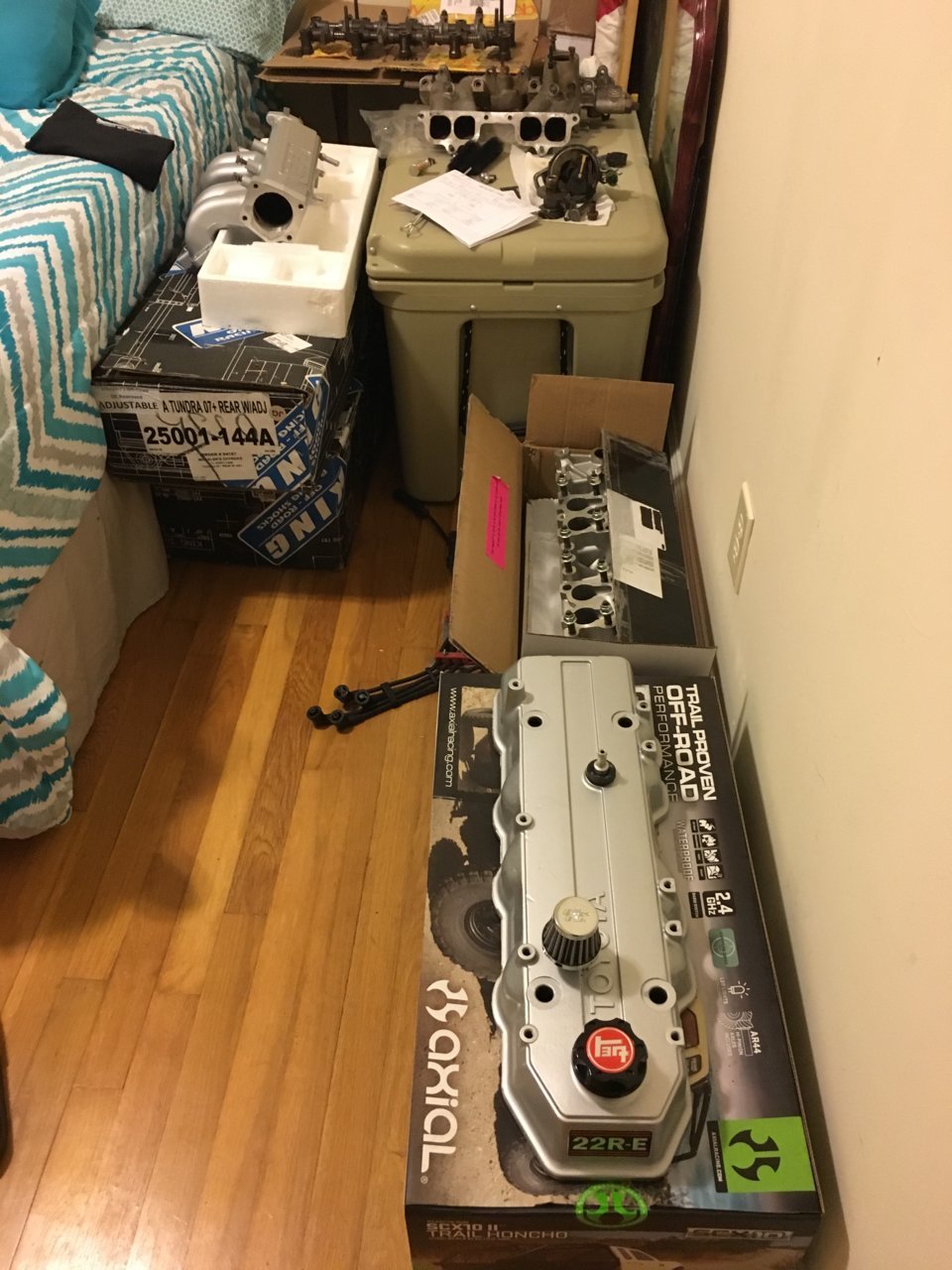

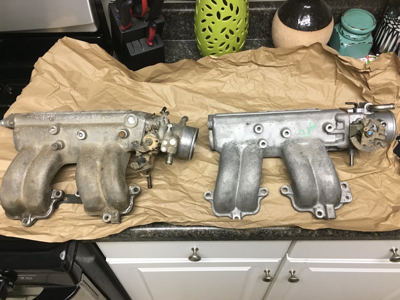

    Early intake and TB on the left, late model less restrictive intake and 7mgte TB on the right.
    The old throttle body is 60mm at the opening and necks down to 55mm. The Supra TB is 60mm all the way through. I will port the intake to 60mm to make it worth the effort. Interestingly, the throttle plate fully opens on this intake, unlike some other 60mm TB’s I’ve read about where the plate hits before porting.

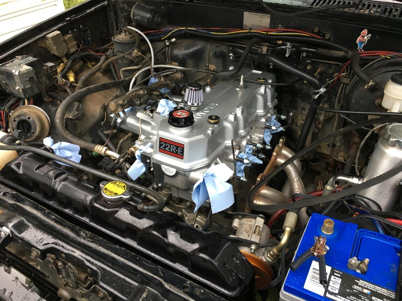

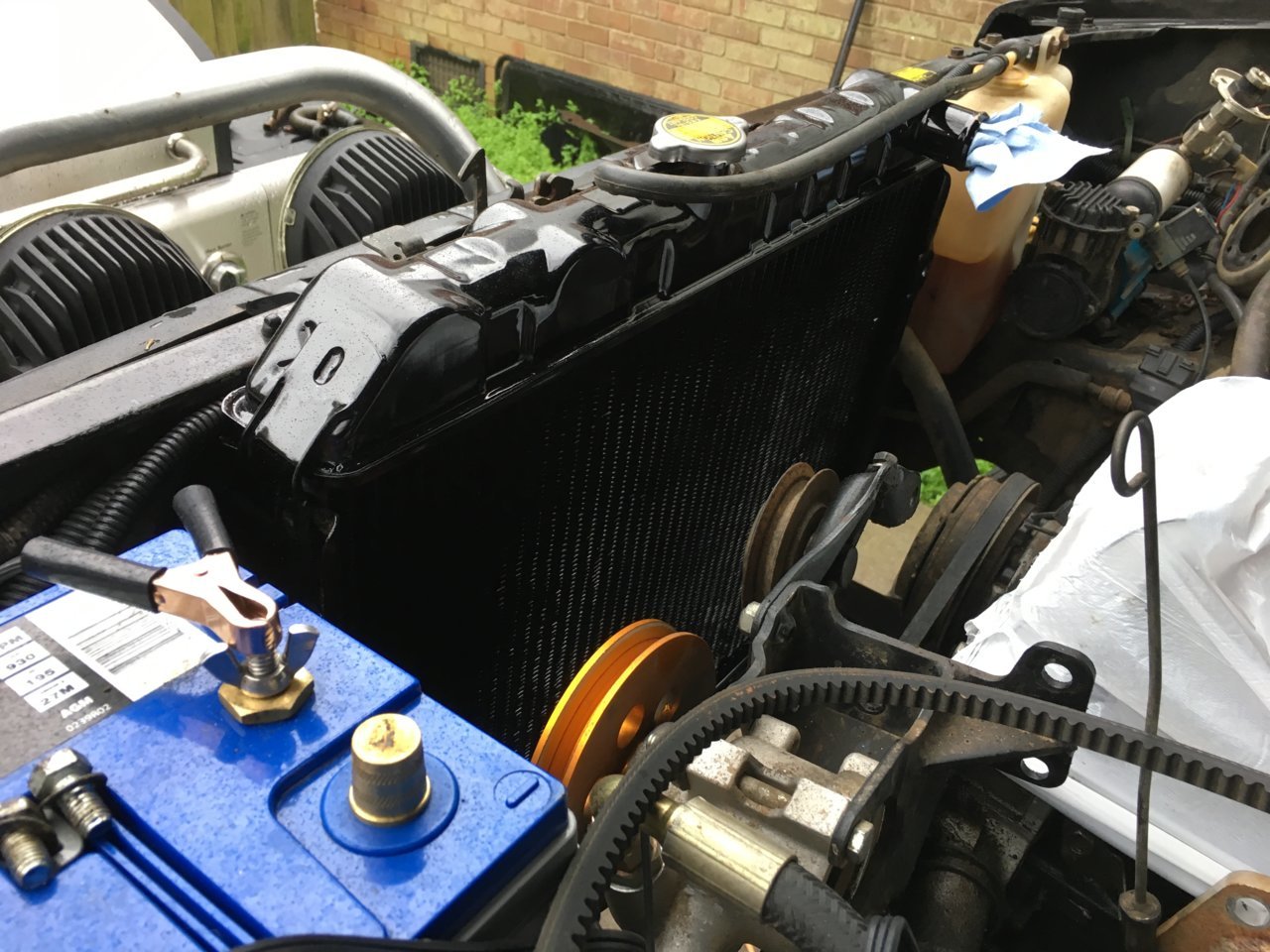

    This was a good time to throw in a CSF 2314 radiator, all metal 16” 3 row core, and a 150 GM amp alternator in place of the 100 amp I had.

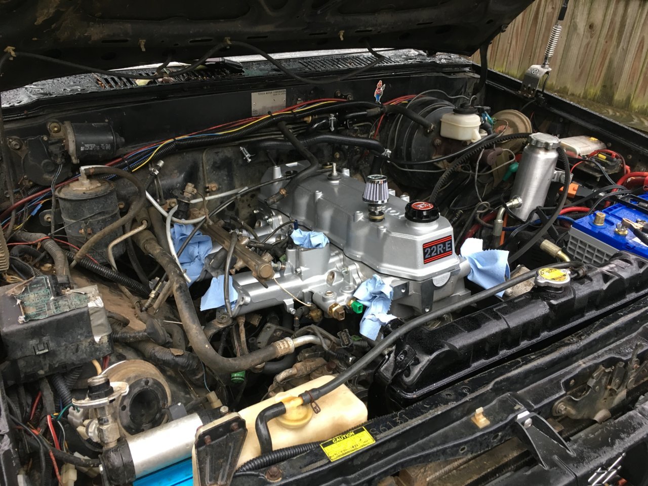

    Hopefully I didn’t miss anything. Going to fire it up soon.

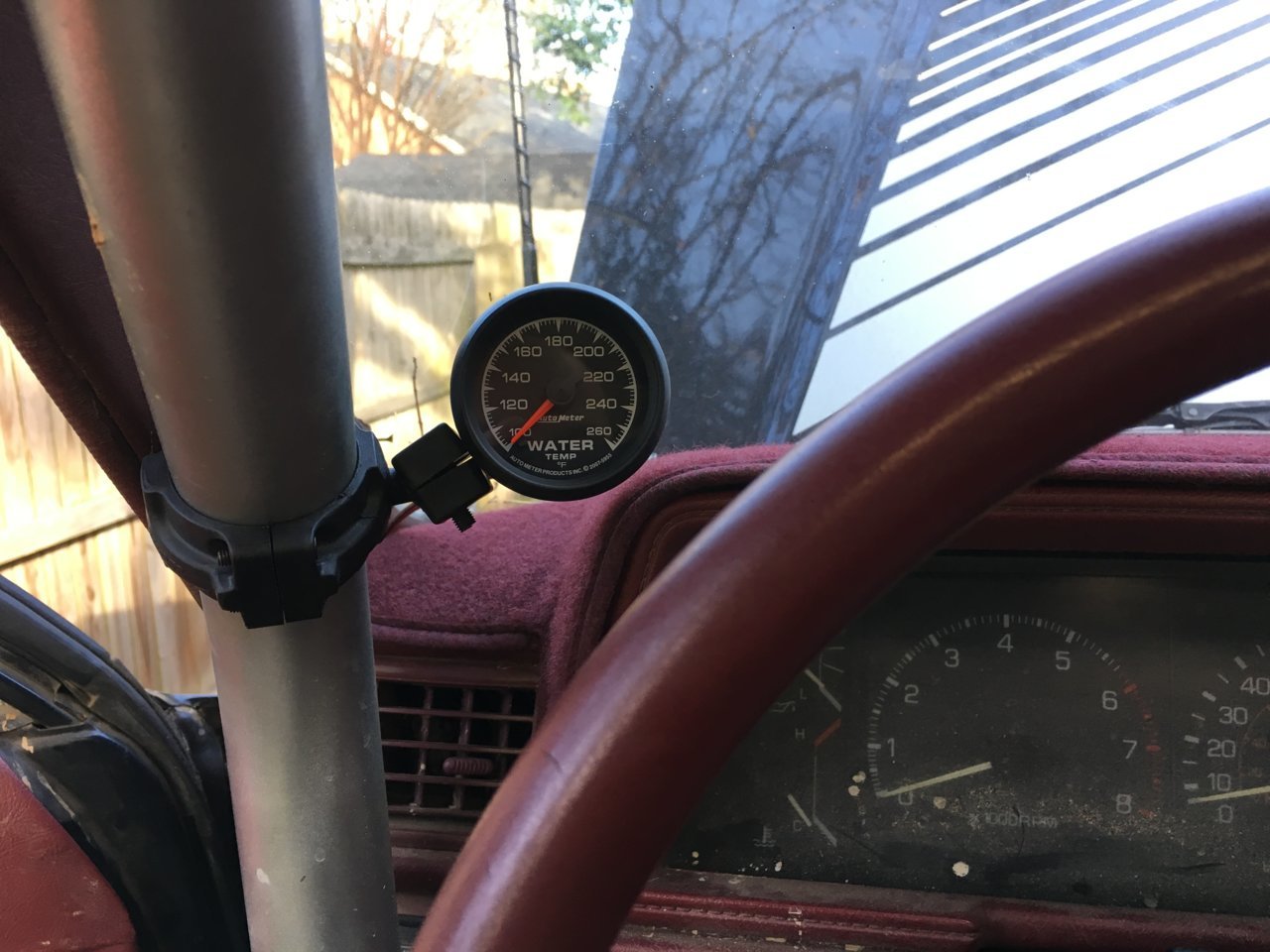

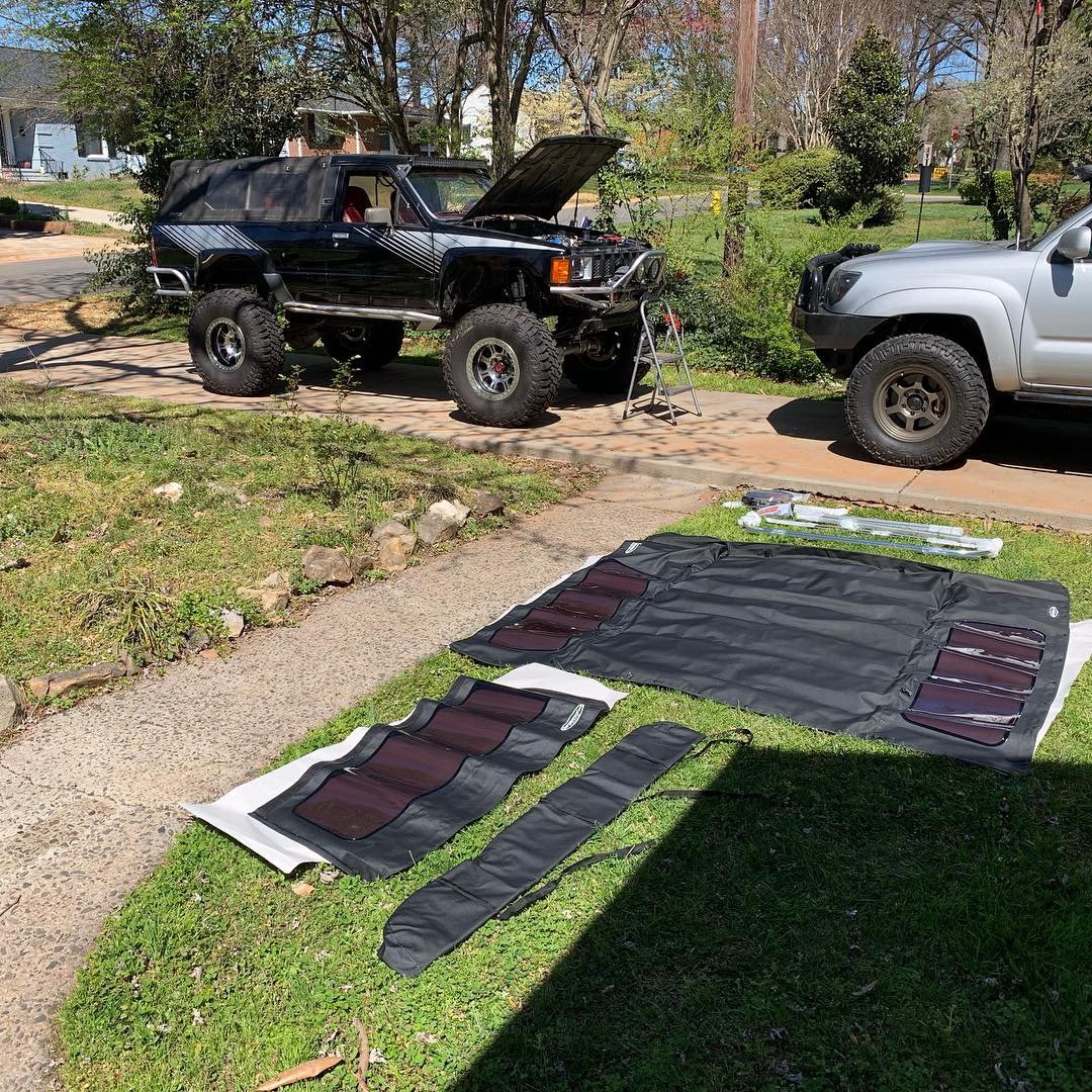

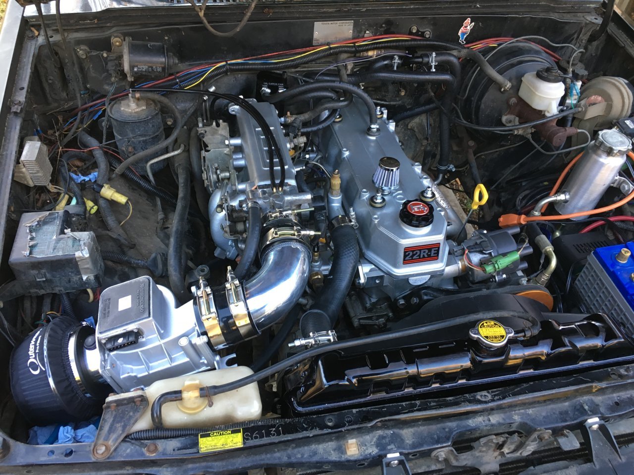

    It’s driving! Got the camshaft broke in, struggled with the idle and timing for a couple hours last night, but it drove pretty well this morning. The dash pot on the used throttle body is sticking, so the throttle plate wouldn’t fully close on the test drive. I’ll try driving without it in a little while. Just finished installing a new softopper.

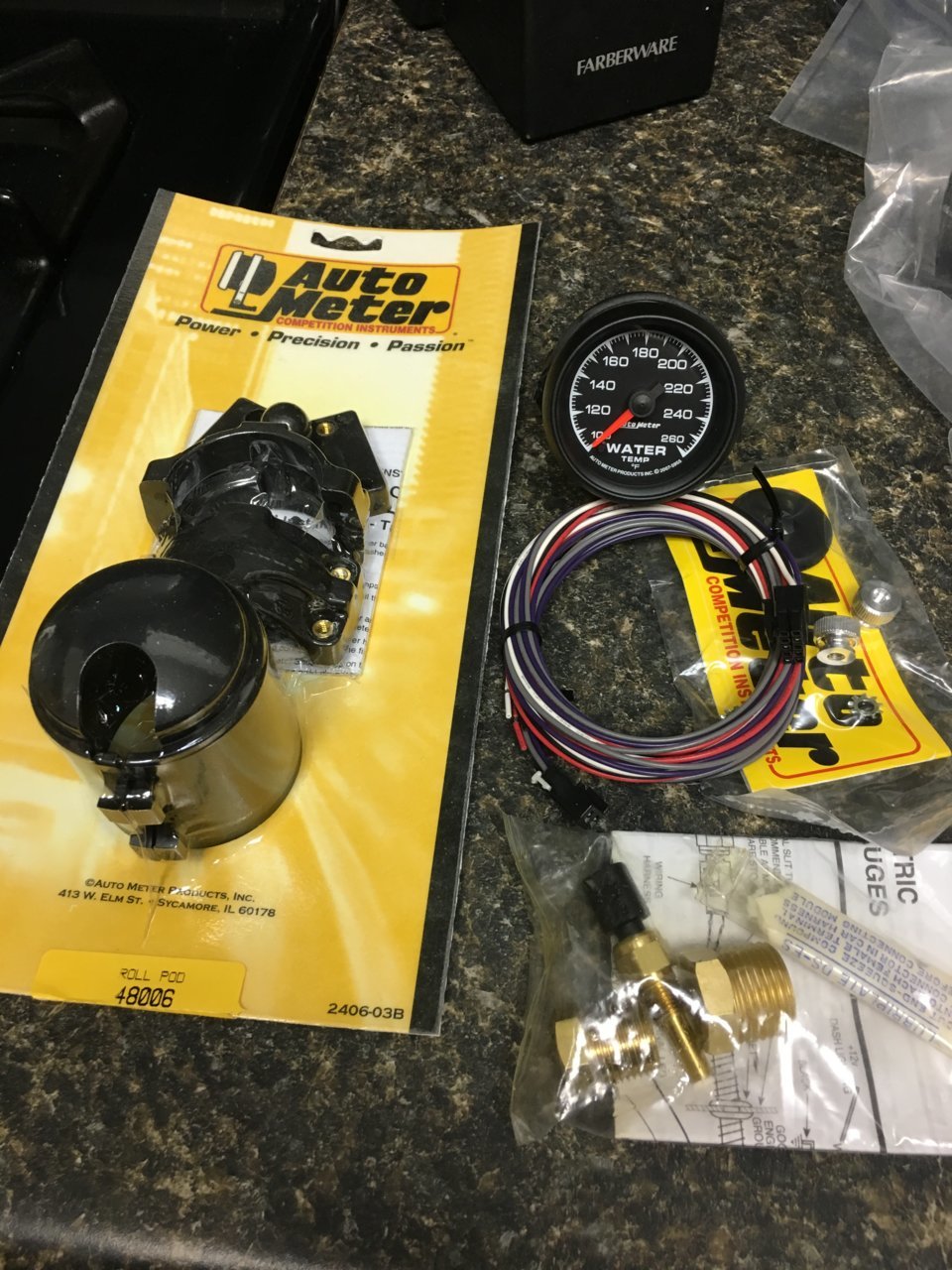

    I put in a OEM single stage thermostat but it wasn’t opening until the coolant was 220*. Luckily I also had a dual stage OEM thermostat that fixes temperature spike and that’s what I need. Swapped it in and it only gets to 200* now.

    Like 4 rather agitated squirrels. Huge difference on the highway.
