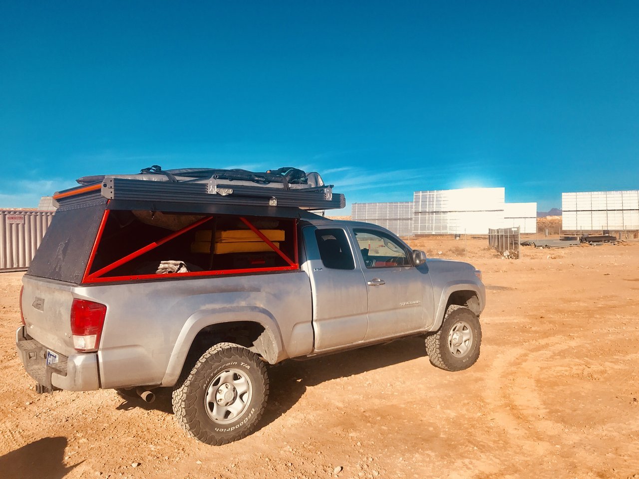

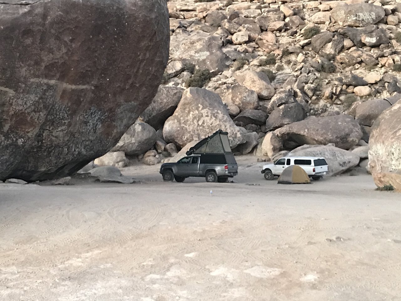

    The Baja testing mission is begun and the build isn’t even over. I am currently waiting here at Outlaw off-road in Santa Ana getting some Method bead locks and Yokohama tires installed. But while I wait, how about a couple of photos wherein I a) access something from the side somewhere in the desert:
    And b) later that evening camped under the Giant Rock:
    With the load of the camper and Baja stuff the Deaver u402 stage Ones are perfect. They ride really well. But hauling five extra wheels and tires across town made the ride turn to poop. In a very serious way. Gotta get the springs right for your weight.
