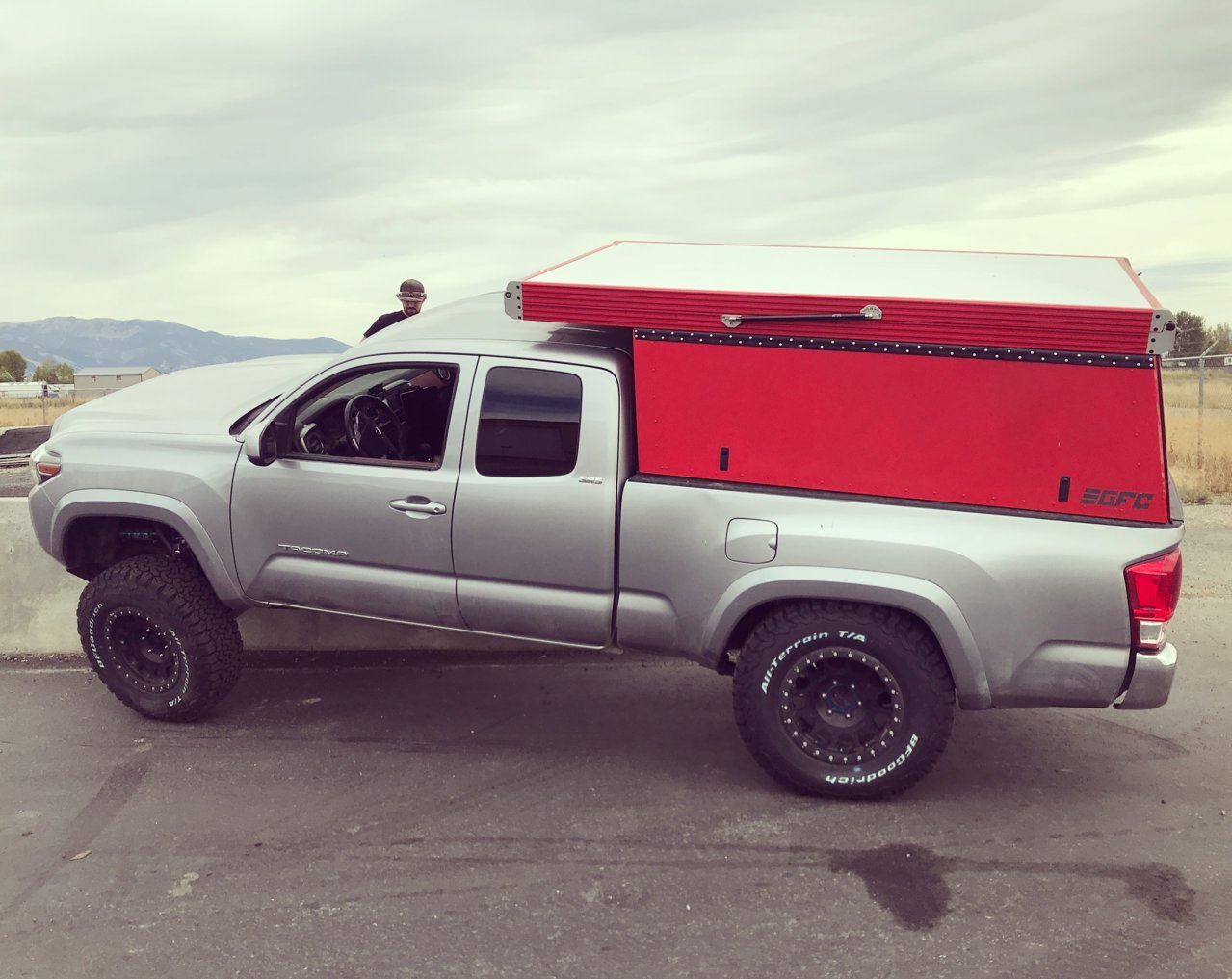

    Just got back from the Gofastdirtcamp. Needless to say, the new suspension is a hoot.

    I’m pretty sure BFG was offering some promotional considerations to the go fast dirt camp trip.
  8. Oct 14, 2018 at 8:02 PM
    #128
    wileydavis
    wileydavis [OP] Well-Known Member
    Nov 6, 2016
    #201729
    834
    Wiley
    2017 SR5

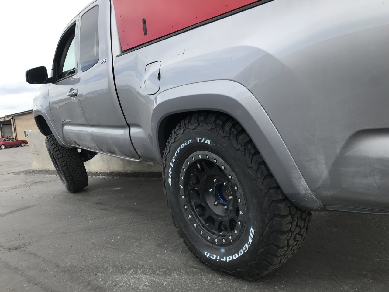

    That's correct. I had 255/75 R17 Yokohama Geolandar M/Ts on before. They were a good tire and with that size I was able to get the full amount of stock travel without having to chop the cab mount.
    That said, my favorite tire has always been the BFG All-Terrain. I'm used to the way it drives (and slides) and I've always had good luck with them in terms of longevity. When I switched to the LT suspension it necessitated a larger tire than the 255/75. BFG now makes a 34" x 10.50 R17 All Terrain (KO2...never been sure what that stands for). I think it's a perfect size as it allows the +2 kit full travel without having to run fiberglass fenders. Just a bit of trimming of the fender liner (and the cab mount chop). We got deals on both sets of tires but I'm personally a huge fan of the BFGs and will be sticking with them. Never hurts to try something different from time to time though.
    As for the size, I like to run the smallest tire I can get away with for the conditions. Since the truck's not a rock crawler, it doesn't need anything huge. Just puts more stress on the bearings, steering, and ball joints.

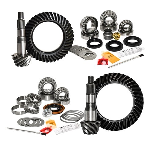

    How does the truck feel with those 4.56 gears on the highway with the 34's?

    They feel good. Gas mileage went up a little for me, so I'm getting around 15 mpg where before I was getting about 14. Feels pretty close to stock but with 34s. If I were doing more technical trails I'd probably go with 4:88s. But I almost never use 4lo when out wheeling, so take that into consideration.

    Nitro for the gears. Eaton Detroit Locker for the rear.

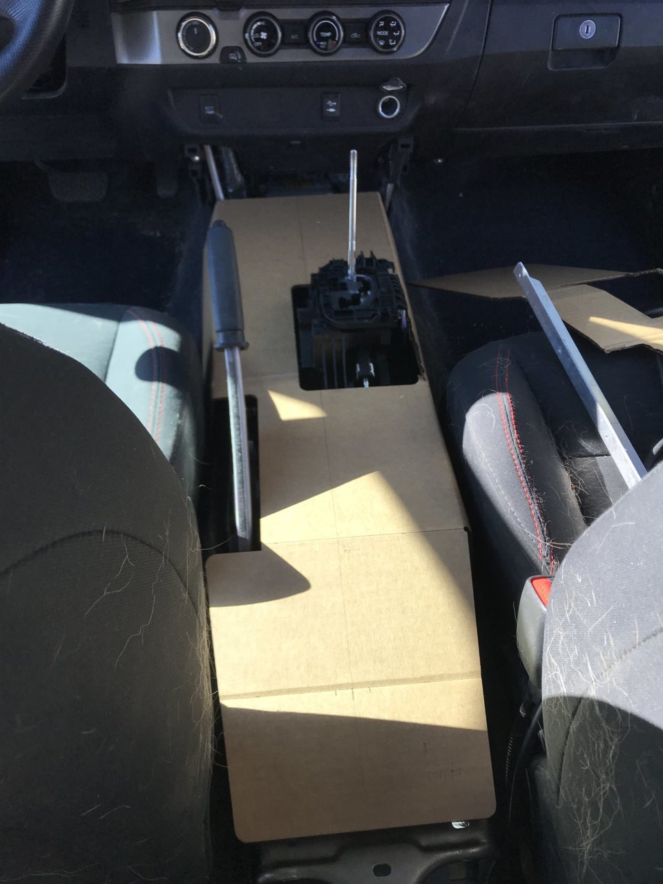

    2017 SR5

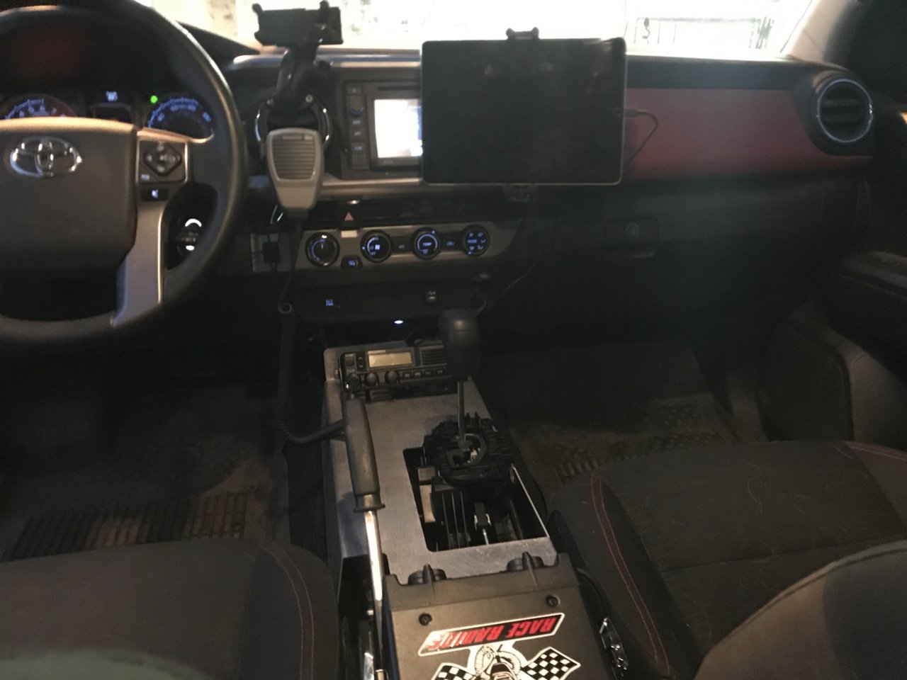

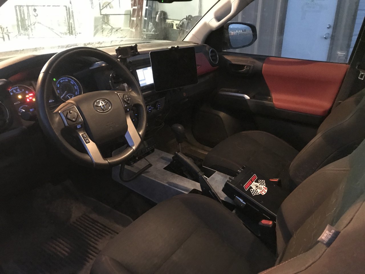

    Spent a few hours mounting the radio yesterday. Started pulling plastic to route wires and decided to just keep it out and make a whole new center console instead. My least favorite thing about modern vehicles is the over-contoured plastic interiors. I prefer simpler lines and metal parts. This is a work in progress but not bad for a couple of hours. Still need to make boots for the brake and shifter and machine a cupholder :)
