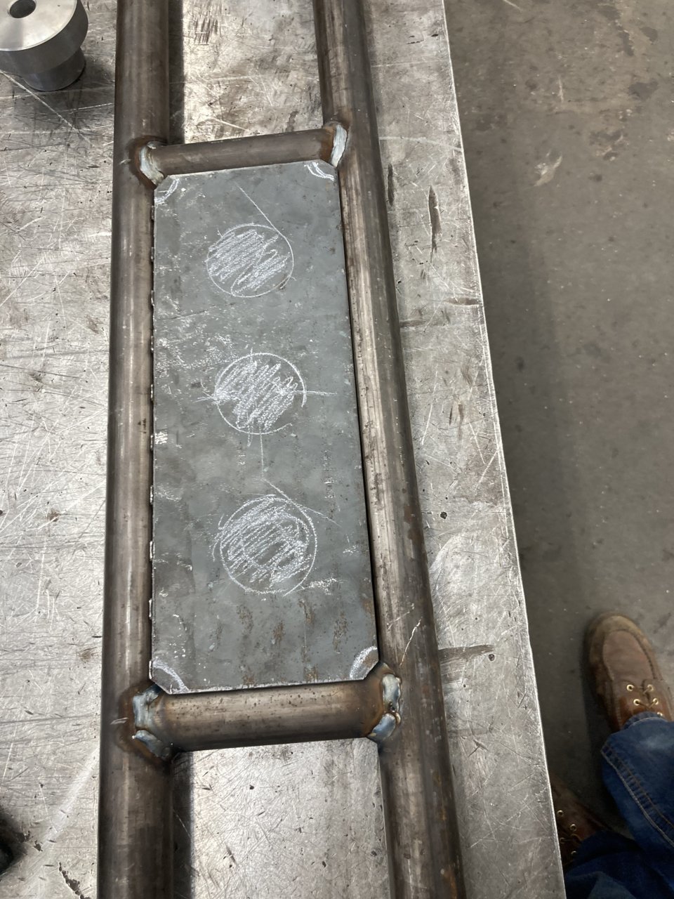

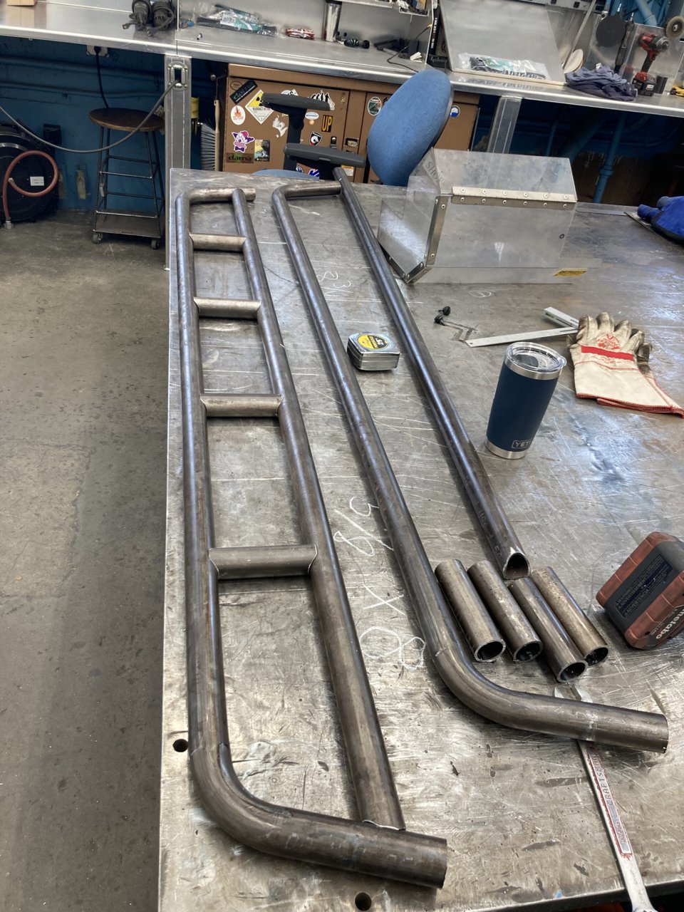

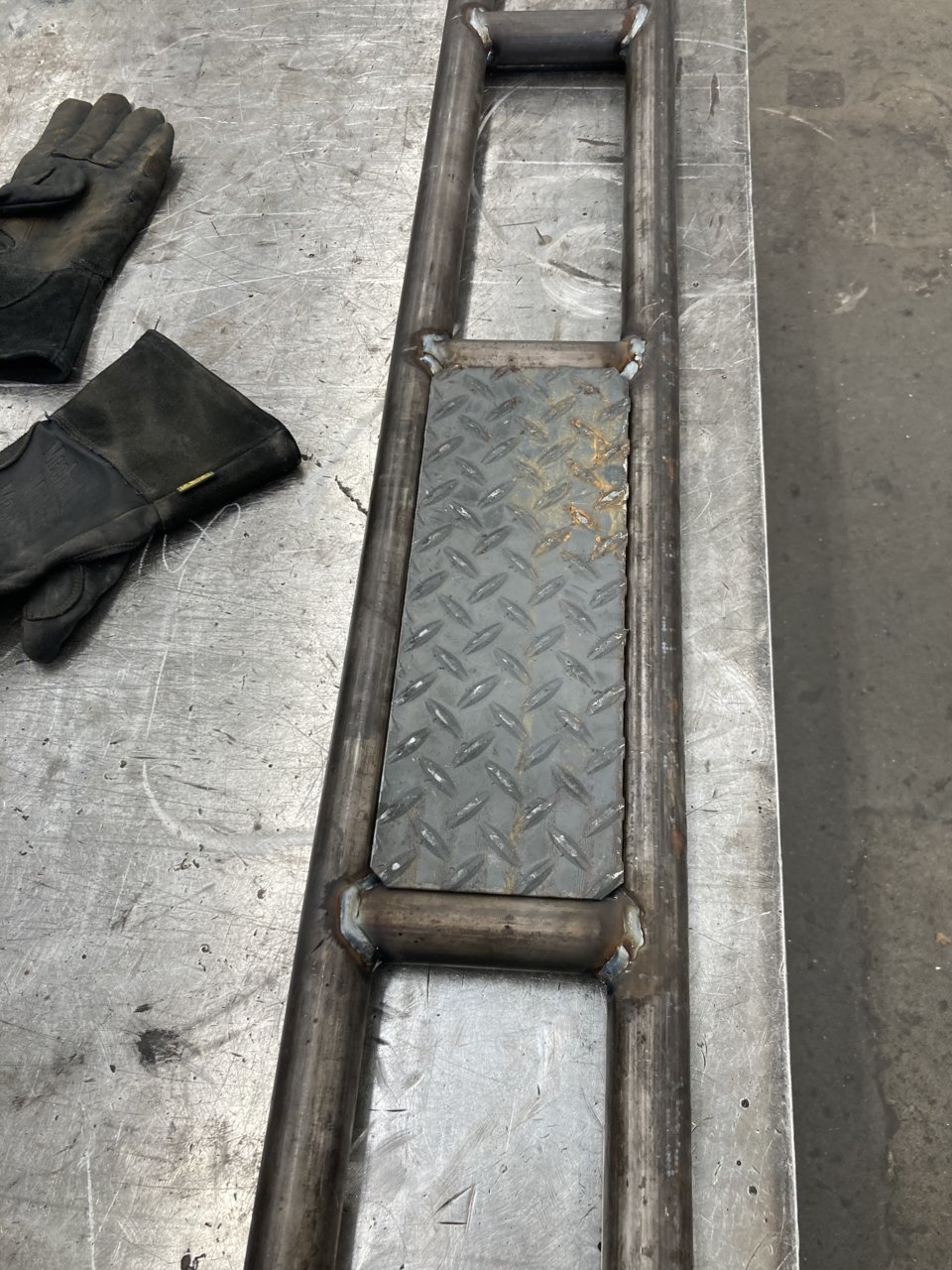

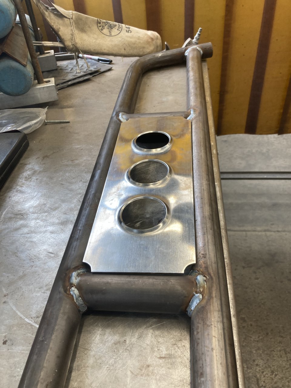

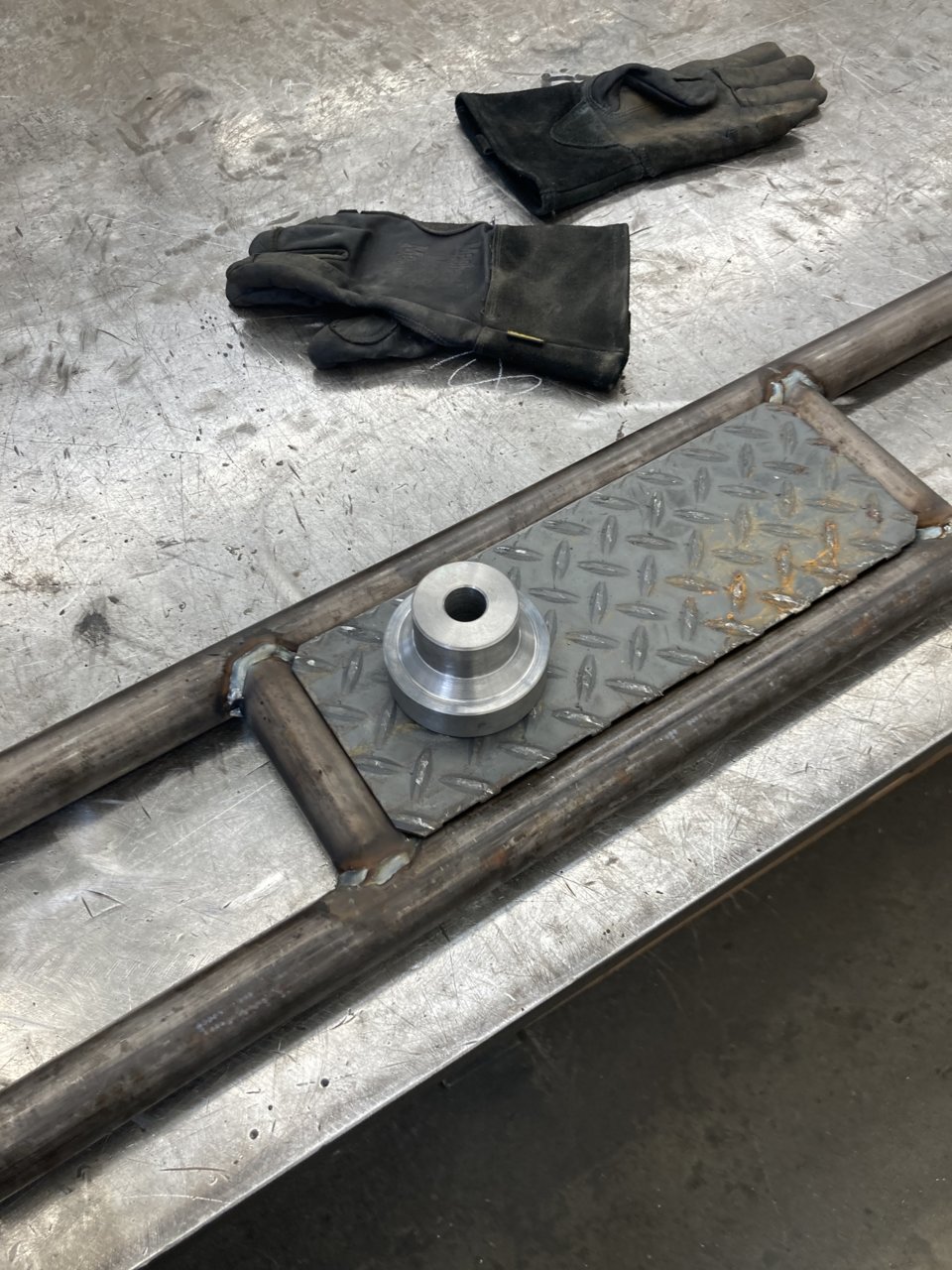

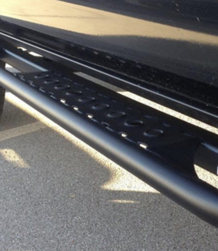

    Trying to decide on the infill pieces. 8A2FE258-B105-426D-9F20-CE40F4585BE1.jpgTread plate or dimple die punched?F1C1FC1E-EF83-4D26-BDA9-77B1B3FAEEF9.jpg02B9AC64-40B3-4B52-BA40-2E0B27B6E8BE.jpg I will cut out a piece tomorrow and actually punch and dimple it. I think dimples would be cleaner less redneck but Raptor coated tread would definitely be a good step when it’s wet.

    My vote for fill plates is smooth metal (not diamond plated) with the dimples, but I'm biased.

    Yes, smooth plate for dimples but I would face them upwards for a bit of extra grip.

    We don't get as much rain as you but with bedliner grip hasn't been an issue for me, even in the snow.

    It’s the spring time rain/pollen mix makes things slick as ice sometimes.

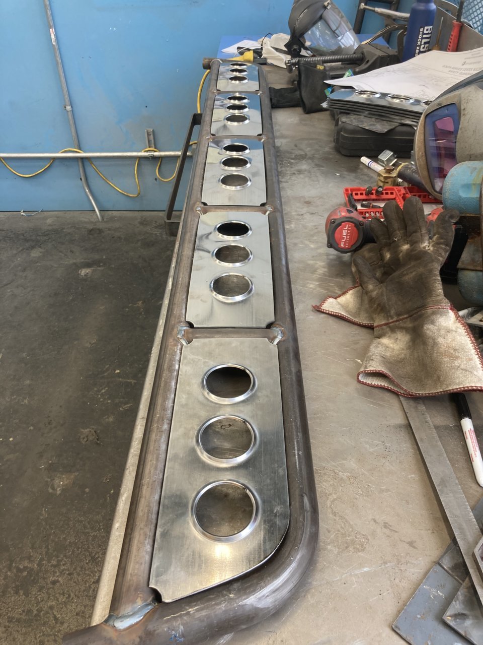

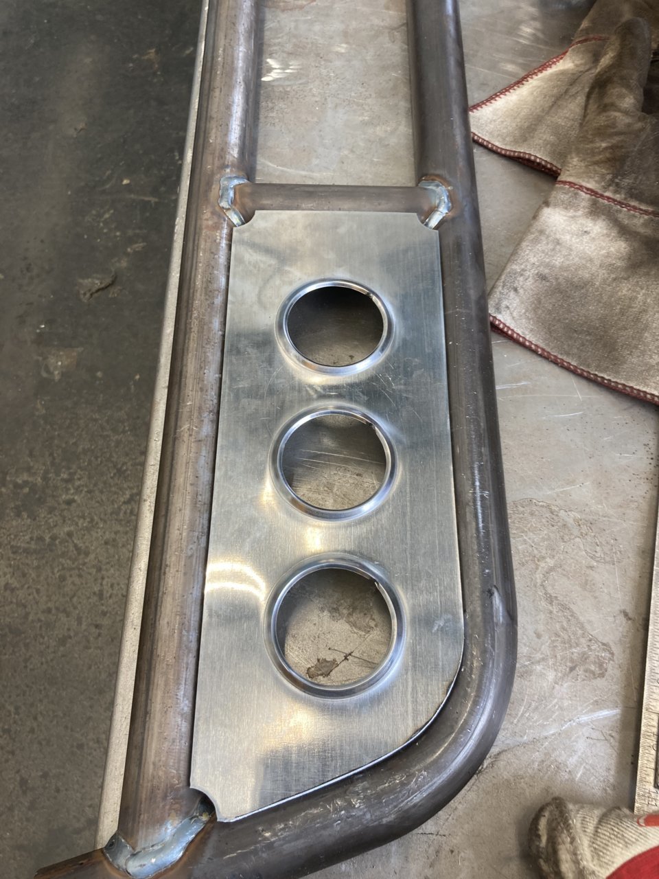

    See if I can get the full plates at least made today. 90EC1372-D333-436C-9A67-999875C7F116.jpg

    Smooth, dimple down, grip tape

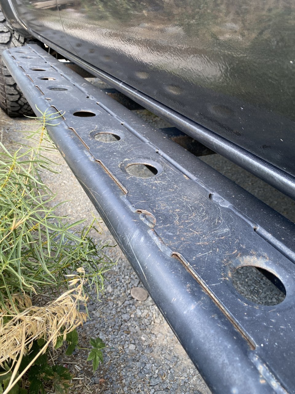

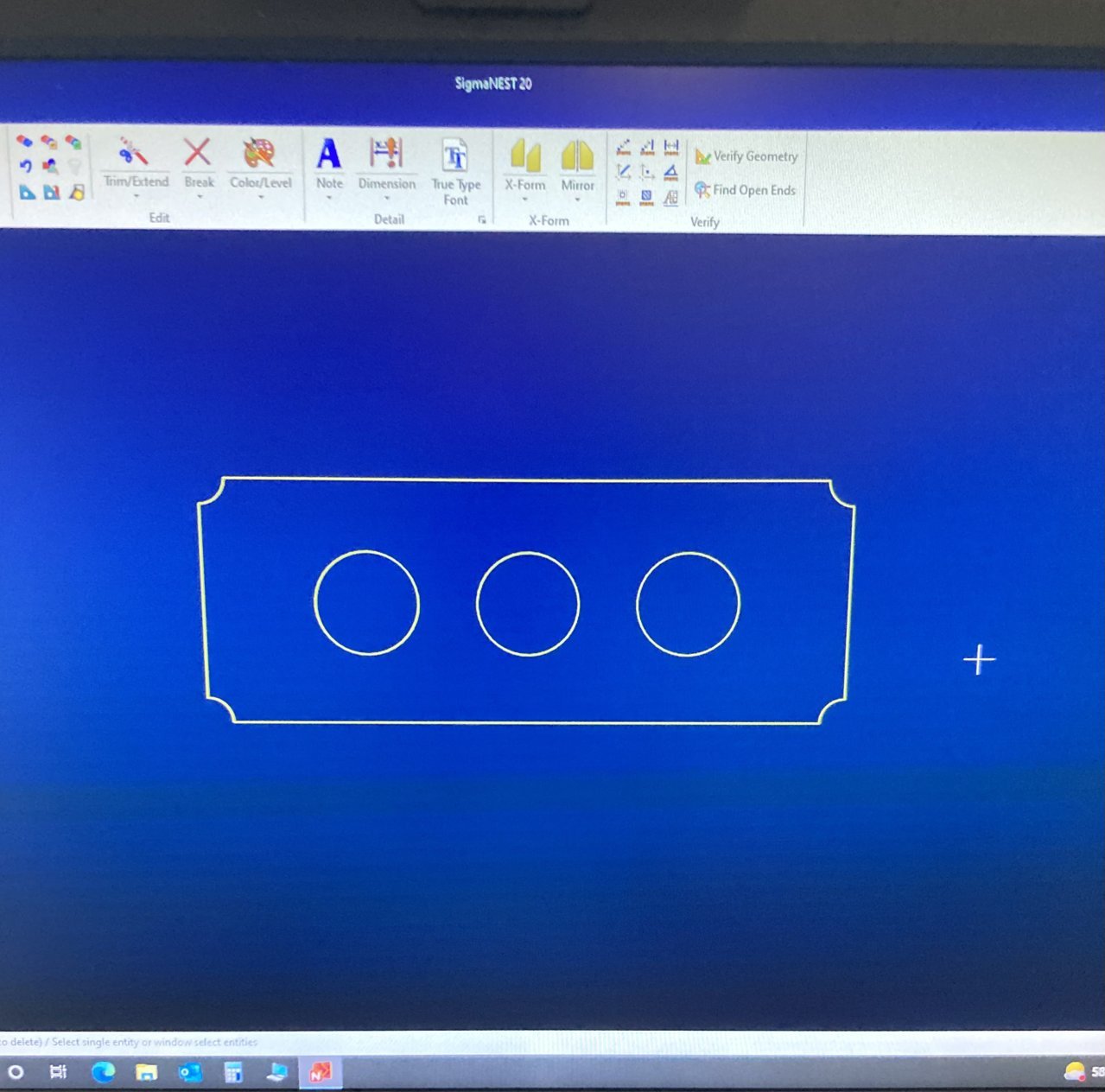

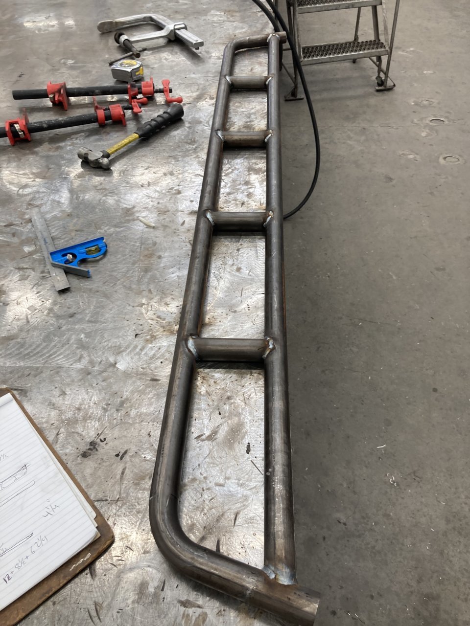

    Dimples out has my vote

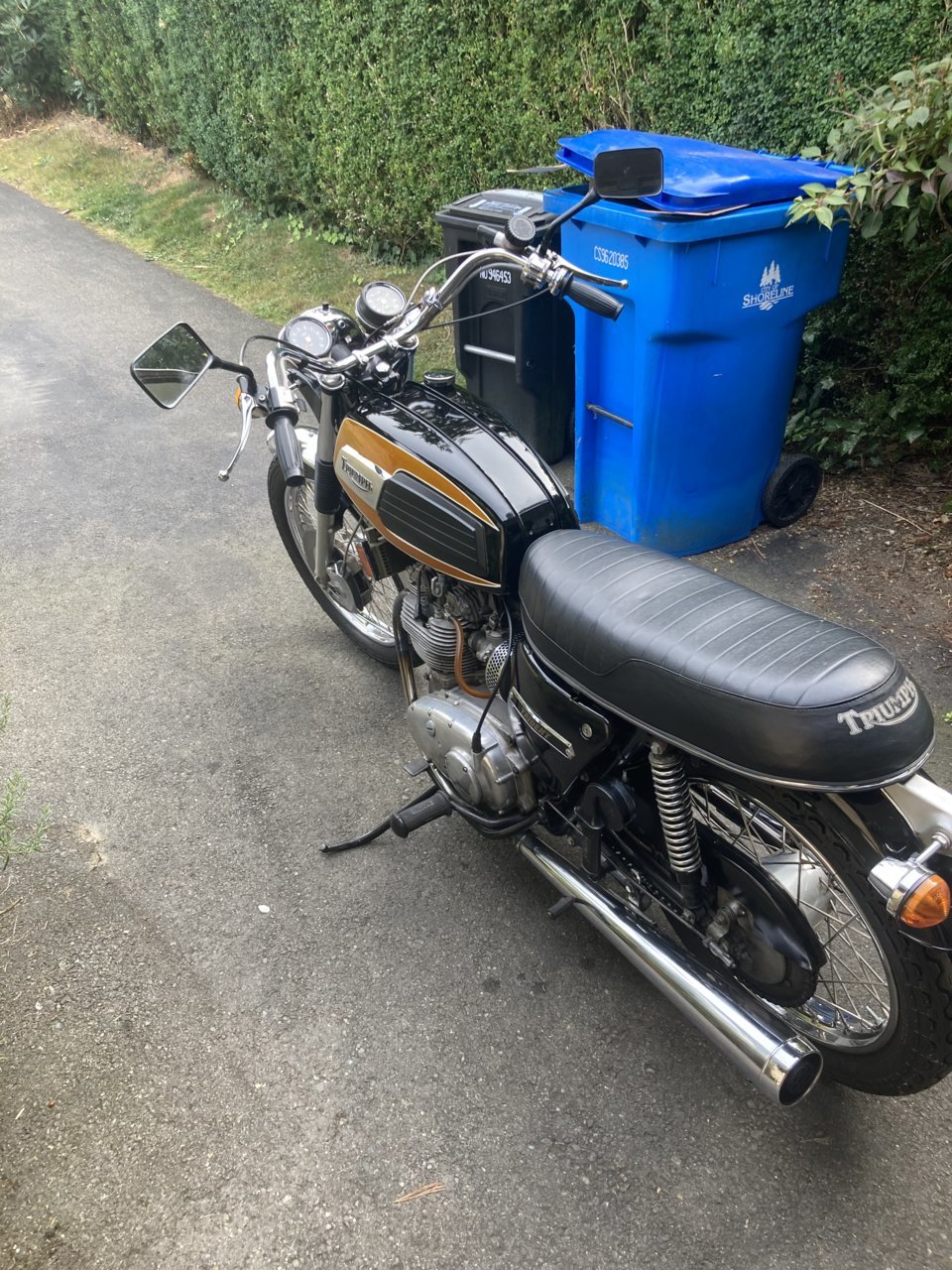

    55C4E460-52FE-421E-A590-3CB67A64A76B.jpg Everything is back together, fuel leak at one of carbs resolved. Currently on the charger. Cross your fingers!!!!!!!
