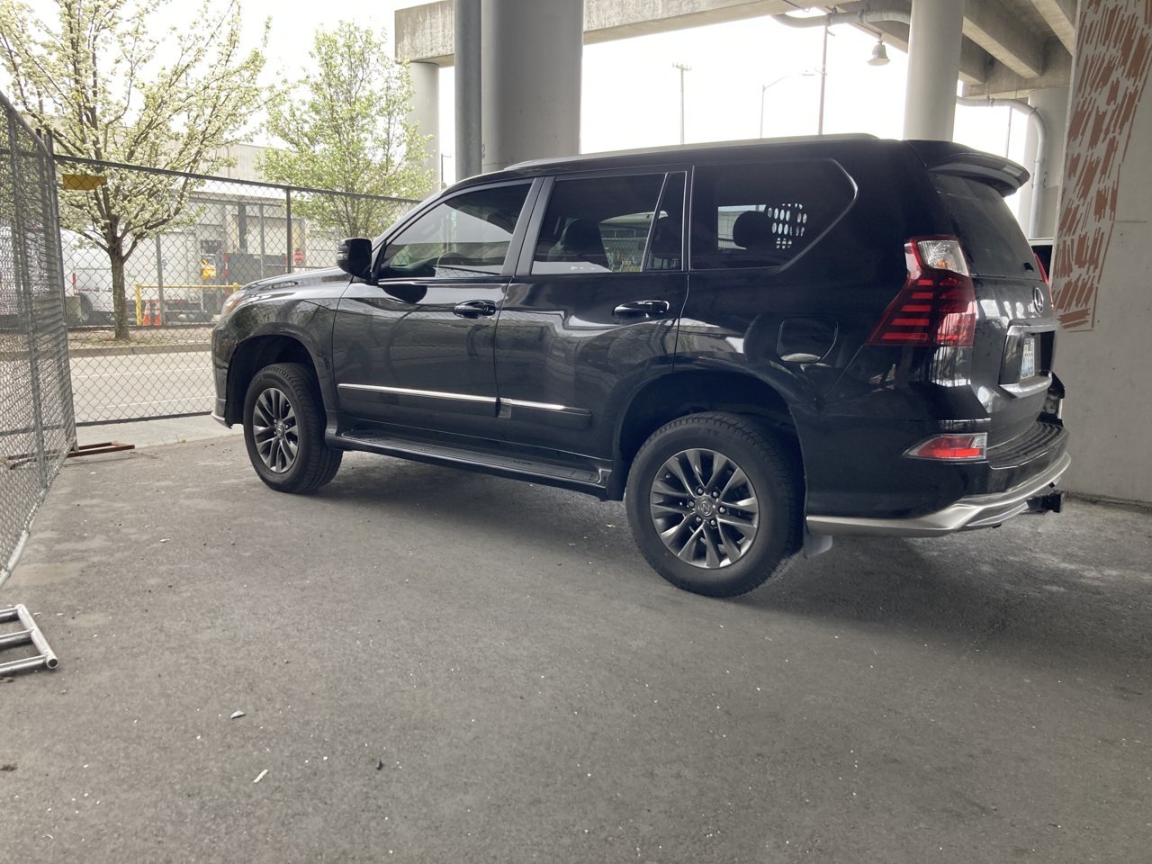

    It ended up totally level. I was looking to get a bit of rake. Oh well. The Bilstein rear springs feel a bit stiffer so it should help. DED9F1B9-7E11-4C47-8DFA-F3C99892ADD3.jpgDiscount should have my wheels and tire in by the 7th, so hopefully get them installed on the 9th. It goes in for alignment tomorrow morning.

    looks good!

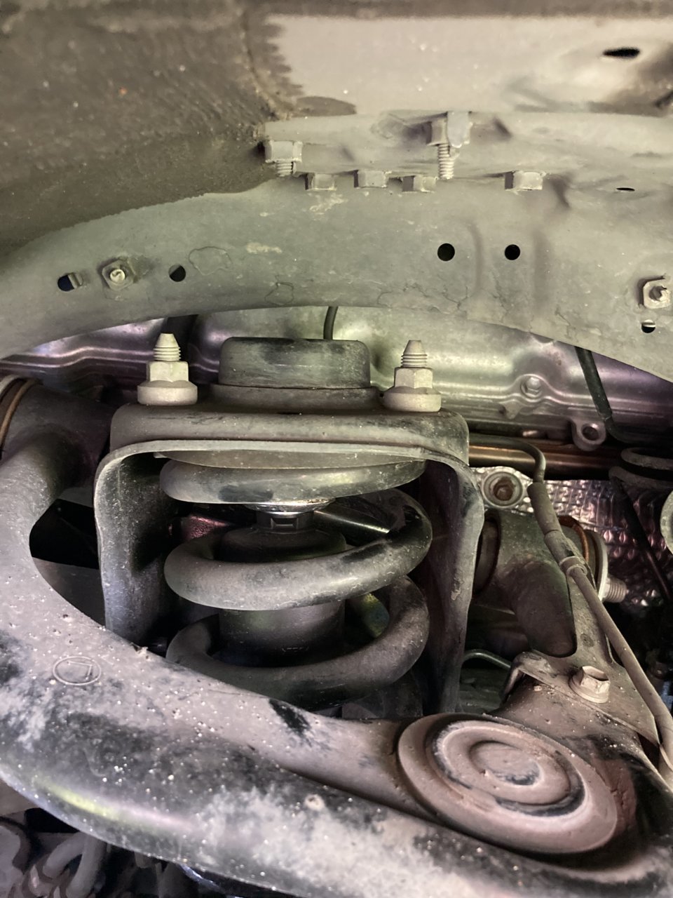

    Well, lesson learned. When you install suspension bits late at night be sure to double check your work sooner rather than later. :mad:o_O:thumbsup:226278F3-B77B-4E29-85AF-7ECE2EDBF00F.jpgNew top mount set up is on its way to replace missing bush and washer. I had a nut in toolbox drawer.

    Oof. Nothing broken though right?

    Amazingly enough nothing got damaged. It’s all fixed as of yesterday afternoon.

    :thumbsup: Nice! Did it fall off while driving? That's nuts! :rimshot:

    Yep, made a horrible noise.

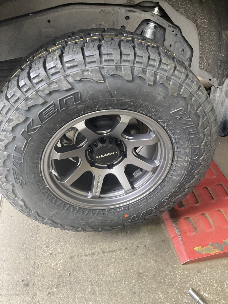

    756D24E1-35A6-4A54-8DEB-35B98406C1D4.jpg Daddy like!

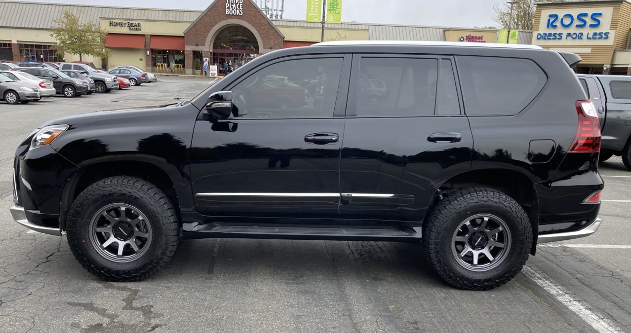

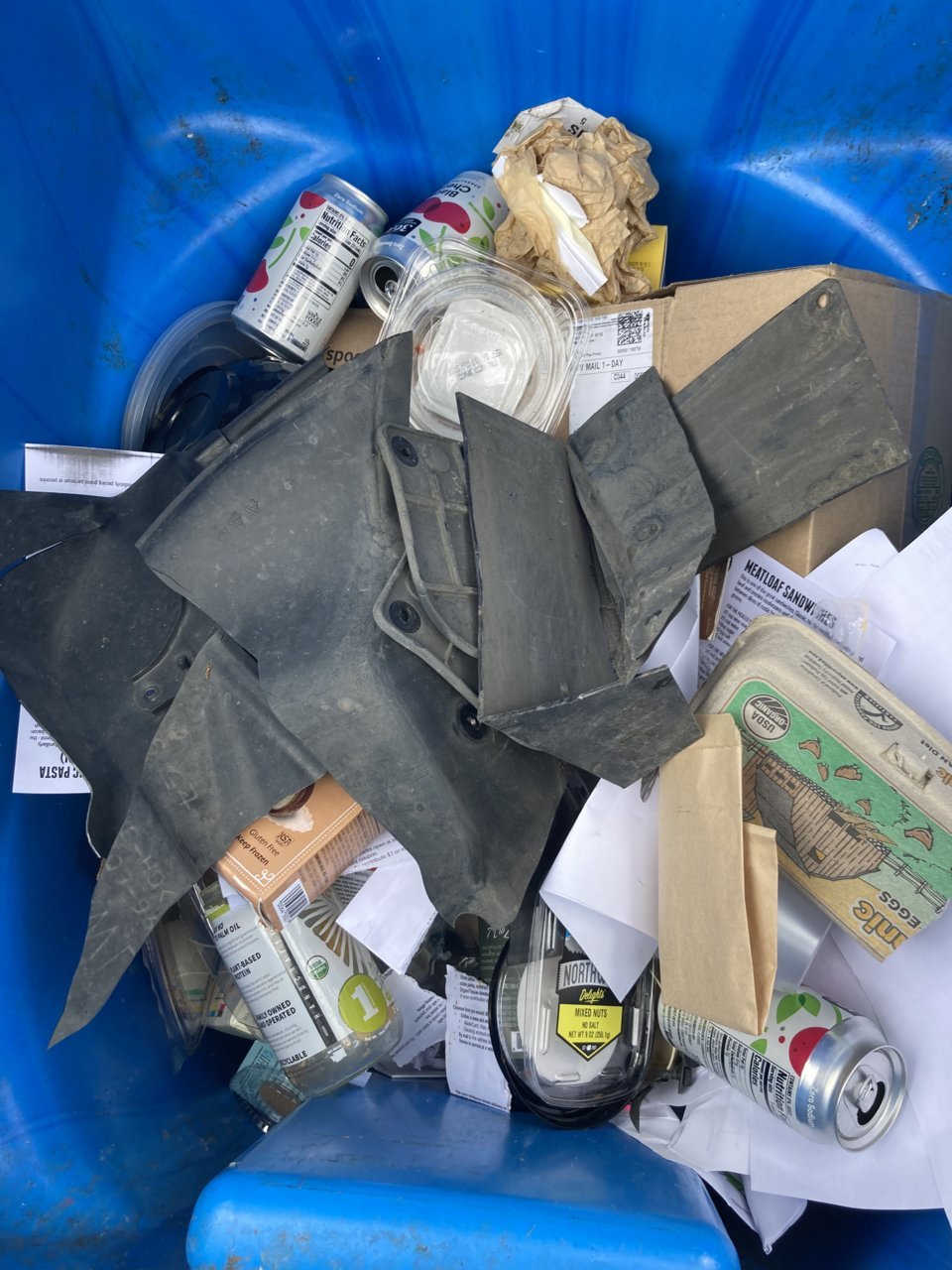

    Lots of plastic trimming done. 3FBE2696-98C7-4329-BD7B-95E3235CAB82.jpgTires just barely kiss the cab mount. It’s going in for service and alignment on Friday. Hopefully they can add a bit more caster, otherwise it’s :sawzall:time for CMC.

    You had a Vision and made it happen! :rimshot:

    Tires look great
    Is your lower shock bushing washer on upside-down? (if not built into the shock) It should be facing up like a cup.

    I’ll have to look at that this morning.

    truck looks good!
