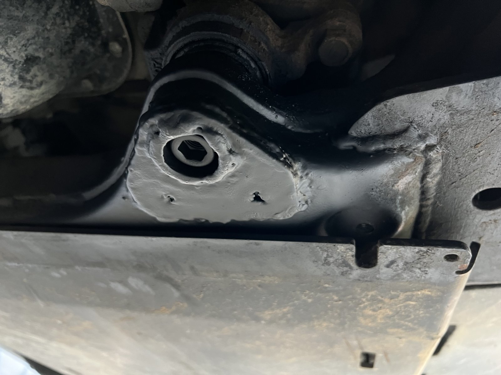

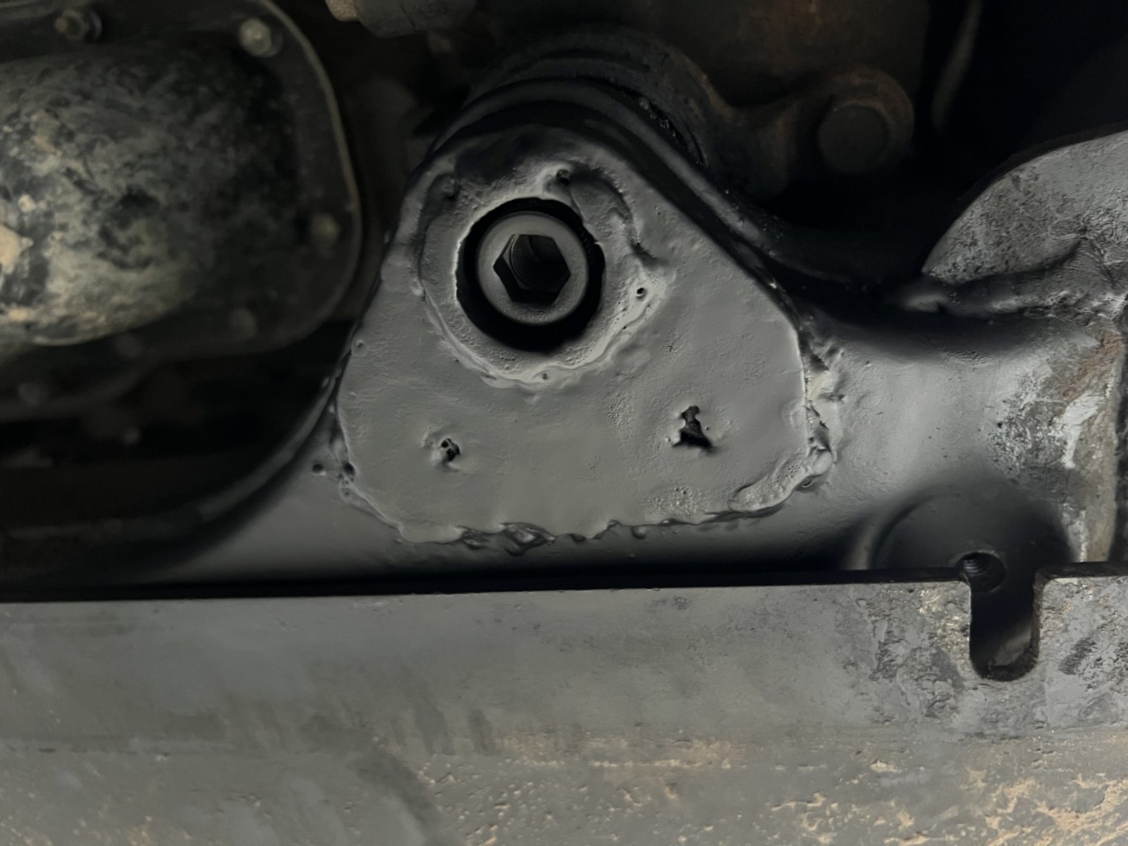

    It could be something else. Is it a click or a clunk? I resolved my clicking noise with the 4Runner bolts, but then I had a clunk that would periodically happen. Couldn’t track it down for the past 20k. It would happen going over larger bumps/potholes or it was very apparent while off-road. I finally figured it out after I dropped my engine skid plate and took a crowbar to under my front diff. The rear bolt on the diff was moving within the frame mount. The diff is mounted to a thin piece of metal and I guess it ovalized with all the off-road I’ve done. I ended up installing in the Welds Taco front diff reinforcement kit. It’s a plate and tube that gets welded inside the frame mount :welder:I have put 10k on since the install and can happily say my truck is silent free. It’s as quiet as a mouse now :woot: the welding is not pretty but it’s solid. I do have to admit welding upside down is very difficult! I hope this helps out a few people!!!!

    I am thinking it is more of a clicking, but I will definitely take a look at the diff mount. That kit looks awesome, thank you for the heads up!!
