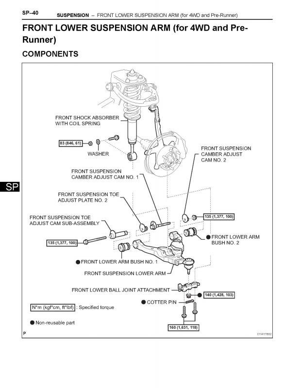

    What is your lower strut bolt torqued to? I set mine at 103ft/lbs

    Stock spec was like 62 or close to that, so I went with that. I may up it to more around 100 though. The bolt is rather large, I'm sure it could easily handle a lot more than 62.

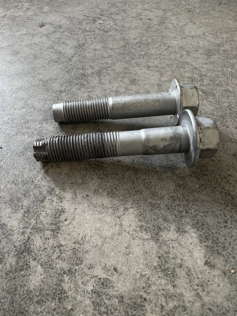

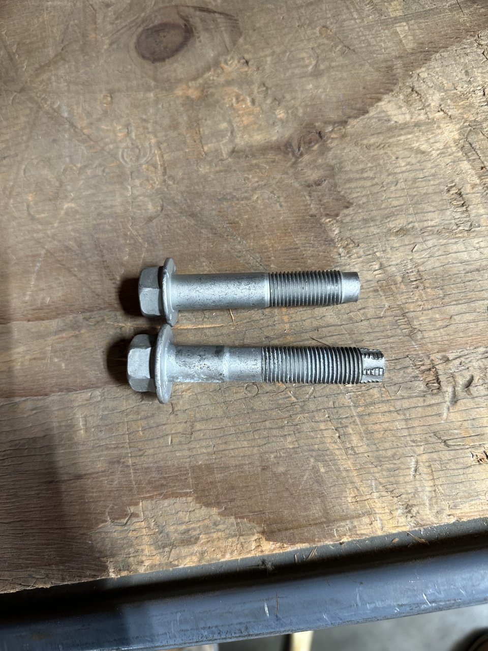

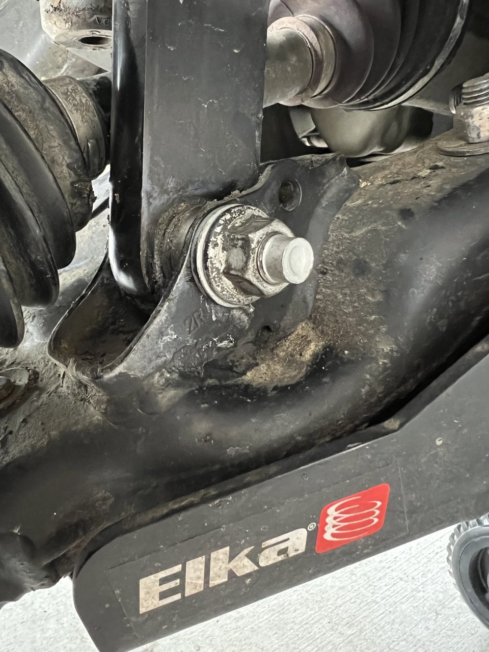

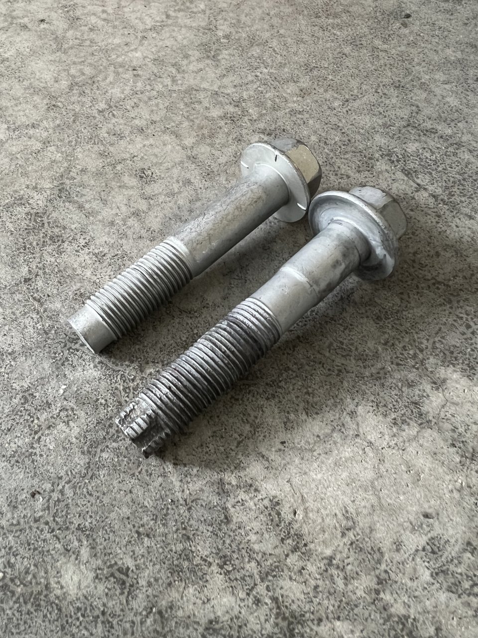

    Out with the old, in with the new! Very thankful to have come across this post. Been chasing a clicking sound for years and could never figure it out. I have Elka suspension with sway bar delete. Always thought it was the LCA bolts. Replaced the lower coilover bolt with the 4Runner bolt and I can happily say I have no more noise. Toyota really screwed up on this. Huge design flaw. Hoping this new bolt extends the life of my spherical bearings as the last set only lasted 20k

    Thank you guys! Finally fixed the click I would get whenever coming into a drive way and turning to park. Easy fix just use a floor Jack to help you lower the LCA a bit once the strut is decompressed the bolt is easy to slide in and out! Image posted for torque reference! Did this small fix three weeks ago no clicks yet!

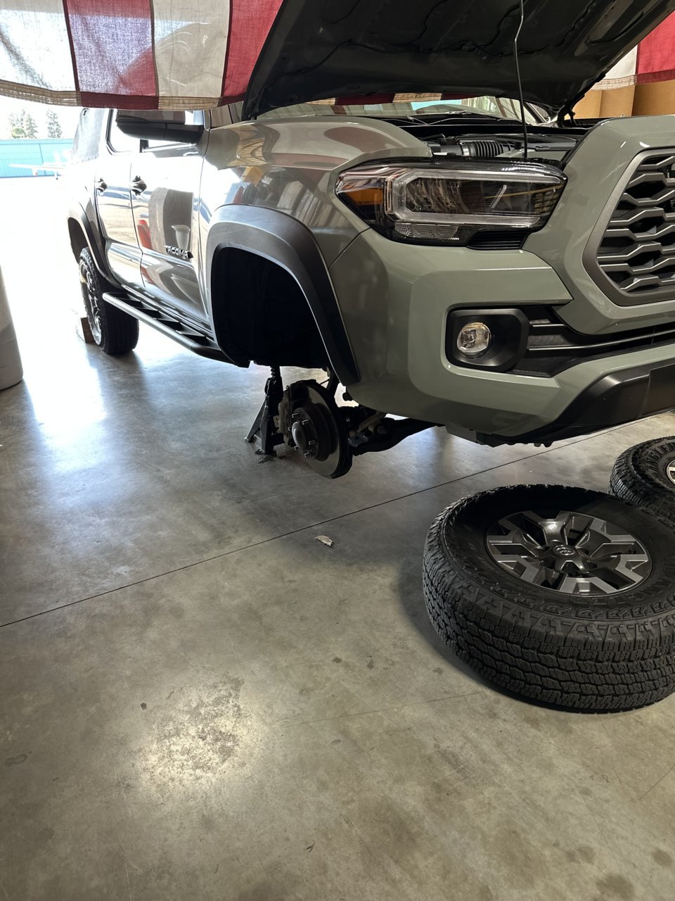

    Well... I jacked up the truck, had a buddy push down on the tire, slid the bolt out...
    And I discovered that the Toyota dealer ordered me the wrong bolts. Shit. Can't return them because I bought them 2 states away and shipping them back would cost as much as I paid. So... parts bin... for some reason... they go. They are Gen 2 LCA bolts. I'll call the local Toyota tomorrow and order the correct ones... again.
