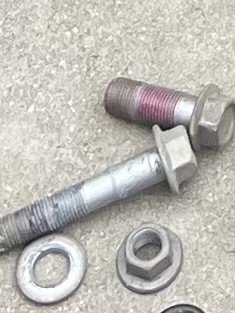

    Big thanks to Tony for the recommendation AND the time to help another member out. Good fella there.

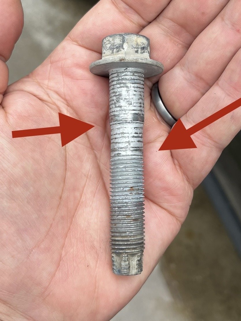

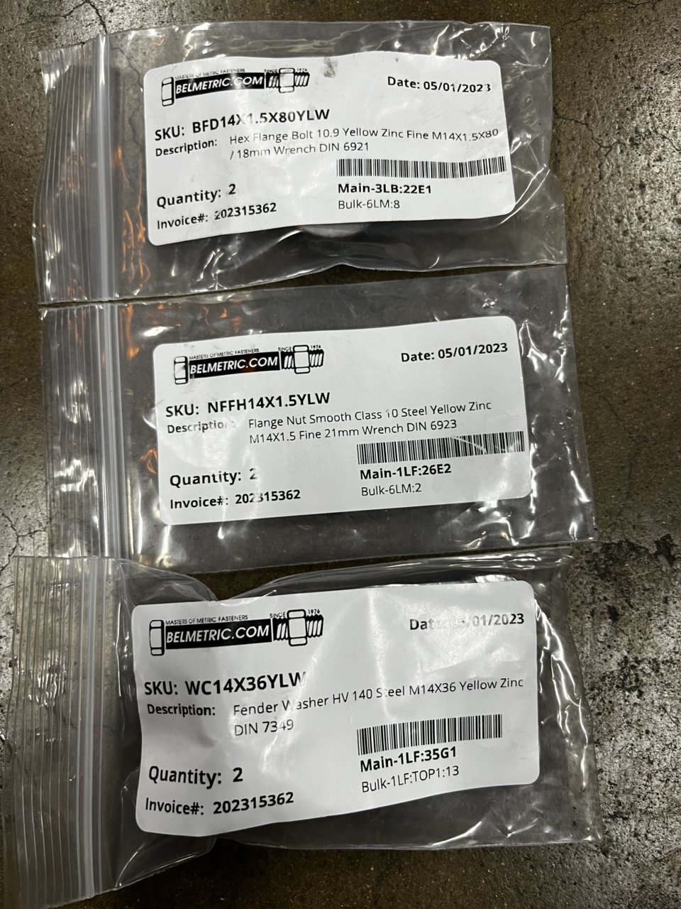

    Using his advice, I swapped out the bottom bolts for the coilovers. Toyota messed up on this design. That short shoulder is not helping to spread the load.
    Info for hardware is on @tonered ’s build thread.(3rd Gen. Builds) I can’t recall which member took the time to find the info. THANK YOU.

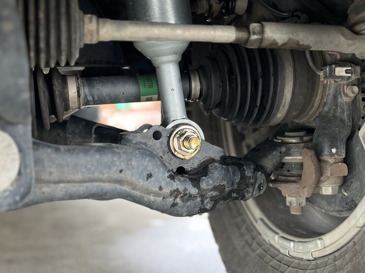

    The second picture was prior to installing the Bilsteins. The click went away when I swapped to new coilovers/bushings. So the Bilsteins were rubbing the OEM bolts the wrong way. But like the OEM hitachi’s, they were heading for an early failure.
    But now with a longer shoulder to help support the sleeve, the bushing has a chance at normal wear and tear.

    2019 TACOMA SR V6 SC , 4X4, AUTO, 4.88, 265/75 r16
    i ordered the hardware so ill see if that fixes my click, similar to yours. Also have 6112's
