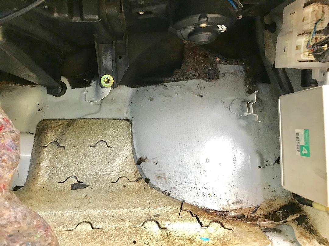

    Thanks mikkydee! It is raining here today so I pulled the carpet back and it's easy to see that the water is coming in along the corner and behind a black plastic box. (See pictures) The insulation just to the right of that shiny bolt in the upper center of the picture behind the plastic was absolutely soaked just after a little rain. Any other ideas on chasing this leak down? Thank you! Hunter

    That's your blower motor to AC evaporator part of your HVAC - you could check around where the AC and heater core lines pass into the cab before taking body panels off.

    Did you follow the TSB yet?

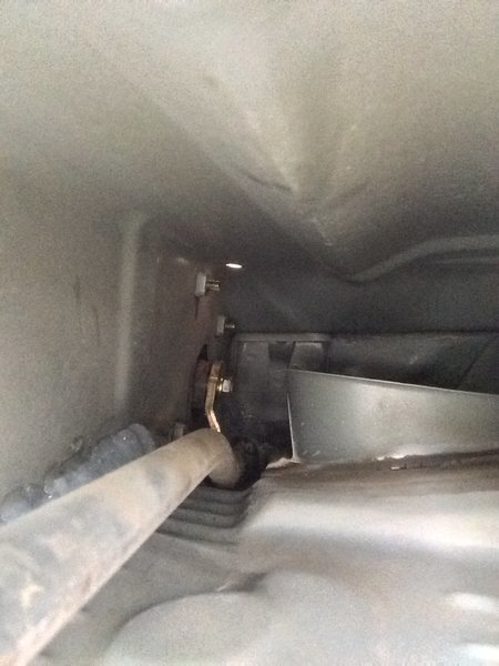

    It's most likely your leak comes from either the seam in front of the wiper arm or around the vent tube. In this pic above, you can see a bead of caulk has been applied to the front seam in front of the wiper arm but not around the protruding vent tube where you can also see the factory sealant is cracked if you look closely. Many were able to fix their leak by caulking the front seam in front of the wiper arm all the way across the vehicle. However that did not fix my leak. I had to also caulk around the vent tube which is the metal piece you see on the right hand side of the pic sticking upward. as mentioned, if you look closely you can see the sealant is cracked where the tube comes up through the bulkhead. It is difficult to tell from the pic but that protruding vent tube actually is round and completely hollow so be sure to get your caulk all the way around it if you can.

    Good luck man! If you're going to get tubing make sure it's 5/8 or bigger and don't forget wire!
