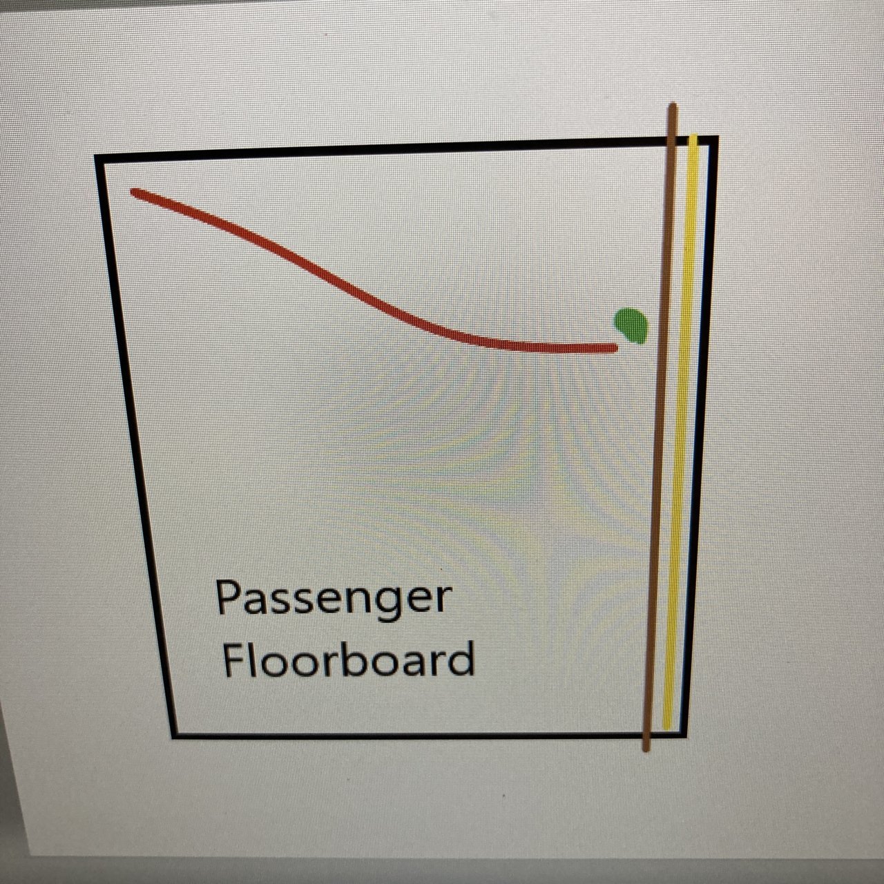

    same here. Except I’m thinking of trying to just re-route the water that drips down, into a drain hole of some sort. Something like this:
    red-thick caulk bead
    Green- drain hole
    Brown- plastic separator
    Yellow- wires from car
    Not sure how realistic this “solution” is, but I’m hoping someone else on here either agrees or disagrees with how effective it might be. I’d just rather do this than disassemble the fender, and all that other stuff.

    The caulk beads under the carpet? If you waterproof the underside of the carpet there, thats one way of keeping it from pooling on the floor at least...
    I just called my local Toyota service center and told them about the TSB, he said its a $99 diagnosis fee up front, before the cost of the actual repair... He said it seemed like a hefty job. Weird, seems like this would be a relatively easy thing for a service center to do. Guess its worth DIYing it afterall.

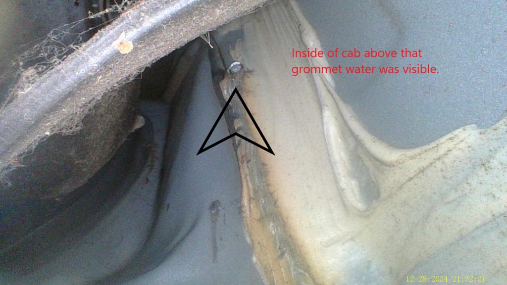

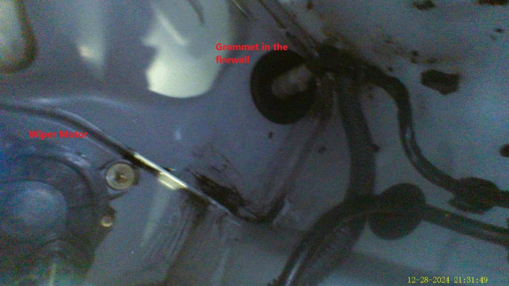

  19. Dec 28, 2024 at 8:30 PM
    #79
    Cory2002SR5
    Cory2002SR5 Member
    Jun 18, 2023
    #427074
    10
    Pic 1 on firewall.png Pic 5 water in cab.png Welp, I am in the same boat. 2002 Tacoma Prerunner. I going to clean up the sealant then use clear flex seal with an extention tube in the spots I can reach. Also use seam sealer on the spots that I can get to. I found it dripping above the rubber grommet that goes into the firewall right below the wiper motor. It is not terrible but I know it will get worse. I will go by the TSB BO026-00 as best I can.
