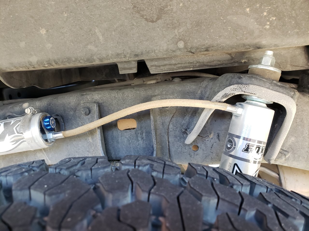

    Just finished installing these on my 2019. Is it normal to be able to grab the shock body and spin it by hand? It's not terribly easy, but it spins. I'm worried about the reservoir spinning a bit after a long day in the desert, and possibly colliding with the leaf springs. I've got the 19mm top bolt (supplied from fox) pretty tight, too tight maybe. I've got about 5 threads showing. Any help is appreciated!

    They definitely spin if you twist them hard enough. I went with the frame reservoir mounts that pretty much prevent them from spinning and placed some automotive edge trim around the sharp edge of the upper shock mount just in case.

    that looks great what did you use to mount the reservoir?
