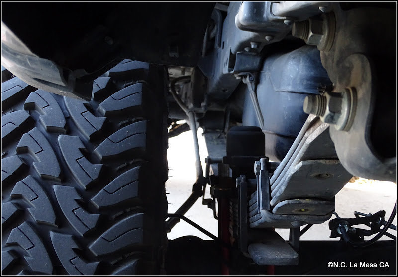

    Not sure if automatics have them, but me and @EatSleepTacos are manual so we have parking brake lines going to the rear brakes

    I'd probably disconnect it from the leafs themselves so there's a straighter line. Here's what I'm talking about (how they look now)

    It'd be easy. It's just one 10mm bolt to undo it, then just slide the bracket out of the way with a zip tie.

    I have a parking brake too. I imagine it works the same way as your manuals. Cable driven to engage the rear drums
    Although this is all based on assumptions for the Tacoma from other vehicles I've owned.

    I'm fairly certain you have the same thing. I've installed lifts on a couple automatic tacomas, and they have the same cable there now that I think about it

    I would think so, we don't have different breaks so I don't imagine the e brake would be any different
