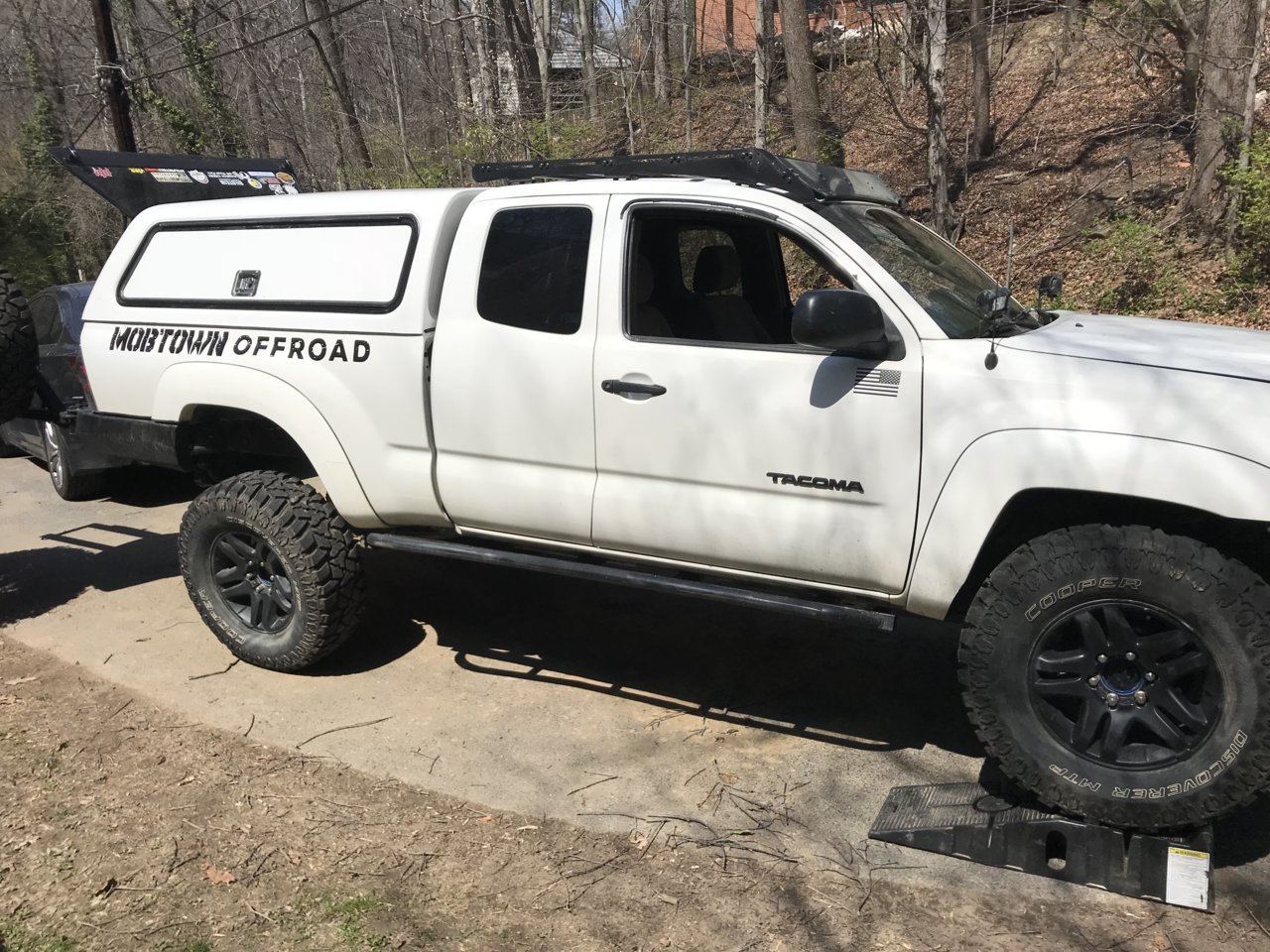

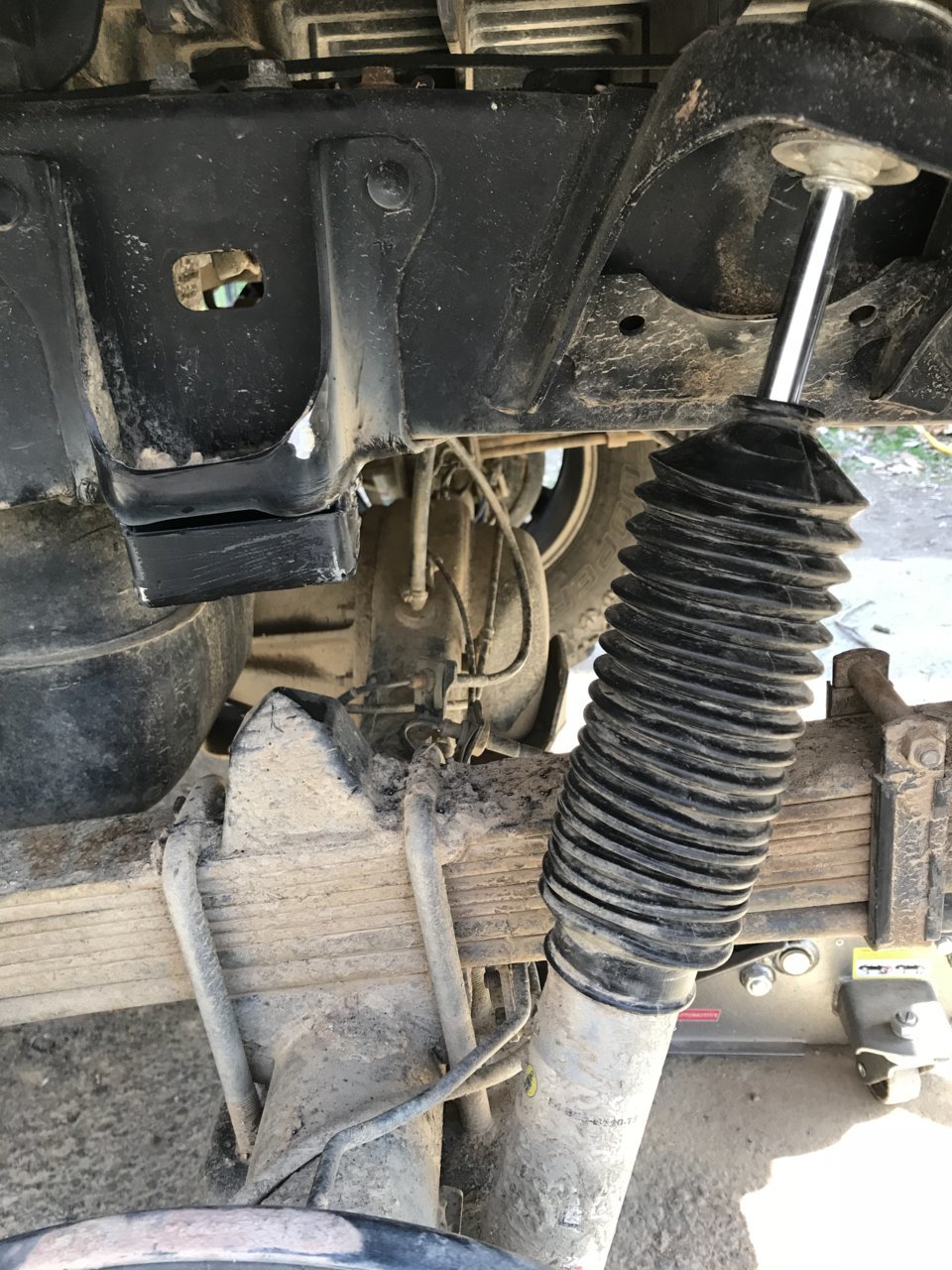

    Spacing out my rear bumps today. Put a ramp on each corner and got a surprising amount of flex. Turns out I only need to limit uptravel by 3/4” or so, but I’m gonna do 1” to be safe.

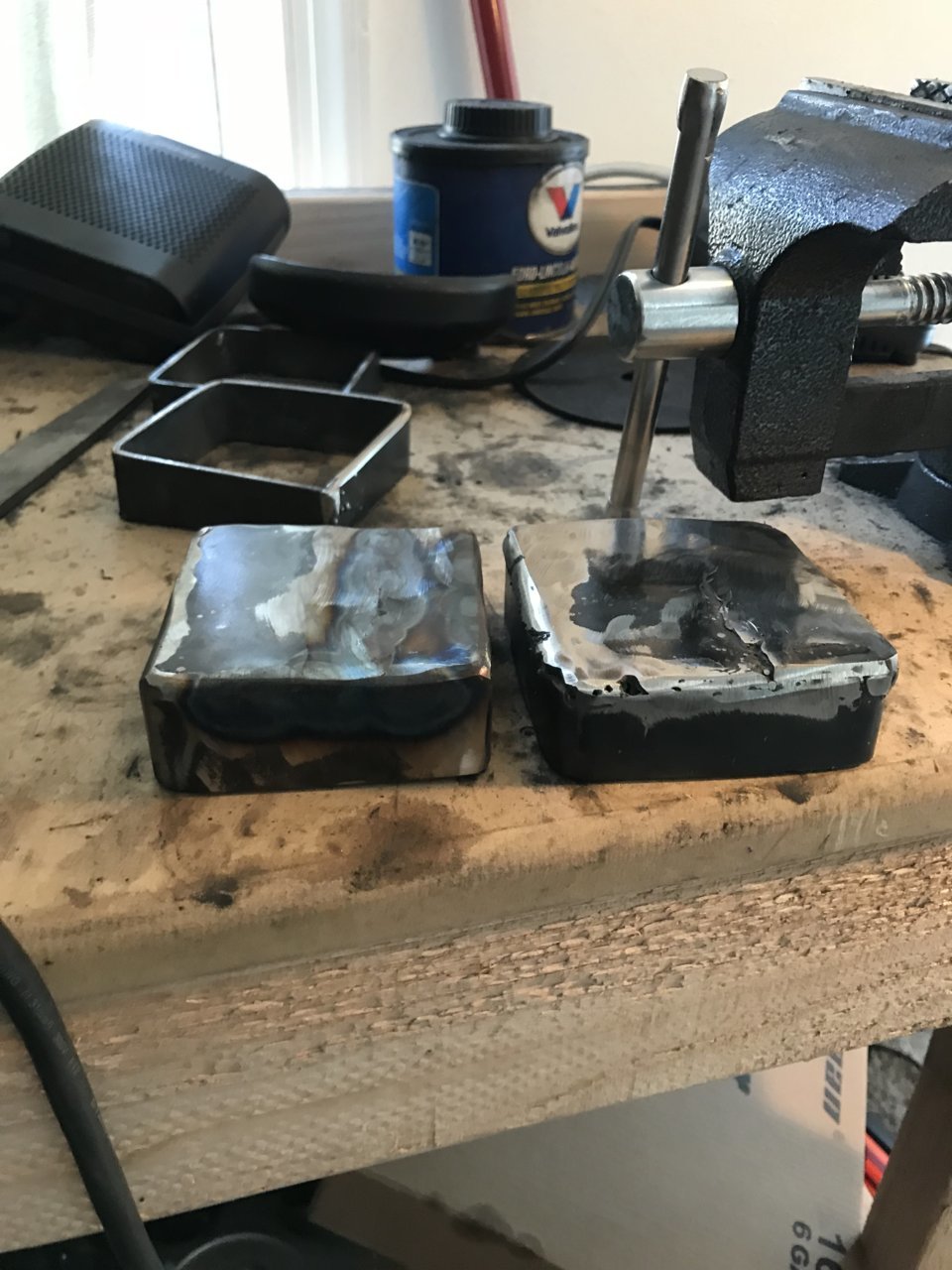

    Welded on some ugly, yet effective, 1” bump stop spacers. Measured it out and I’ll have 1” of shock left when bumps start, and I guess they’ll compress 1/4”. So leaving 3/4” as a just in case.
