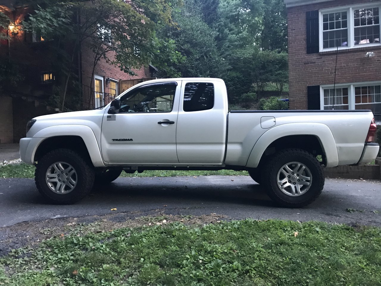

    This is the lift I posted above. Tires are 255/80r17 (33” diameter)

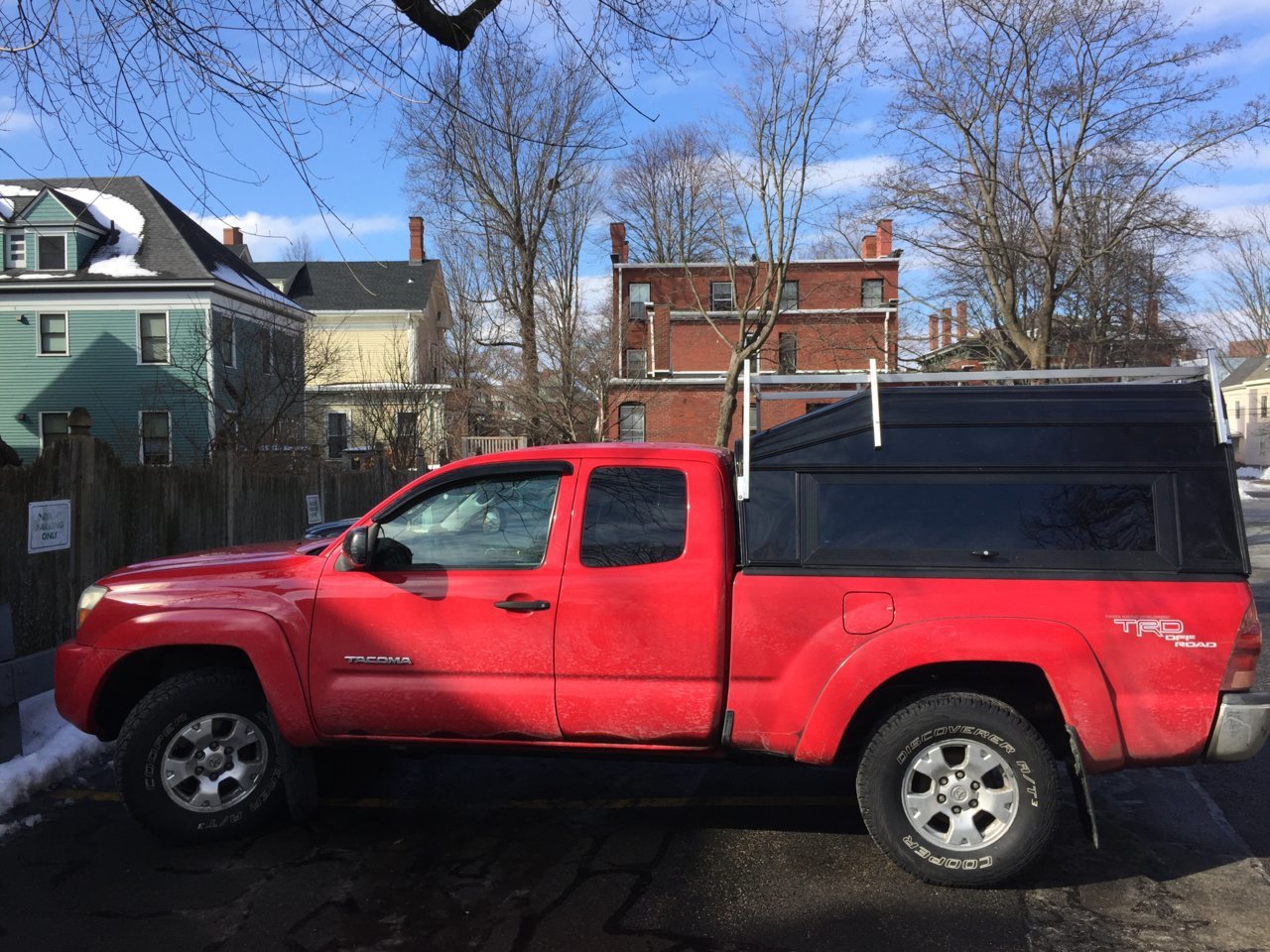

    that is perfect! how much would this all run me roughly? also, u think this would look okay if i continued to run my 265/70r/16?
    0569B8B7-AE6C-4340-B7BF-D119E5A6CE45.jpg im afraid theyll be too small. maybe not though?

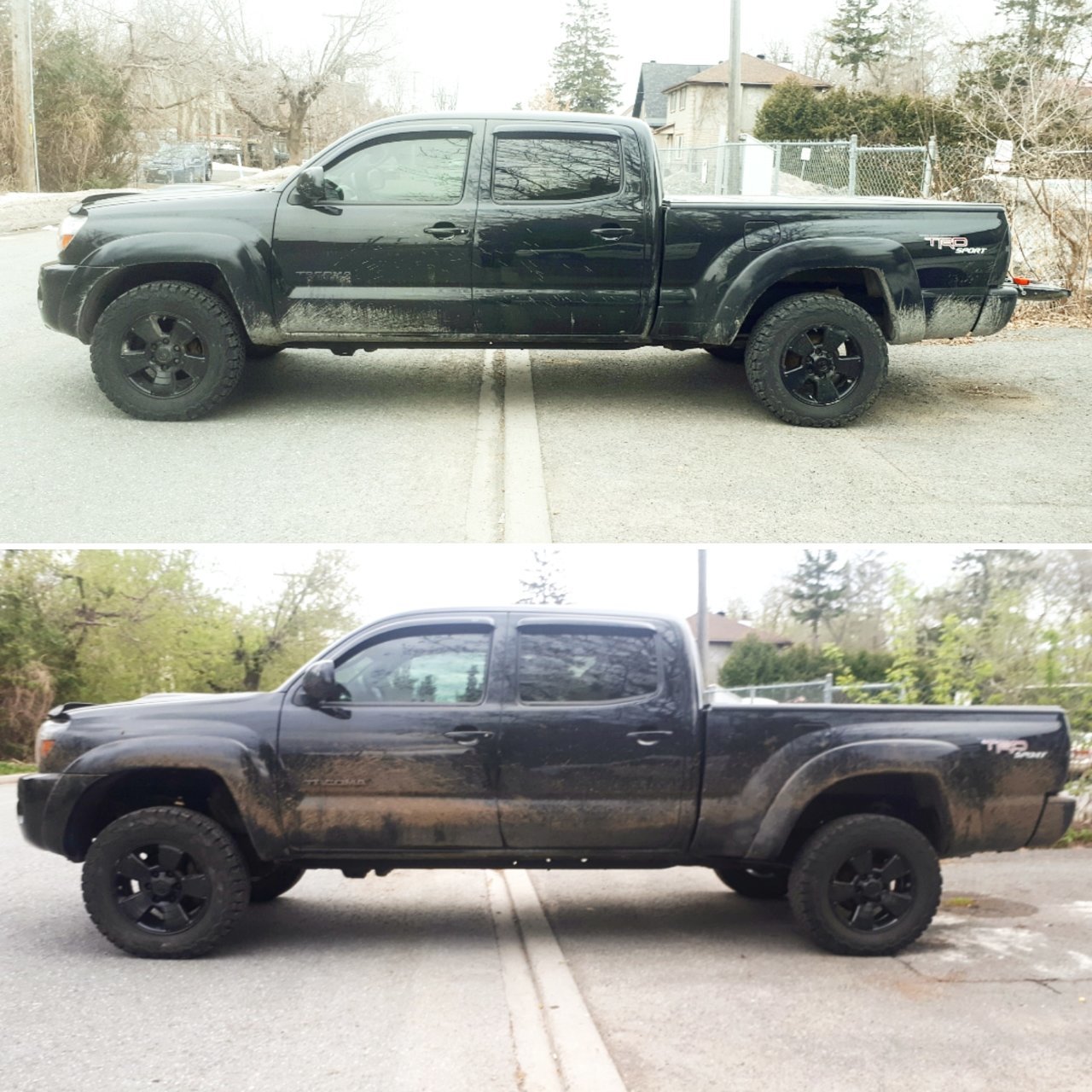

    @emmett
    5100 set at 0 - with OME 887
    5100 with 3 Leaf AAL
    Stock Tires SIZE (265/62/17), for reference to see what it looks like
    keep in mind, the suspension had settled down a bit and this was right after finishing up the install.
    Before and After:
    Slashaar, RobP62 and emmett like this.

    They'll look a little small. By the way that cap on the back I would look into possibly a little bit heavier AAL or getting the 4+1 recall springs if you haven't had that recall done yet that'll help a bit.
