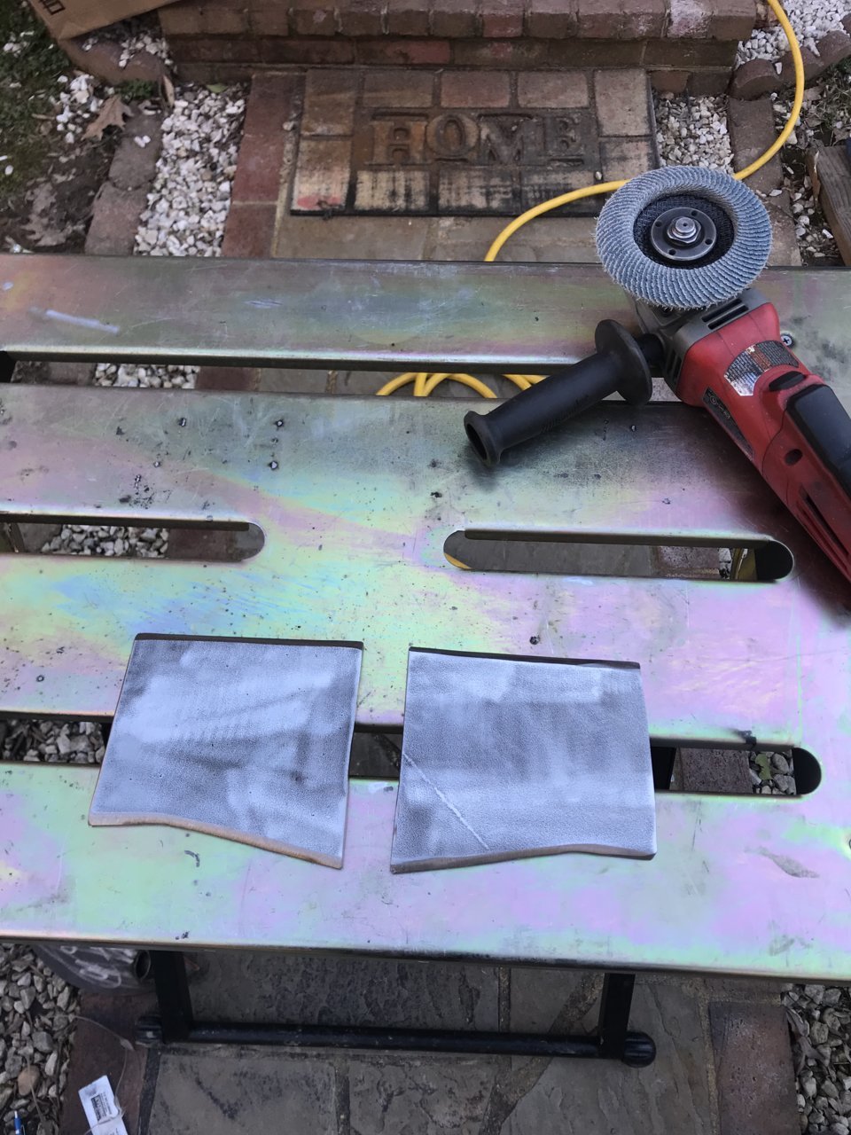

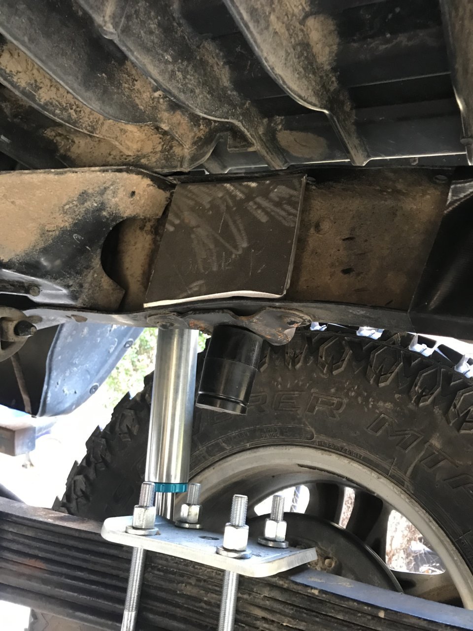

    Cut out the frame plates for the limit straps. There will be a plate on each side, and square tube running between the two. That’s what the adjustable Clevis mount for the straps will mount to.
